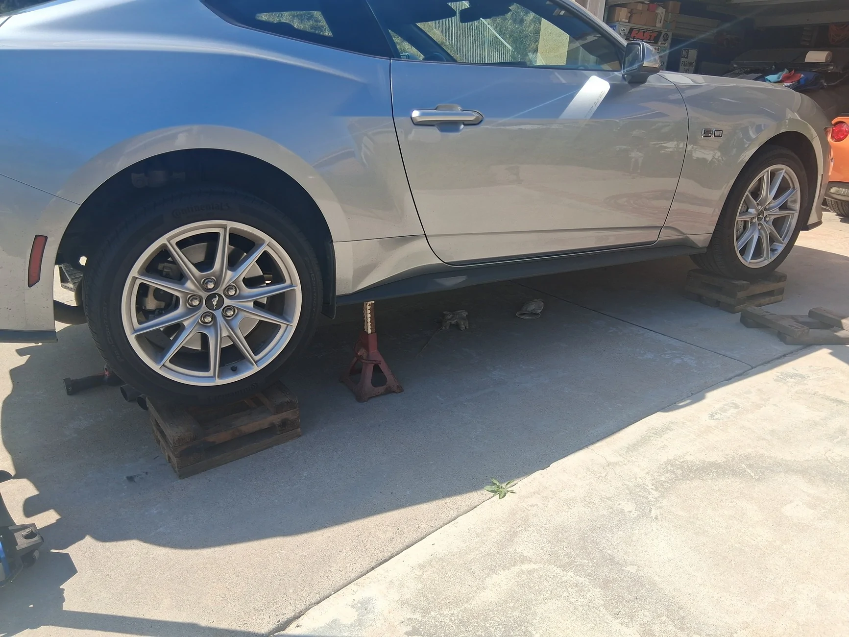

What ive figured out with low cars is to jack one side up and put a couple 2x4 under the one tire,and repeat on the other till I can jack from the crossmember, and I use wheel cribs made of wood ,and then jack the back up from the diff of the vehicle to put the stands or more wheel cribs.

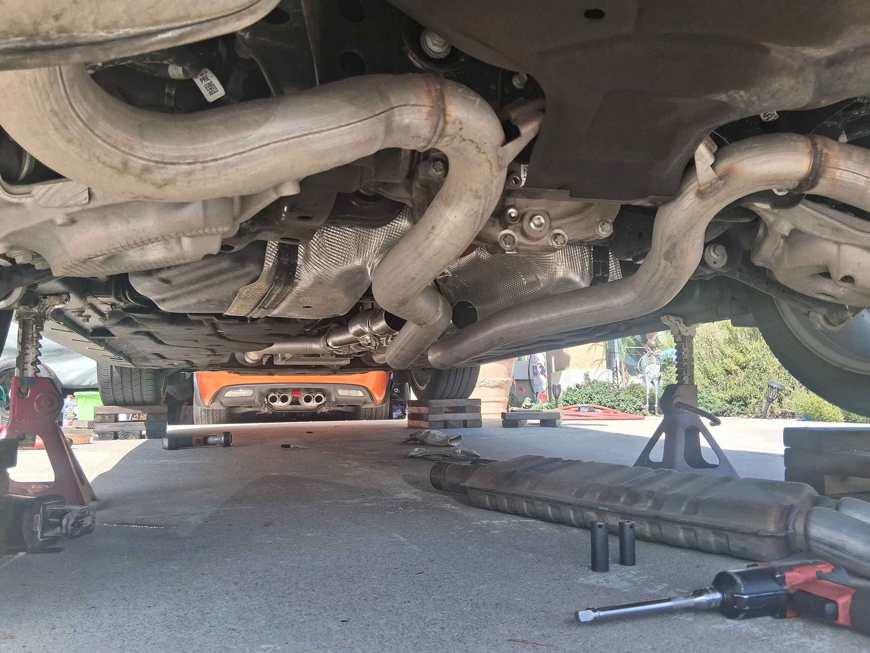

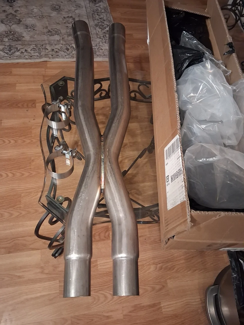

Pics.
BTW this fits the 2024 GT no problem.
Wife's car is a non active exhaust, but dont know if that matters.

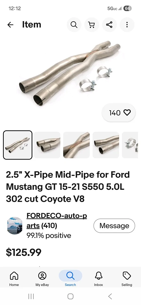

This is a very cost effective part.

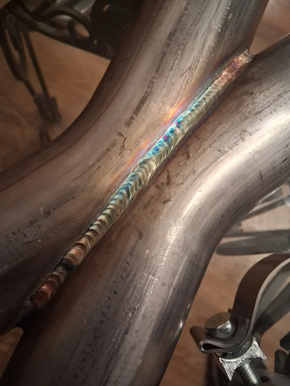

Welds are really nice,for a Chinese made part.
I think roush has them made from the same factory.

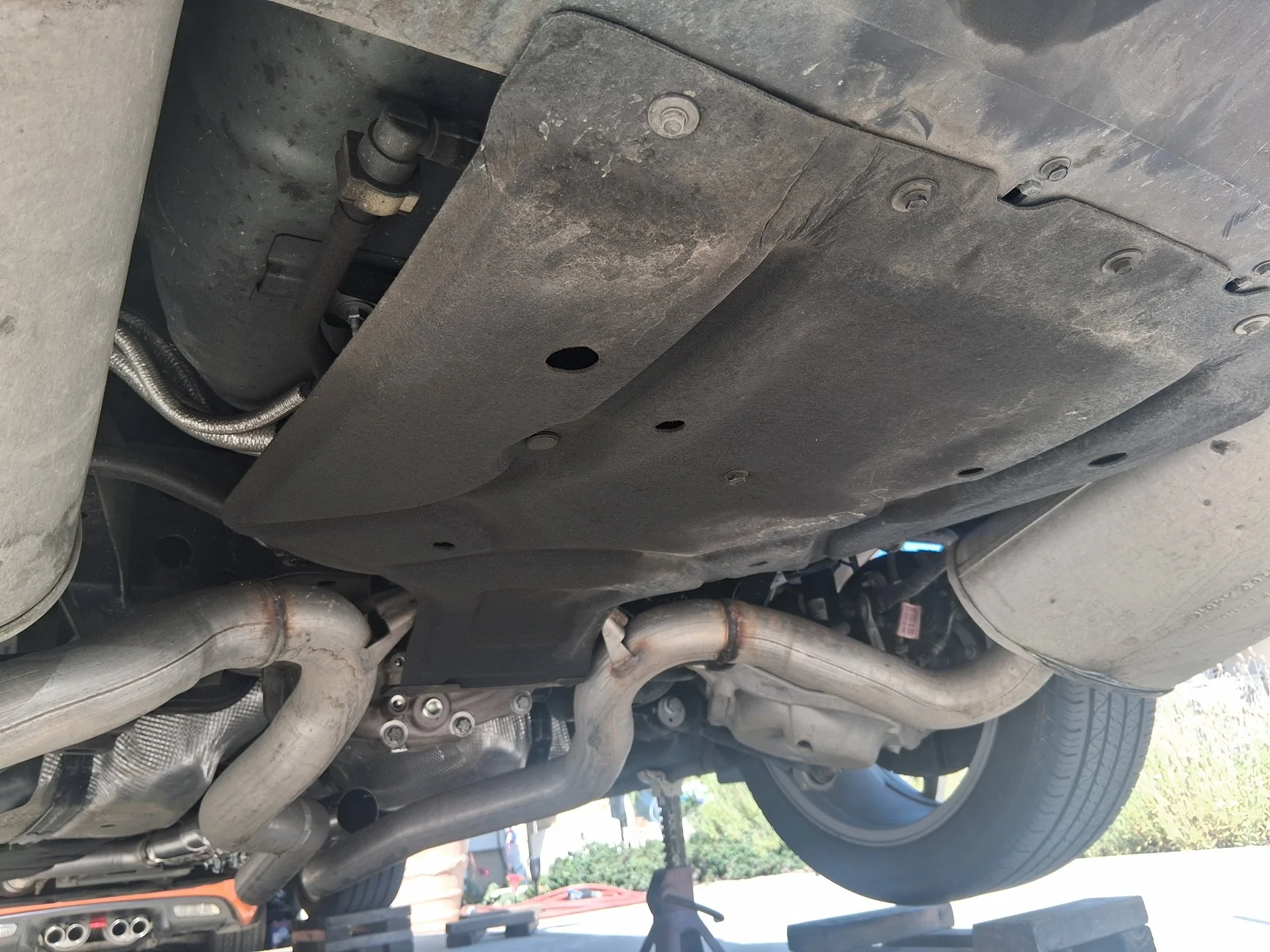

One thing that should be done is rough cut the catback tubes that attach to the mufflers,and have the xpipe bolted up,then
Have the catbacks off the car and use a 4.5 cutoff wheel on an angle grinder and fine tune the length needed.
I also found it easier to also unbolt the hanger brackets closest to the rear bumper have them installed onto the mufflers round bar and bolt it on to the frame.
Install is not very hard.
The sound is louder but not crazy or drone.
The wife likes it so she happy how her car sounds.
