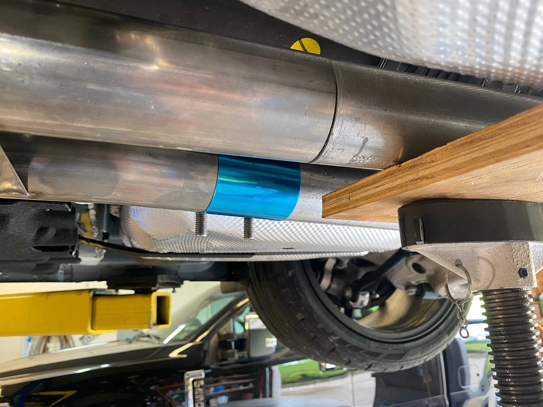

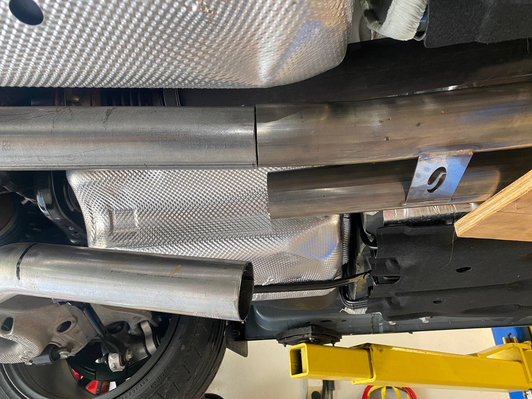

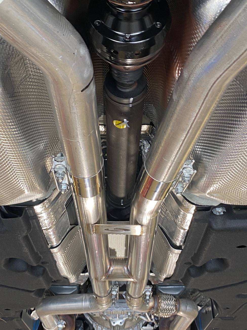

I installed the Steeda H-pipe. Cut the factory pipe using a chain style exhaust cutter for a clean square fit so when the clamps are installed, the H-pipe butts against the factory pipe — no sag. Clamps worked perfectly and it sounds great. The Steeda pipe is nice quality.
