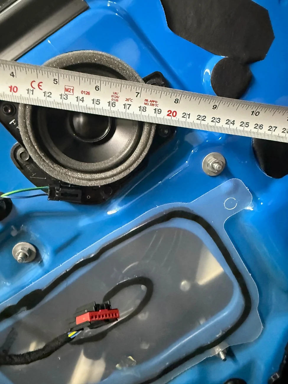

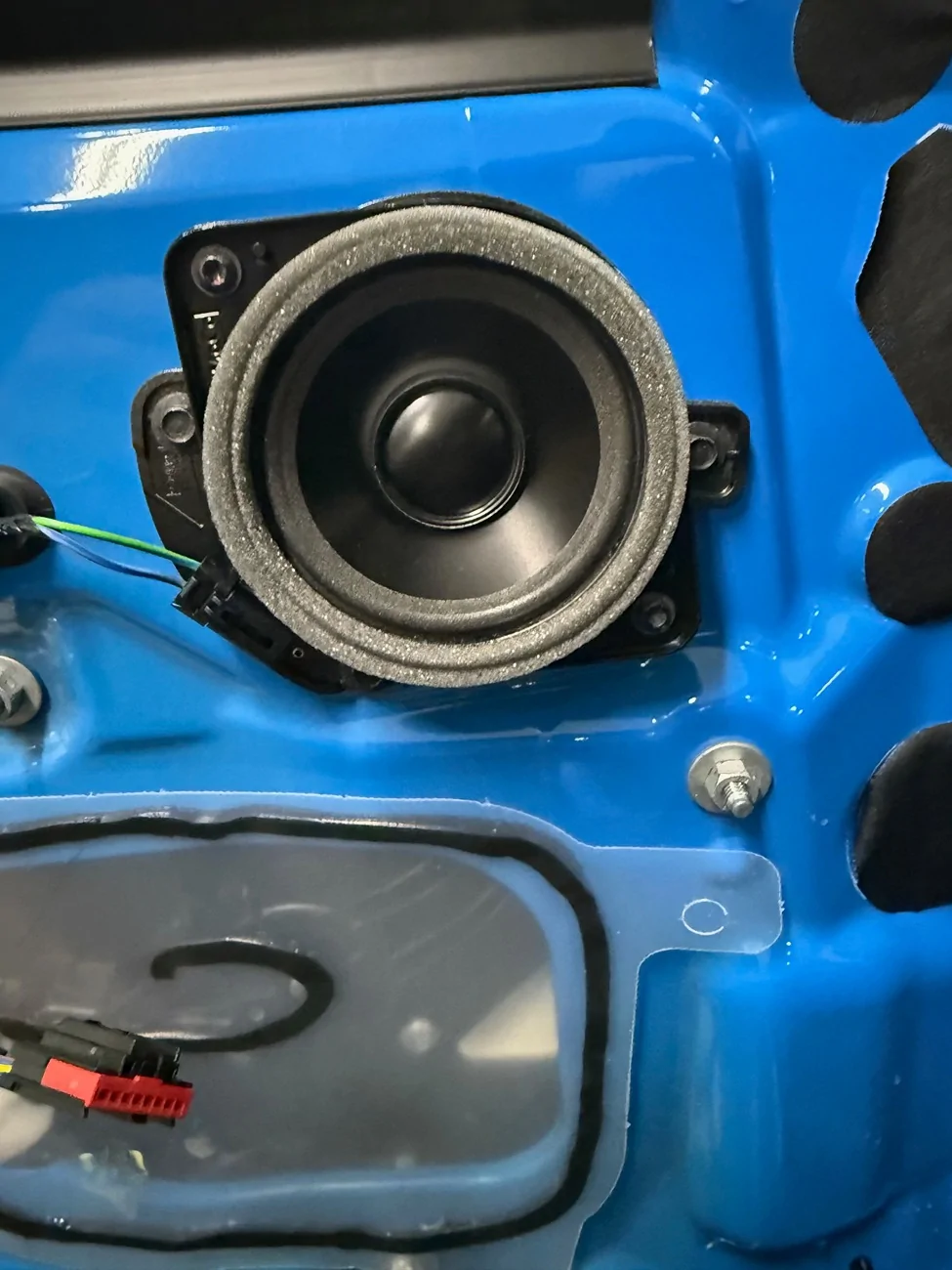

Removed the 80mm Mid from the dash . At least Ford don't discriminate and share the love with their country of origin purchasing. Changing out the Mids to a 4ohm should not affect as sub and bass 170mm are all running 4ohm. Has anyone stripped out the door and windscreen pillar speakers. Any photos.

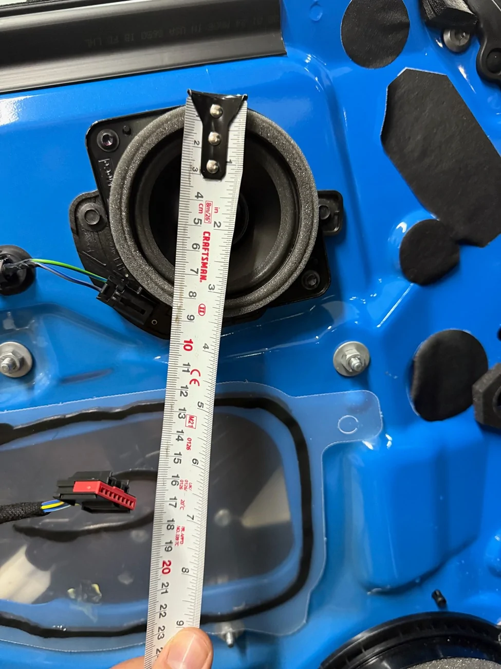

What is the center-to-center measurement of the two mounting holes in this OEM speaker?
(In mm, pretty please)

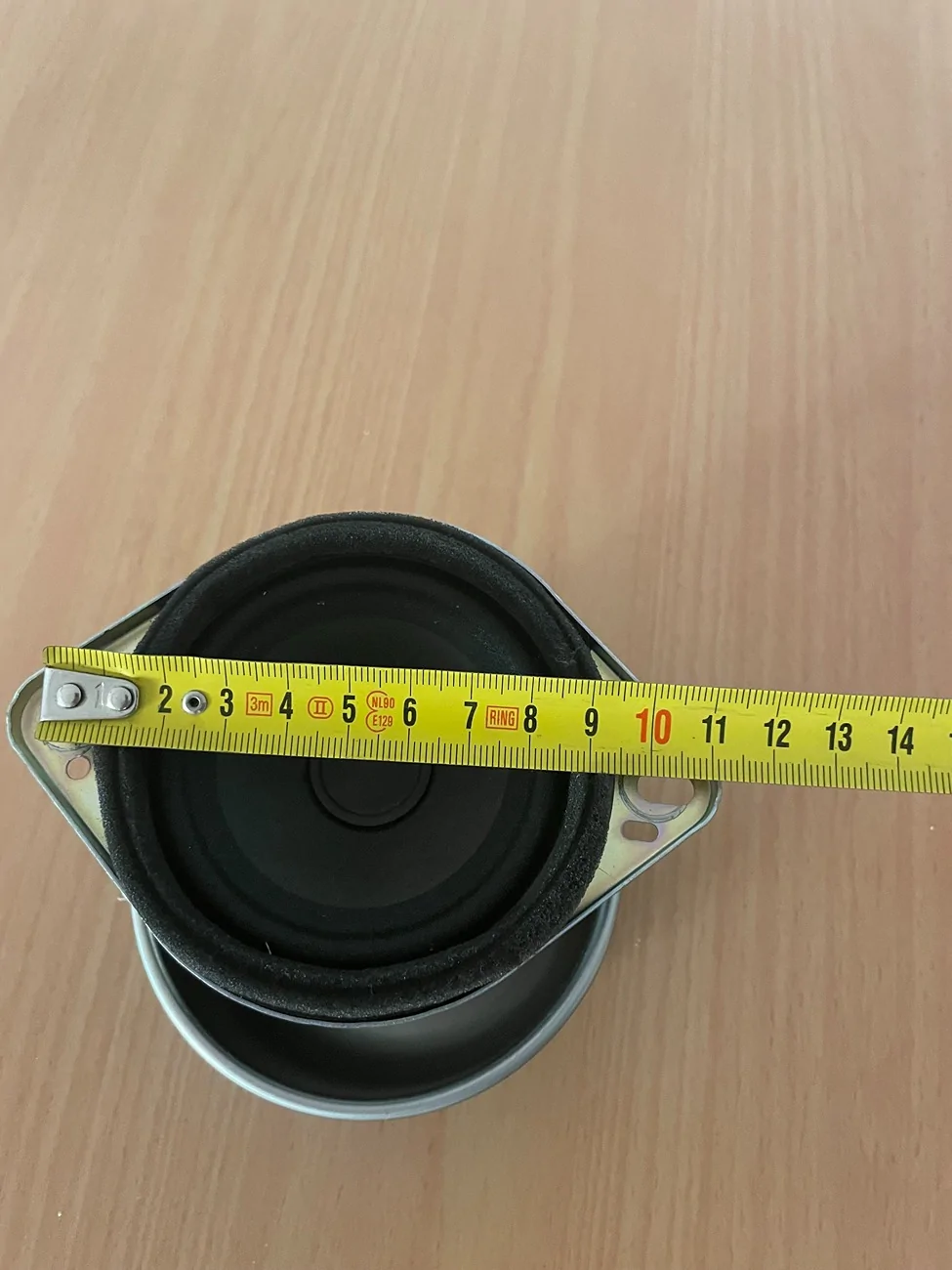

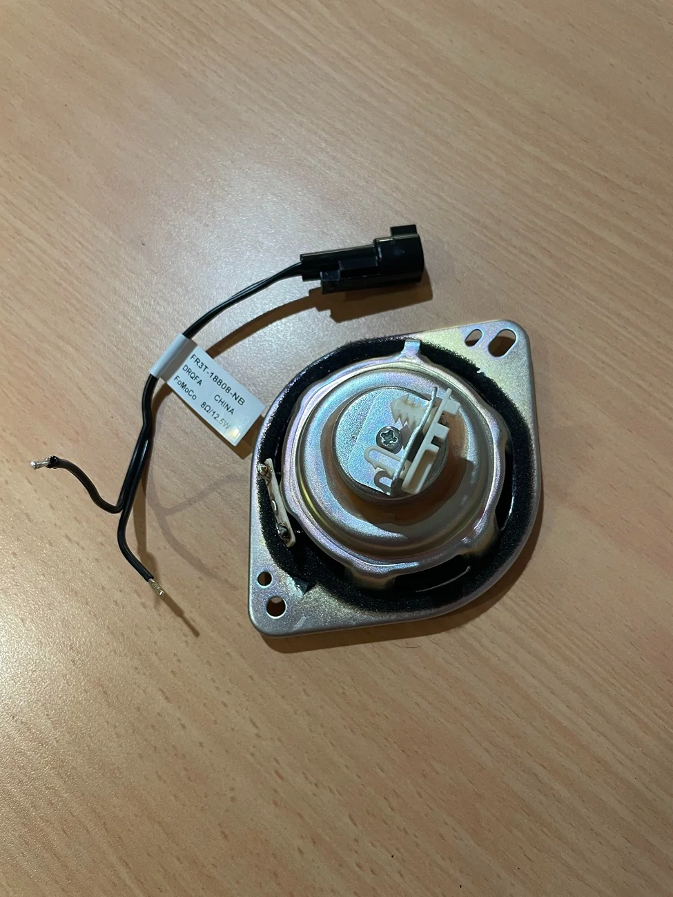

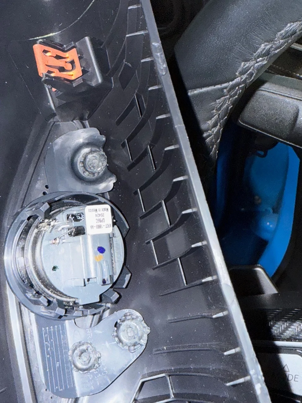

Here are pics of the Mid driver and the tweeter.

Went through the research exercise of replacing the 10" OEM sub. Do I add Pioneer or slim Focal replacement. Without putting an amp in line, the small output of the factory amp against the increased efficiency and increased power handling of the replacement sub could see the sound go backwards. Decided to experiment and use a combination of Home Theatre pyramid wall sound deadening material for the larger spaces and Response AX-3662 sound insulator for the small flatter areas. Move bass adjustment to 60% on internal screen and was very impressed with the difference in adding the sound deadening. This assisted the sub speaker to actually perform as a sub should. Not as punchy as a large magnet sub, but definitely deeper bass. Also read that a member had replaced their dash centre speaker with a Infinity 3032 CFX speaker drop in fitment. Sounded good, so I have ordered the set and as advised by the member will sell the second unit to another S650 owner + assist with installation. As per the photo if you remove the Phillips head screw, the bracket will separate from the magnet. Then you can pry off the plug from the white bracket leaving the connector and lead. Solder two speaker connectors to the speaker leads and you have a straight plug in connection to the Infinity 3032 CFX . Original OEM speaker is 8ohm, new Infinity is 4ohm. Sub and parcel shelve speakers are 4ohm, so it may be safe to say that the factory supplied 10 channel amp would have all channels with 4ohm output (can't see a 9 channel 4ohm and 1 channel 8ohm as a thing). So by deleting the original 8ohm and using the new 4ohn the power output of the centre speaker should increase from 12.5 watt to around 20watt.
