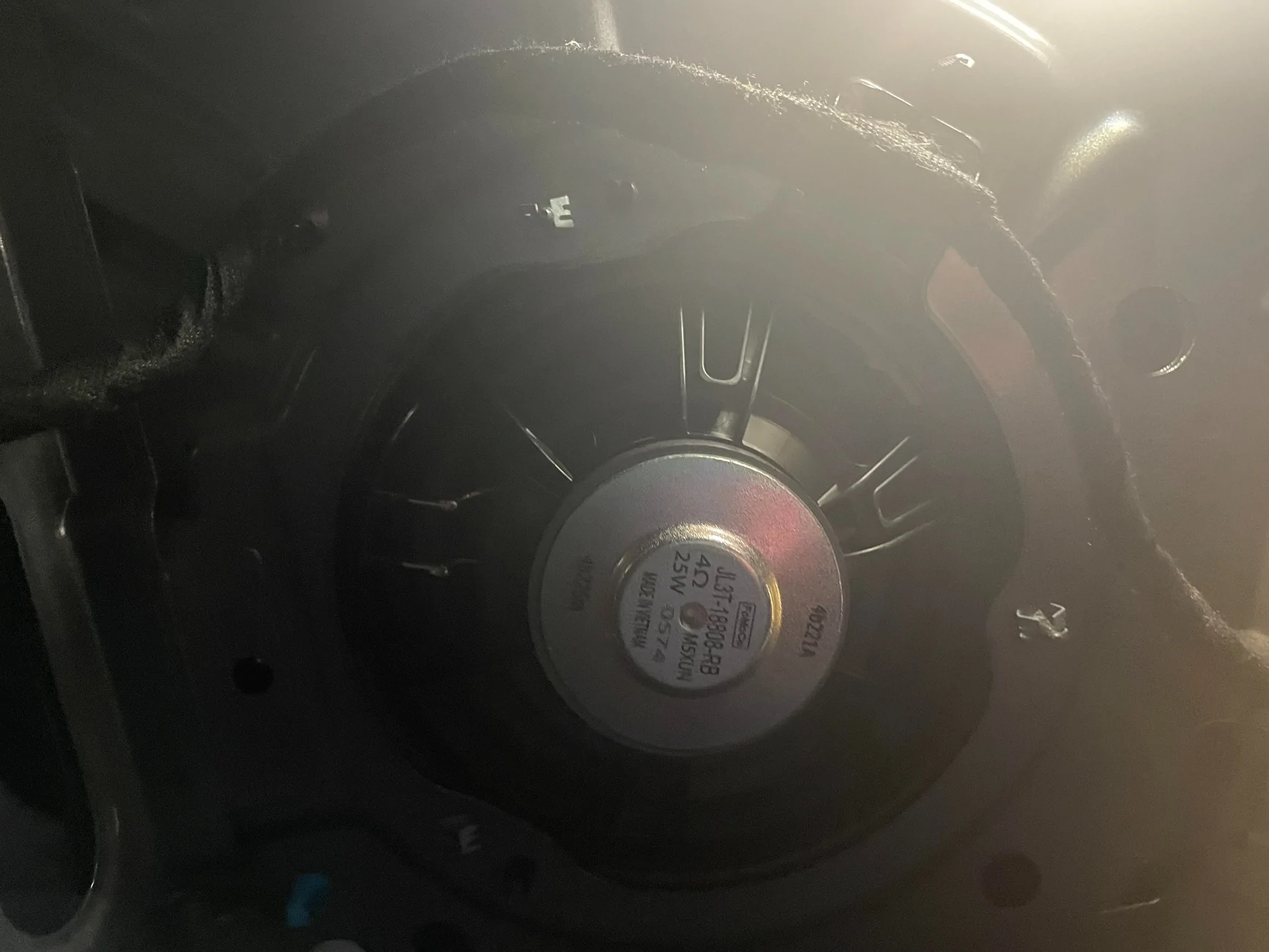

Has anyone looked under the rear parcel shelf at the rear speakers and opened the sub woofer box. Since when were B & O speakers made in Vietnam. Ford sound system information sheet rates the system at 900 watts (possibly 50-75 watt rms which is generous). Rear parcel speakers are 25 watts each leaving 850 watts. Sub could be 100 watts max leaving 750 watts. Door bass speaker the same 170mm as rear parcel shelf, so minus 25 watt leaves 725 watts. This leaves the three 80mm mid range and two 25mm tweeters up front to share 725 watts. Even if you boosted the subs potential to 500 watt (which would see the voice coil stretched to the max and quickly developing voice coil strap) the left over power would be 325 watts for the fronts.
The only thing about this system that could be B & O is the DSP unit. Speakers ..................no.

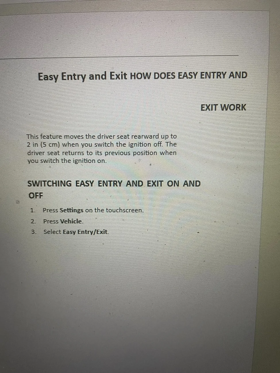

The build sheet from the factory for my Dark Horse shows that it has an Equipment Group package 700a MSRP 3,995US$ ( $6,139AUD$).
Forums on Mustang 7G list the differences between the 700a and 600a showing that the 700a package has the three way memory seat positioning. Not in my Dark Horse. Checked with the dealer and was told that "there was not a single Dark Horse in Australia with the three way memory seat positioning".
My Dark Horse does not have the "Easy entry and exit " programme. Does it exist?

If you read the "fine print" on the B&O description, it says "Designed by B&O". Whatever that means. all the speakers I was able to see were made in China, and had inferior magnets and cheap paper cones.
Seems "Designed by" is just lending their name for a fee at the least, and at the most, programming the speaker balances.

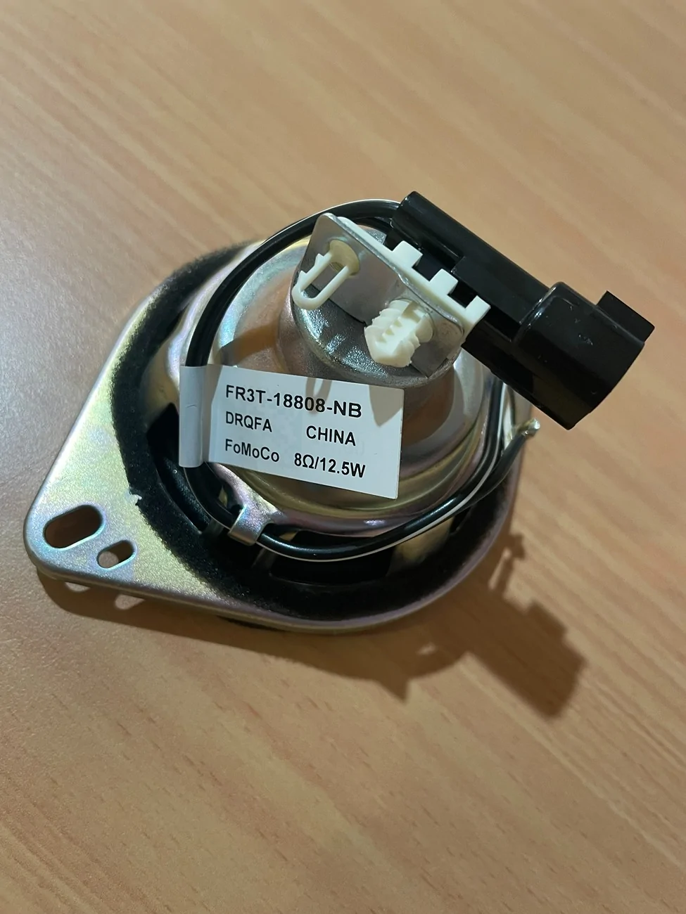

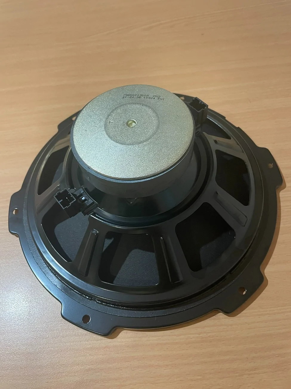

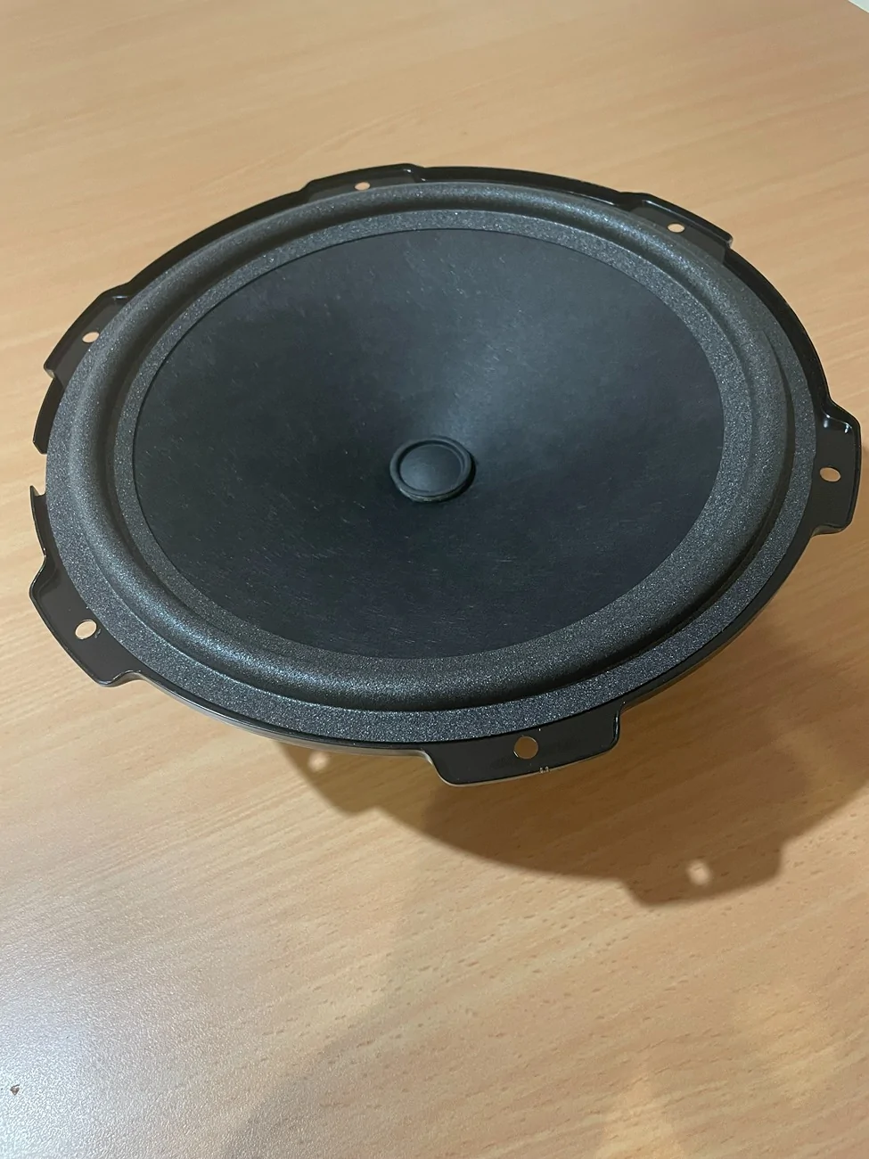

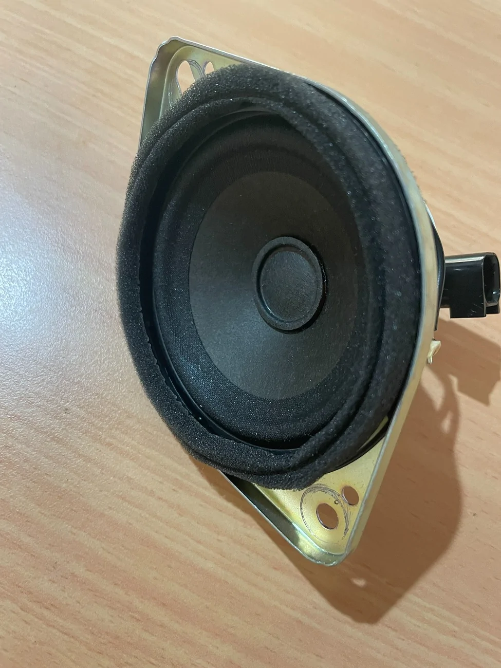

Removed the 80mm Mid from the dash . At least Ford don't discriminate and share the love with their country of origin purchasing. Changing out the Mids to a 4ohm should not affect as sub and bass 170mm are all running 4ohm. Has anyone stripped out the door and windscreen pillar speakers. Any photos.
