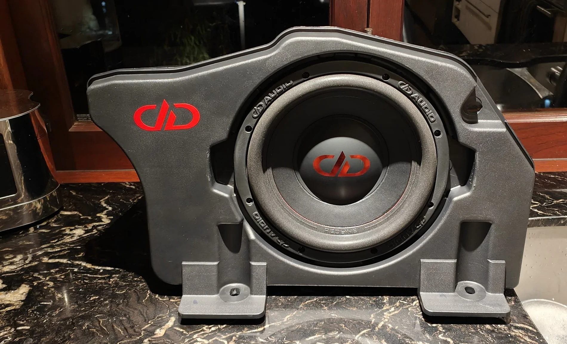

Replaced driver in B&0 subwoofer with DD Audio unit , much beefier driver than the factory unit , cannot reuse the factory grill so have ordered a 4 bar type from Amazon . Packed the enclosure with acoustic wool . Will refit tommorow and see how it goes . Went for this particular driver as its higher sensitivity than the popular Pioneer one . Want to avoid using a larger external sub box if i can help it . When i update cabin audio hardware will line Boot area with KIlmat while doing interior deadening

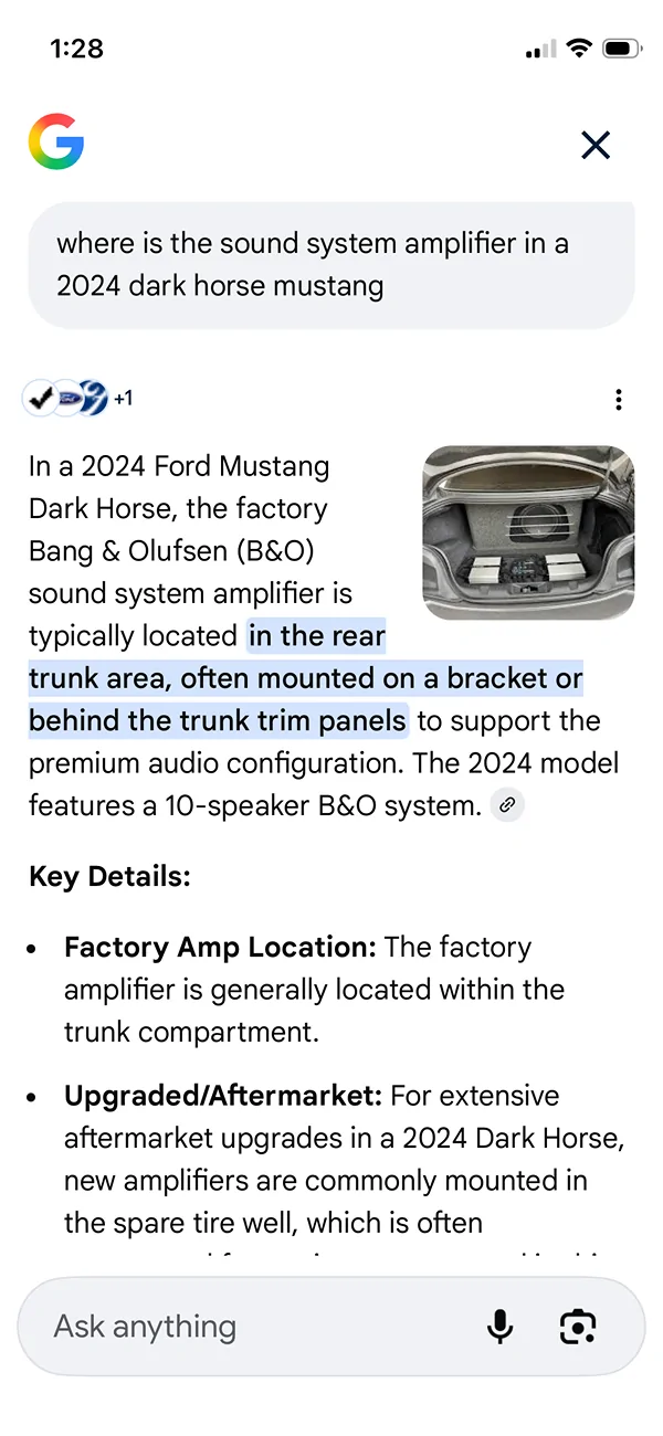

ugasouthernpride
Mar 3, 2024
110
Mississippi
Mustang GT
Anyone know where the B&O amp is located? I also replaced my factory driver with a DD audio redline unit. But, I want to tap into the wiring at the amp for speaker output and a nice LOC to restore the bass fall off and power this woofer better.
