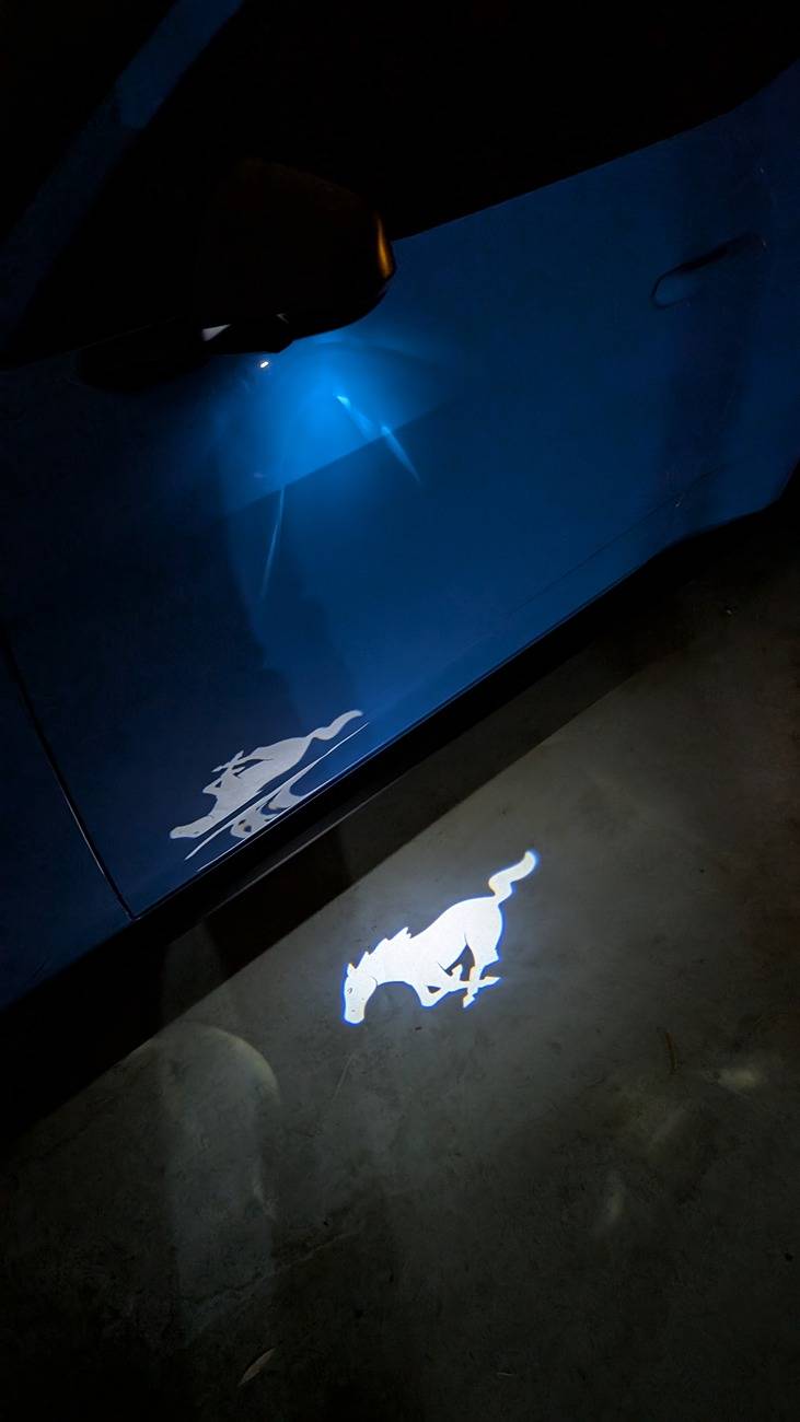

I thought I'd let everyone know that I bought a set of the Dark Horse Puddle lamps but they don't work properly on our cars.
The lamps project different to the stock pony ones which point straight down. These are more like the ones off the FM and are angled.
With the new welcome lighting, the puddle lamps come on when the mirrors are auto-folded. They don't work any other time from what I can see. Because of this and the lamps, they don't work properly.
Wouldn't recommend buying these and I now know why we got the pony lamps.

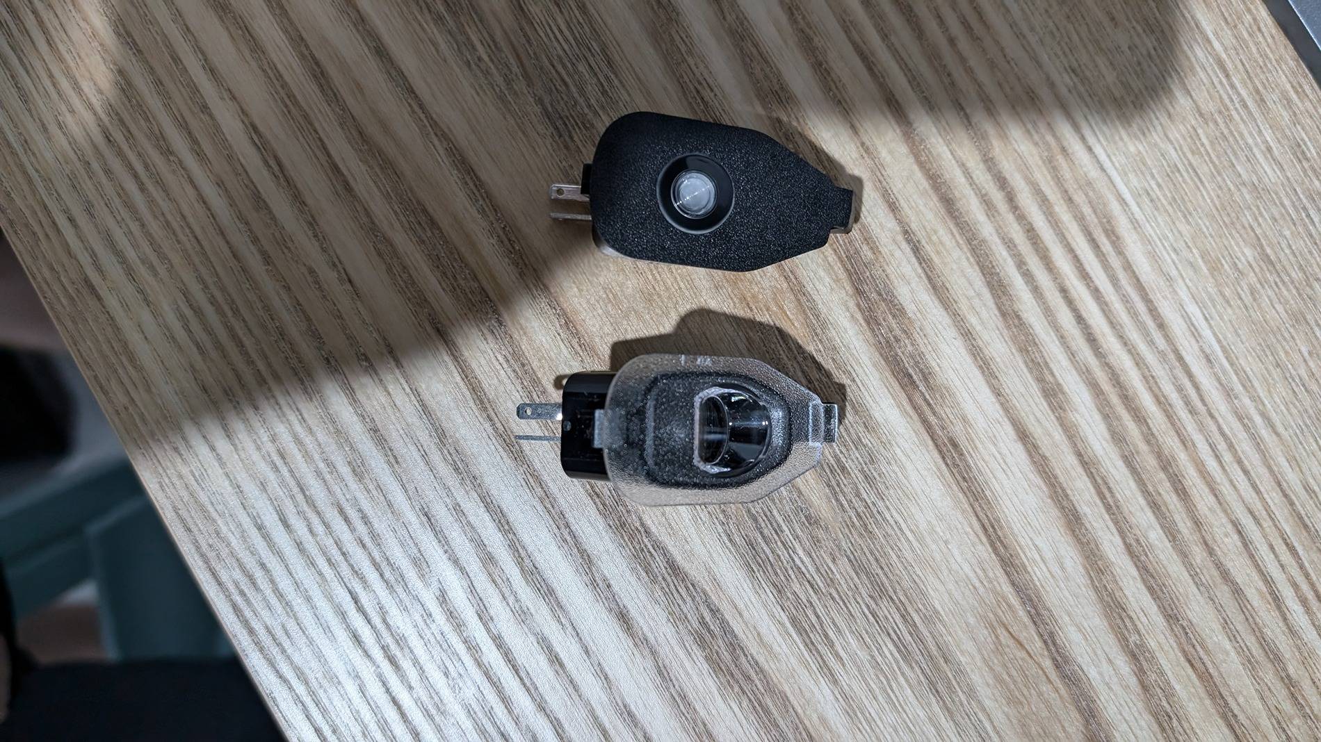

They are standard off the shelf Ford ones. They work fine, just dont point in the right direction when the lights are on.
The funny thing is the manual says that the puddle lights work when mirrors aren't folded, but my experience is they only work when auto-folded. Which means that the Dark Horse style ones dont work. I dont know why the have angled and non-angled ones though, its a bit odd.
SnowyB
SnowyB
Jul 29, 2015
Brisbane
DIB Mustang GT
They are a specific side. They face the right way, it's a power fold issue. US Dark Horses don't have power fold mirrors, hence why we get the pony logo

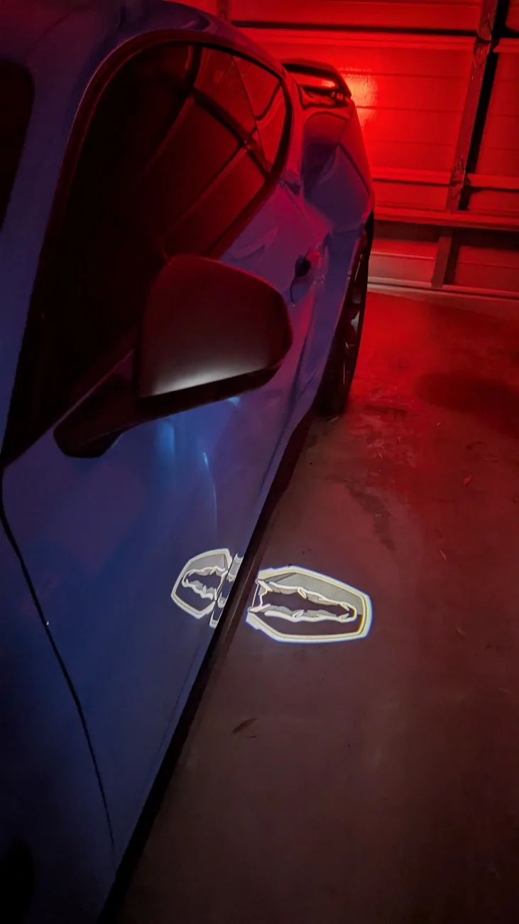

There's different sets, I do have power mirrors and the puddle lights will ONLY lights up with the mirrors folded and the welcome (approach) lights, they doesn't work when you open the car or the door like in the S550. Hence mine are angulated to work only when the mirrors are folded.

Exactly. That's the problem, power fold mirrors have lights that point straight down, the Dark Horse lamps are angled. So when they illuminate they are half pointing at the door. You can see that in the second picture. Unfortunately they don't make a dark horse version that suits the power fold mirrors. The only hope would be to reprogram the car to illuminate the puddle lights with the mirrors unfolded but I haven't seen anyone do that.​

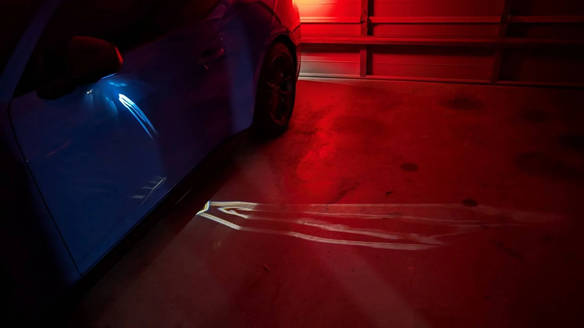

Update. After finding some changes in the Forscan section here I was able to change the settings so that the puddle lamps work when mirrors aren't folded so the dark horse logos shine on the ground and not the door. This also fixes the puddle lamps so they stay on when the car unlocks and you open the door. More how the older model did.
