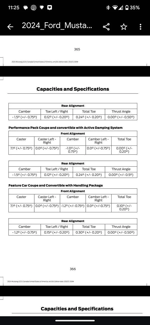

Is the performance pack GT and handling pack specs the same as the Dark Horse ?
Yes, DH without HP would be the same.
