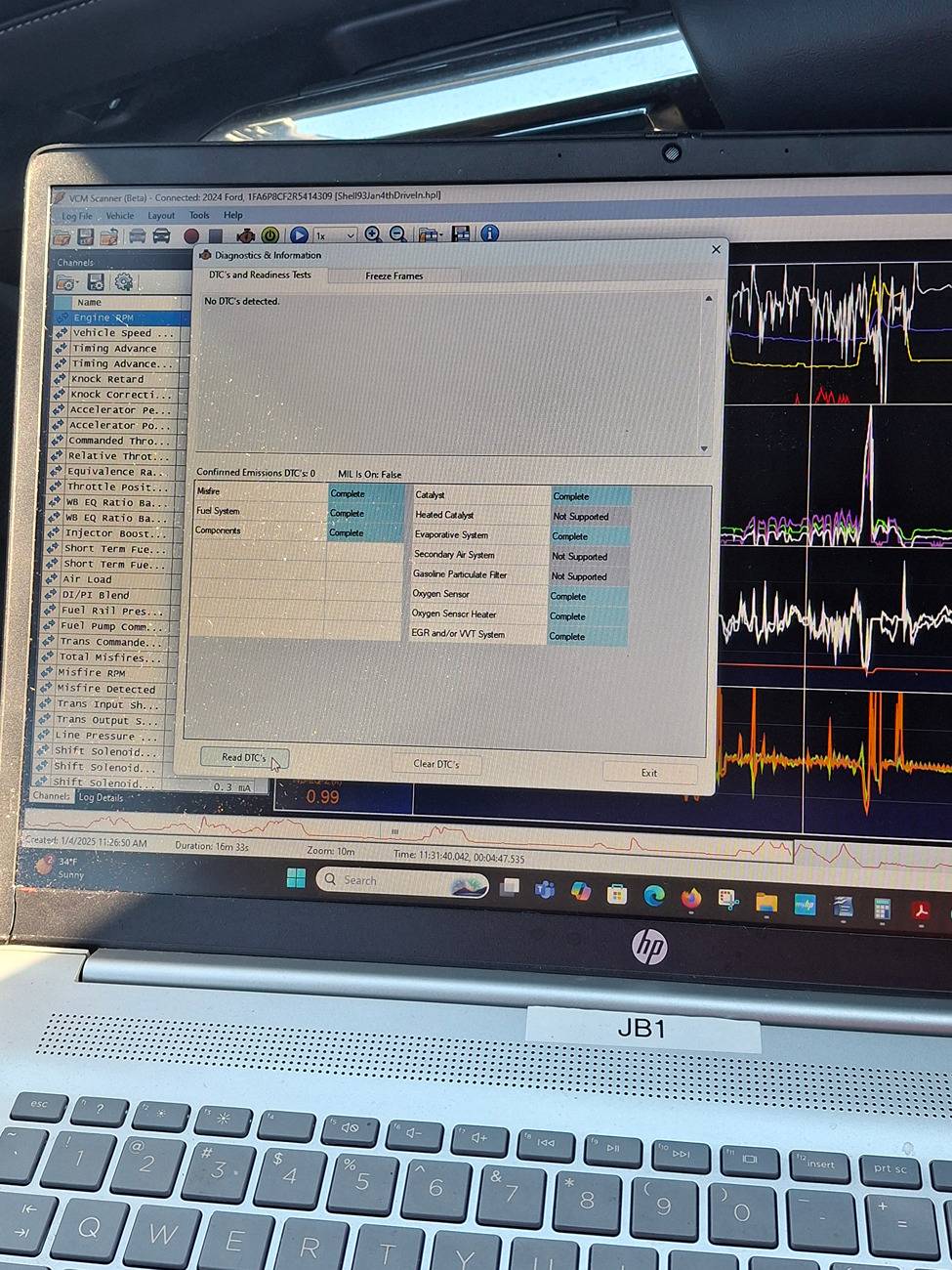

You shouldn't, I have the Lethal/Kooks Off Road LT's with the angled Daddy's Garage I have had no CEL since they were installed Dec 16th.
The O2's went ready pretty quick but it took 3weeks for the Evap to finally go ready,
I did do a KAM reset when I filled up with E40 for a trip to the track and then unhooked the battery to fit a lithium so that is probably why it took that long.
