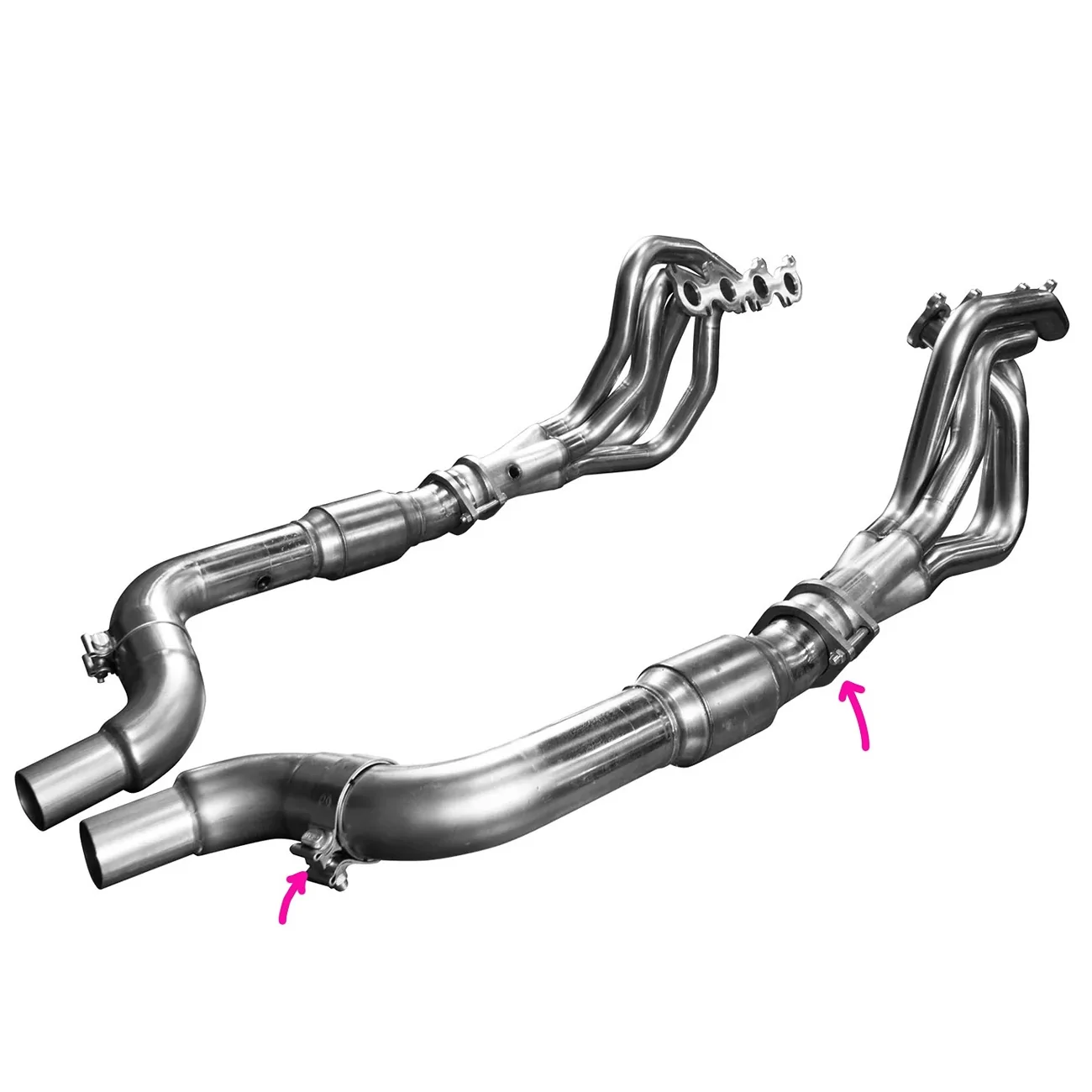

The s/w headers with cats are 'modular'. You can swap the cats in/out with a couple supplied pipes, no reciprocating saw required. I understand the Kooks cats are integrated; meaning you cut them out(?) or buy the whole catless section.
3,012
2,997
The Kooks are the same way, you can buy the 'competition' connection pipes or the catted ones, and just remove the clamps and swap them out

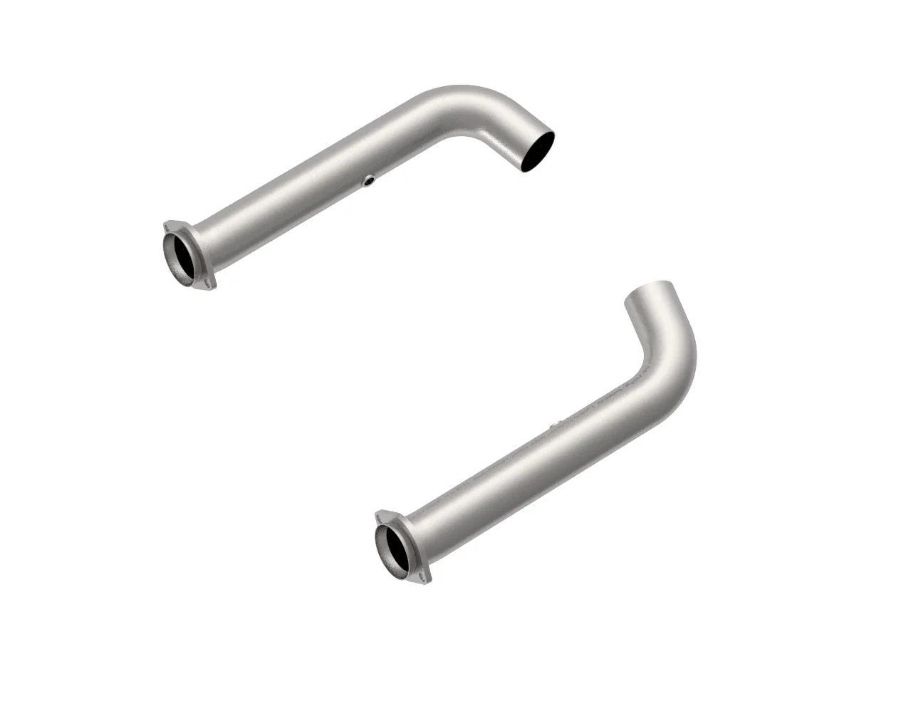

robvas, what size are those Kooks pipes from the header collector? (both the catted pipe up until that neck down for the resonator, and the competition?)
UPDATE: The competition only connection pipes are 3"
https://kooksheaders.com/products/11513100?_pos=2&_sid=e5e7e65fc&_ss=r
I can't find the spec on the catted version of that pipe, but any of you installing forced induction are going to want to upgrade the catalytic converter from what is offered with Kooks or any other off the shelf header. Step up from 300 cell to 400 cell and a higher horsepower rating with some margin for error on your forced induction beast.
