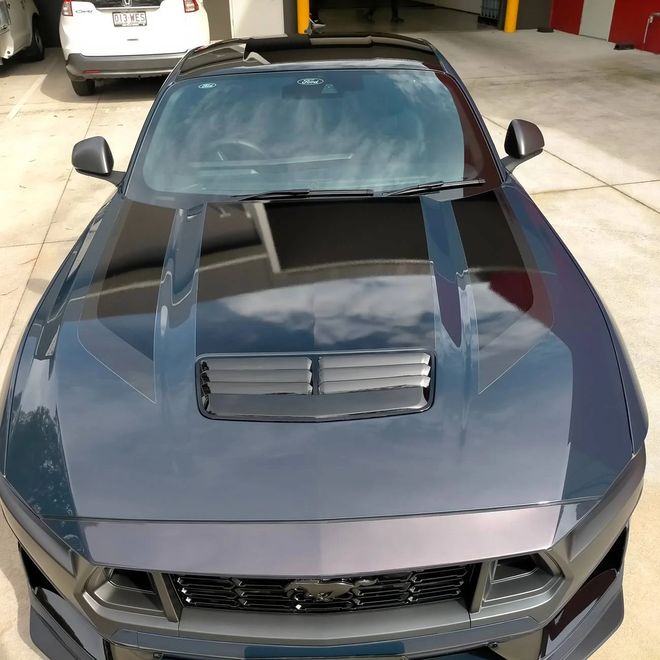

I made the same decision....northern Australia sun is not only hot but the UV destroys everything....one piece over the bonnet to protect everything..... initially there was a noticeable line between paint and vinyl, but has cleared up nicely.....pic below is day 1 at Auto Protective

Yeah, see mine still has the little outlines around the vinyl and I don't care. It went down quite a bit, but it is so uniform that I have actually come to like the look :cwl:

I think you made the right decision.

The reason I got them to butt the film up against the decal and not PPF over it is twofold. One, it will change the look of the decal. The satin or mat parts of the decal will become glossy. Two, when you want to replace the bonnet PPF, the decals will pull off with the PPF and they are super expensive. I've heard figures of something like $2000 USD. Now maybe the PPF only needs to come of in 10 years, or maybe you get a couple of chip marks on the PPF in two years. Who knows when or if that happens but being the bonnet, marks on the front PPF is likely, so I had them just ceramic coat the decal.
Also, with the film stopping right next to the decal, it makes the film and the decal the same height. It makes the decals look and feel like they're painted on.

That does look nice.,..I just didn't want to risk any damage...,still get the different tones with ppf......but everything is a satin finish..,.....will need to address this thread in 10 yrs and I am paying $20k for new vinyl :beer::shock:

Yeah there are many variables. I don't think there's a complete wrong or right way. Essentially just choose your poison. Each choice has pros and cons.
