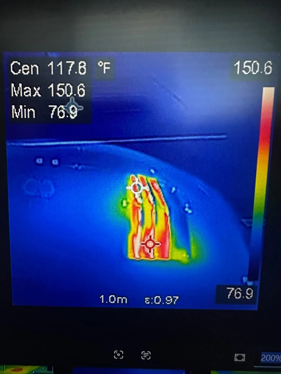

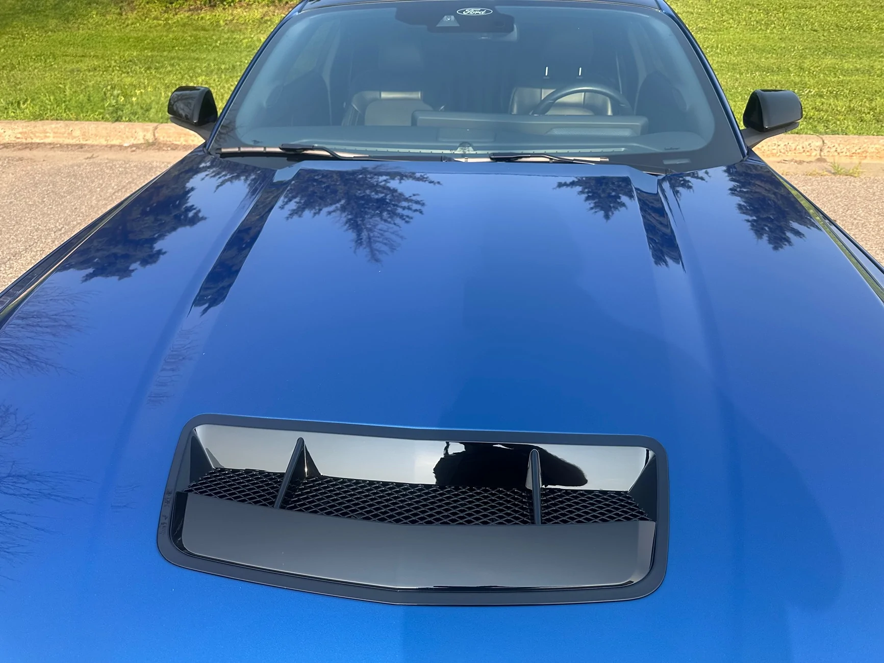

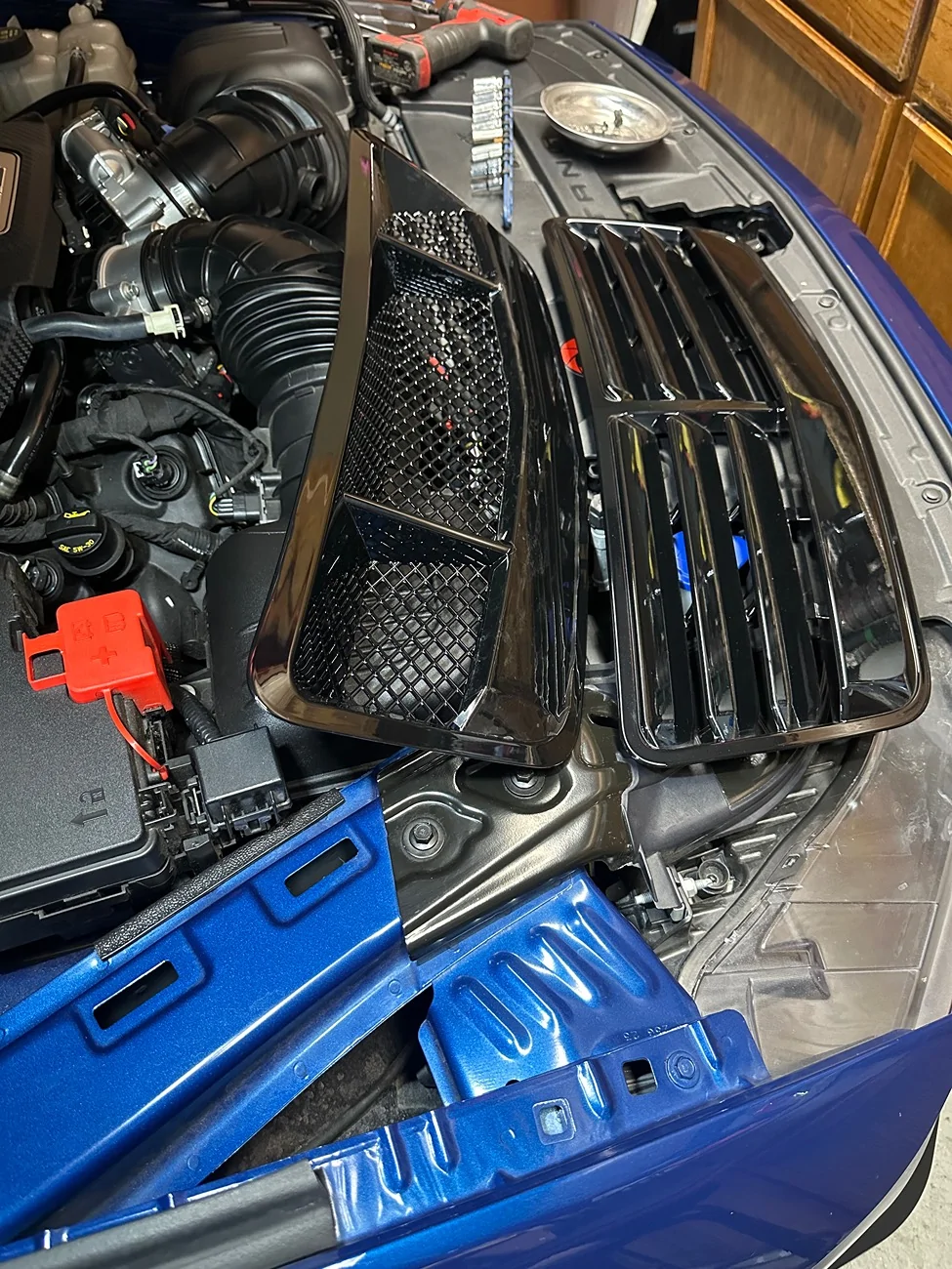

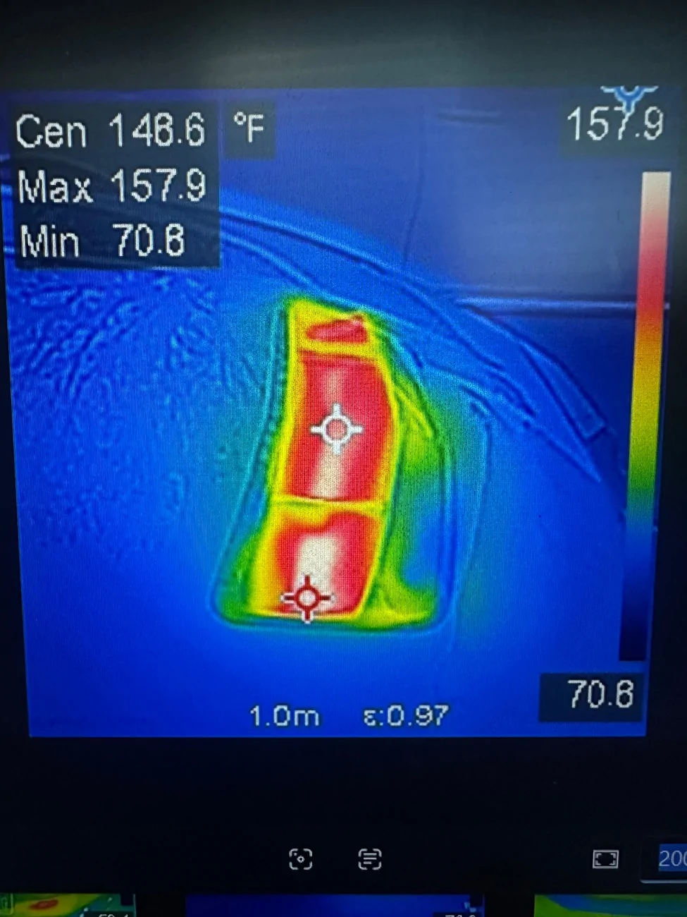

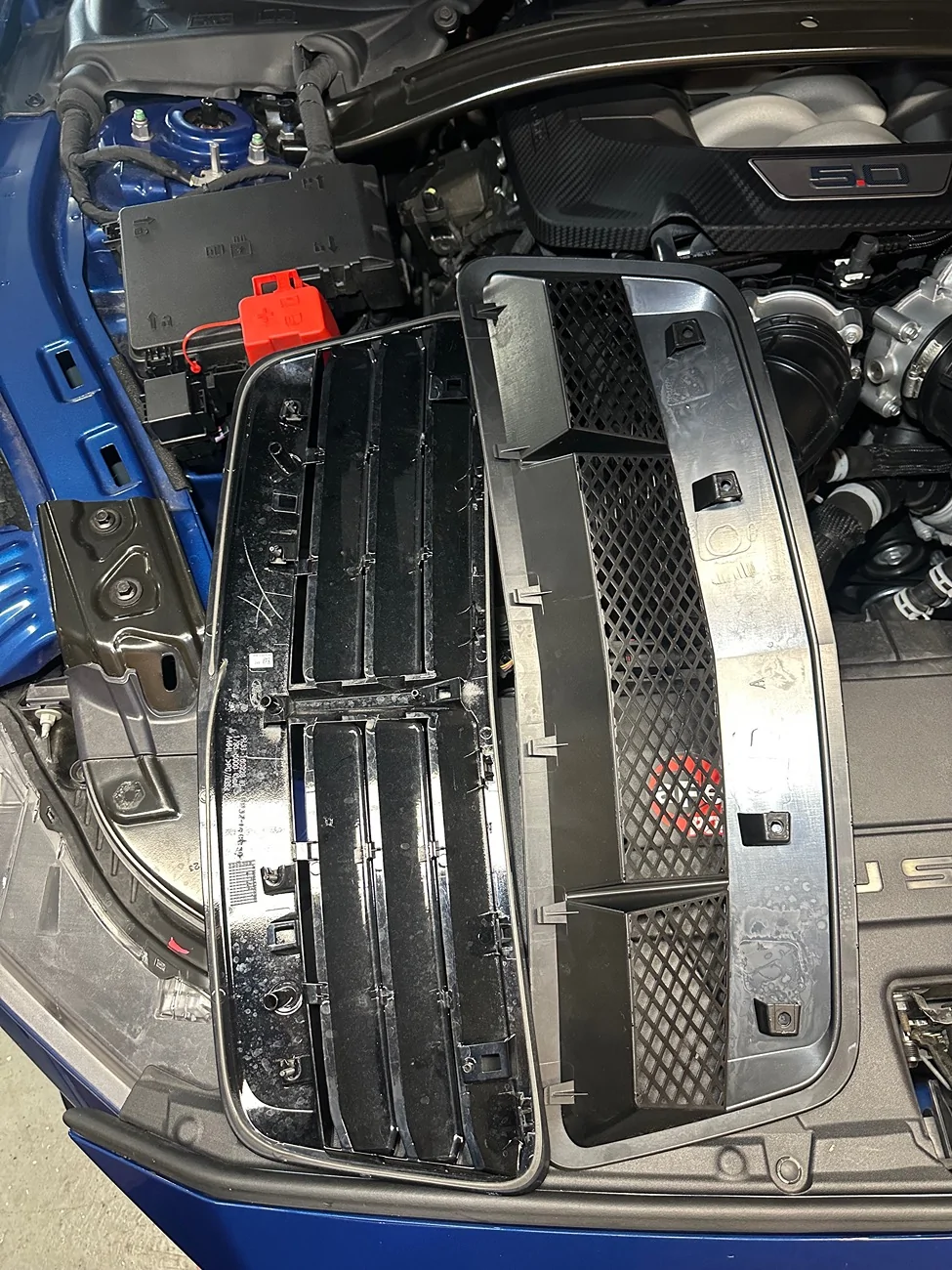

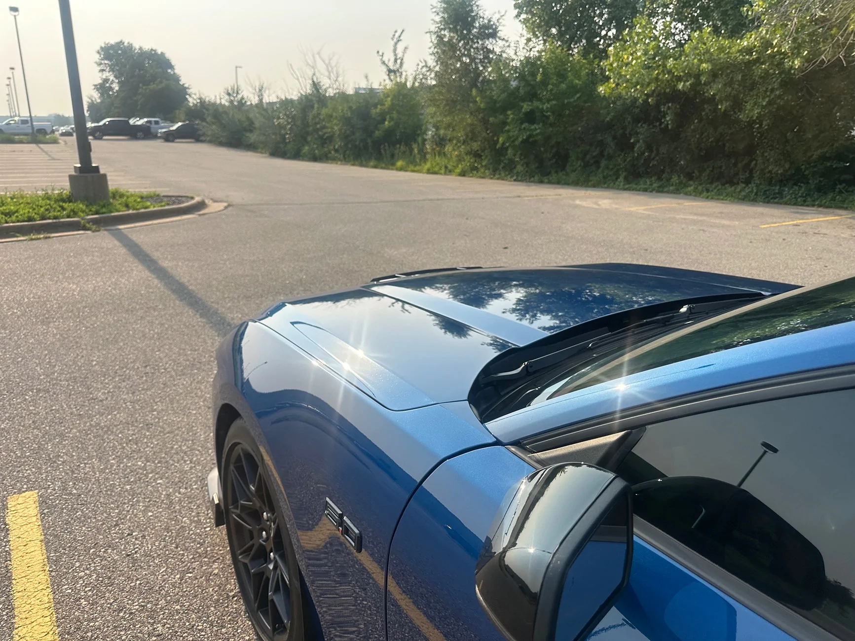

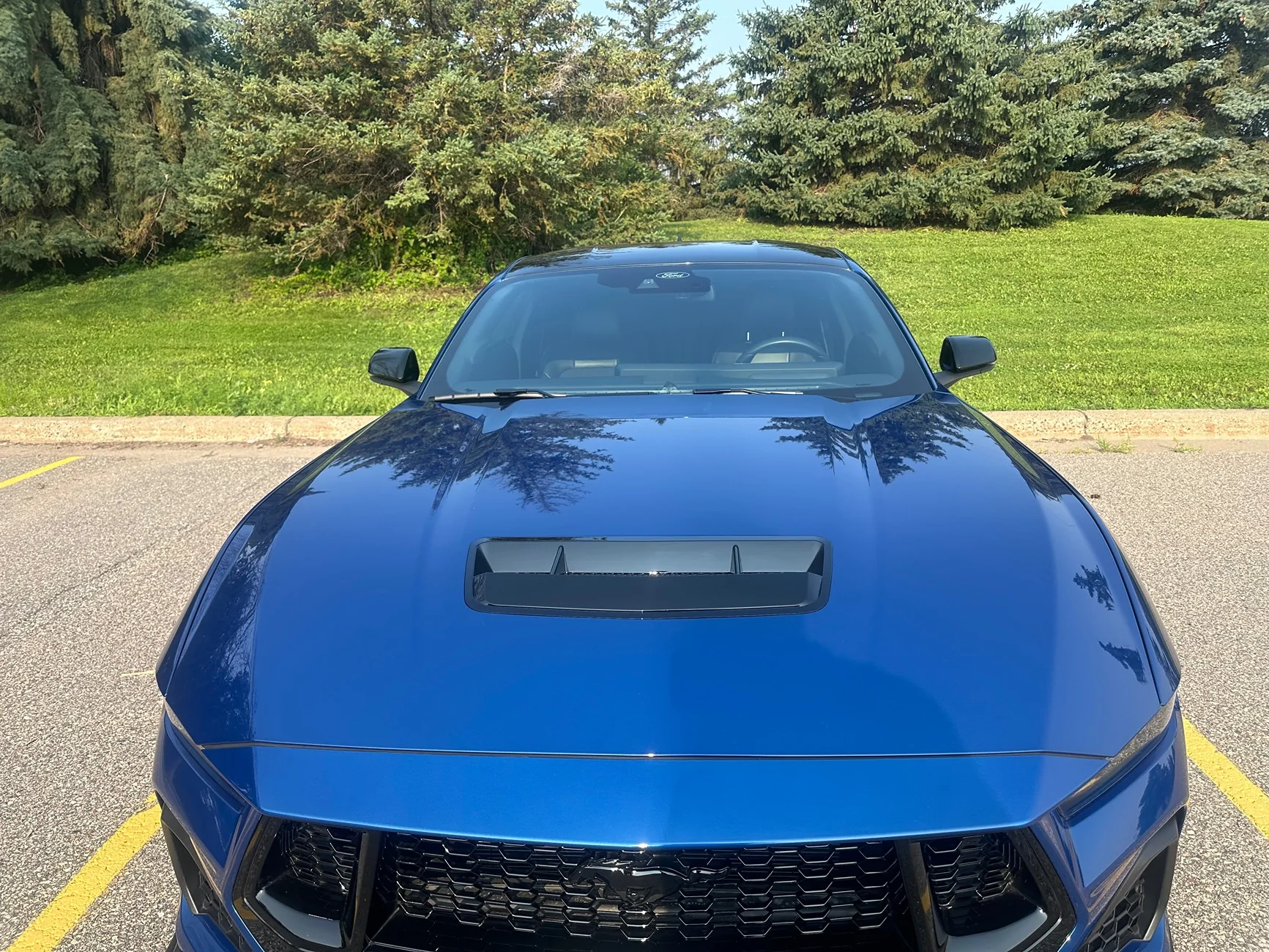

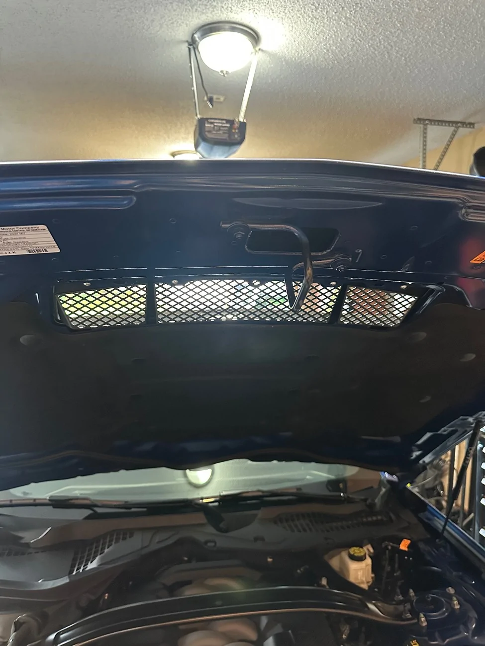

I recently installed the Shelby style hood vent from w2bodykits mostly for looks but was curious on functional differences as well. The vent is much lighter than the factory one and slots onto the hood versus having a clip retention method on the rear, the front bolts on in a similar style as the factory one. As far as functionality I don’t have a good way to measure air flow on hand but I do have a thermal camera that I like to play around with. I took a drive around the block with both vents on and tried to take similar pics. With the factory vent on I couldn’t see too much heat but the Shelby style was obvious. It will be interesting to see if it makes any difference on temps next time I take it to the track

Show us it installed on the car if you get a chance and im also curious if it vents better.

Looks great! Was it an easy swap? Is this a Ford OEM part?

been driving mine around seen a few degree drop across the board and iat's 2 to 3 giver or take a few degrees as well as a few on the oil and head temps. its a more open vent less airflow disturbance and turbulence. There's a reason Shelby made the vent the way it is. This is in 100+ degree heat in Florida. With humidity so high you have to chew first before you breath.

Very sharp! šŸ‘

I think the metallic bottom of the vent is the heat absorbers and wondered if plastic would give lesser heat?

Nice Vent Hood by the OP!! Wonder would rain have any effects on the Internals seeing that this is a More Open concept??
