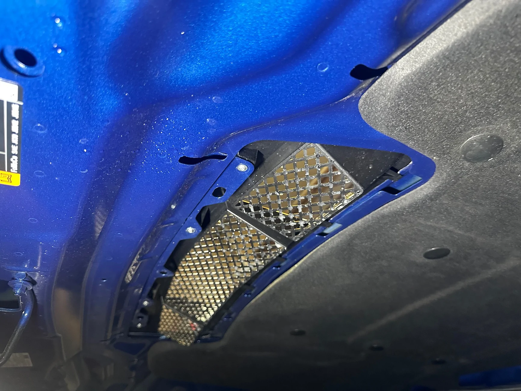

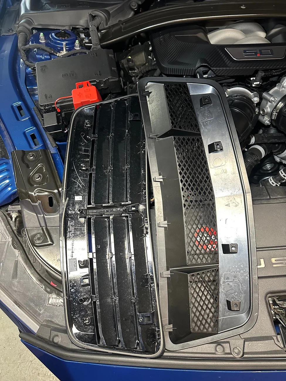

I think the metallic bottom of the vent is the heat absorbers and wondered if plastic would give lesser heat?
They are both 100% plastic the ford one is just made of a higher quality and more dense plastic

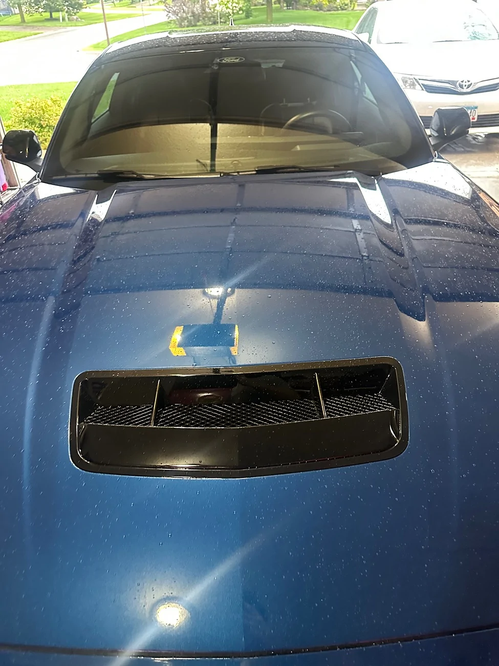

Nice Vent Hood by the OP!! Wonder would rain have any effects on the Internals seeing that this is a More Open concept??
Looking straight down the vent you mostly see the radiator cover so I’m not seeing it an issue parked and in the rain there is positive pressure there so it doesn’t go in. The only thing that I could see that would get water all over would be an automatic car wash. Plus all engine bay / underbody electrical connectors are wether pack connectors (have rubber gaskets protecting the wires/terminals) so unless you’re intentionally spraying them or modified something under hood I wouldn’t be worried about it

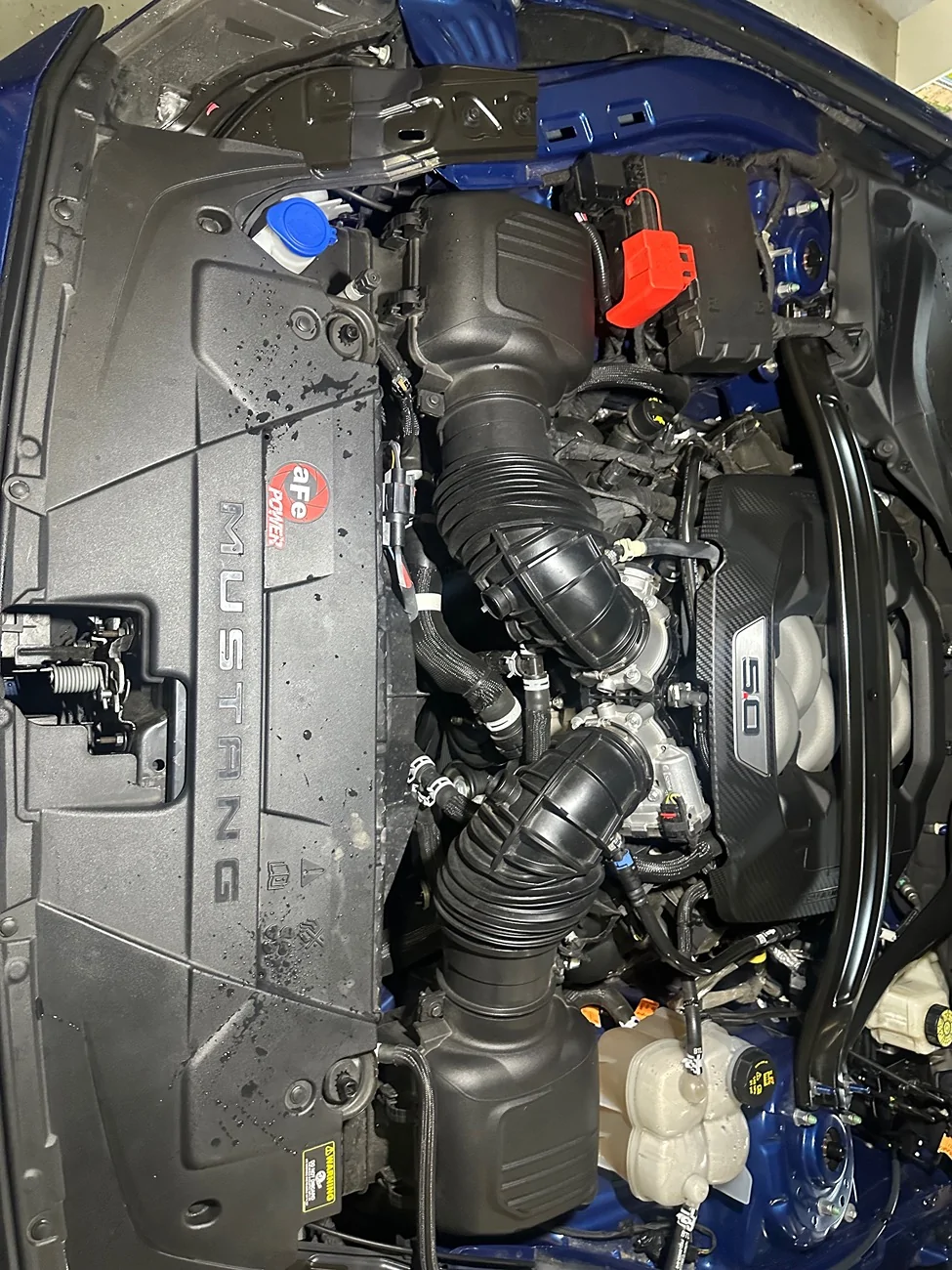

Update
Just drove the car about an hour in some heavy rain with mixed highway and city driving. Opened the hood immediately after I got home to inspect and take pictures. The only water I found was on the radiator cover, the engine and front accessories were dry. It looks like some of the water is coming out of the rectangular holes by the front corners of the vent. I’m guessing this is where ford designed the water to come out and I bet it comes out of the same area with the factory vent.

I recently installed the Shelby style hood vent from w2bodykits mostly for looks but was curious on functional differences as well. The vent is much lighter than the factory one and slots onto the hood versus having a clip retention method on the rear, the front bolts on in a similar style as the factory one. As far as functionality I don’t have a good way to measure air flow on hand but I do have a thermal camera that I like to play around with. I took a drive around the block with both vents on and tried to take similar pics. With the factory vent on I couldn’t see too much heat but the Shelby style was obvious. It will be interesting to see if it makes any difference on temps next time I take it to the track
