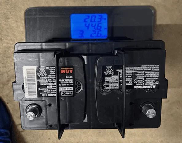

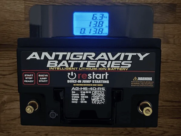

I installed an anti-gravity battery about 2 weeks ago. I just wanted to run it for a while before posting. This is a direct replacement the same size as the OEM battery that weighed 30.8 pounds less than the OEM battery. No issues whatsoever. The factory battery screw down clamp works with it as well. They do recommend charging it before you use it the first time and being it is lithium you have to use a lithium battery charger. I used a slow trickle charger and charged it overnight so it was ready the next day. Make sure you read all the instructions and the Ford manual section on replacing batteries before beginning the install as the vehicle likes to learn the state of charge with doors locked at rest for 8 hours from what I remember. The only downside is that it is expensive. I think I paid about $1,000 for it but it also comes with a restart feature and a small key fob. If your battery ever dies you can jump start the car at the push of a button as it is an intelligent battery that keeps a reserve in case you forget to turn your dome lights off or anything like that. They have different amp hour recommendations depending on your climate but that is all explained well in a video on their website. The model number I used is on top of the battery. I live in the mid-west and the car is garage kept.
OEM:

Anti - Gravity:

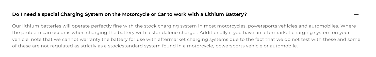

Forgive my ignorance. If it needs a lithium battery charger for standalone charging, how is the car going to safely charge it?
The battery management system is expecting a lead acid AGM battery, no?
It has something to do with the way standalone lead acid chargers work.
From their website: Lead-acid chargers will tend to overcharge a lithium battery. Additionally lead-acid chargers often have special modes like Desulfation Modes that can spike the voltage to the battery. This can damage a lithium battery.
As far as the car interpreting the battery type this is also from their website.
👍🏻 Sounds like they have it figured out. My Noco charger has a lithium mode, I wonder if that battery is a good use case. They didn’t list it on their site.
