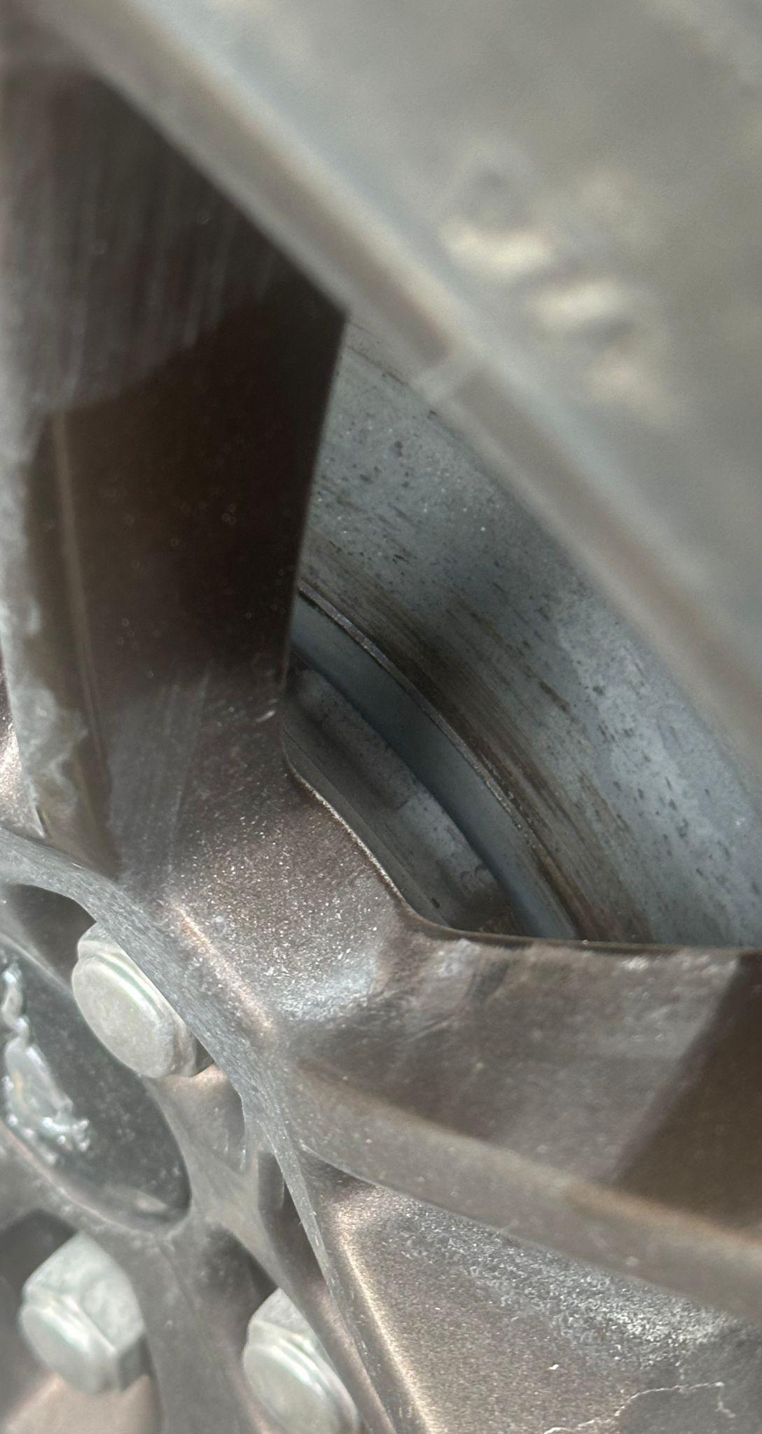

I tried going under the car and checked behind the rotors as far as my hand could reach. I didnt see anything out of place and did not feel anything rubbing against the rotors. I tried going for a drive and didnt hear the noise but it did come and go for a second.
Also, I noticed these scratches on the rear left rotor. I dont see these kinds of scratches on the other three rotors. Something to do with the noise? What can it be?

I think it has to do with the panel gaps.
Probably some bad panels hitting your rotors..
What panels? Body panels?
Which panels can hit the rotor so that the inside gets scratched?

Omg bro…
Jack the car up, pull the wheel off, pull the caliper and I bet you’ll find the interference.
do it before you actually do some damage and have to really fix some bs.
