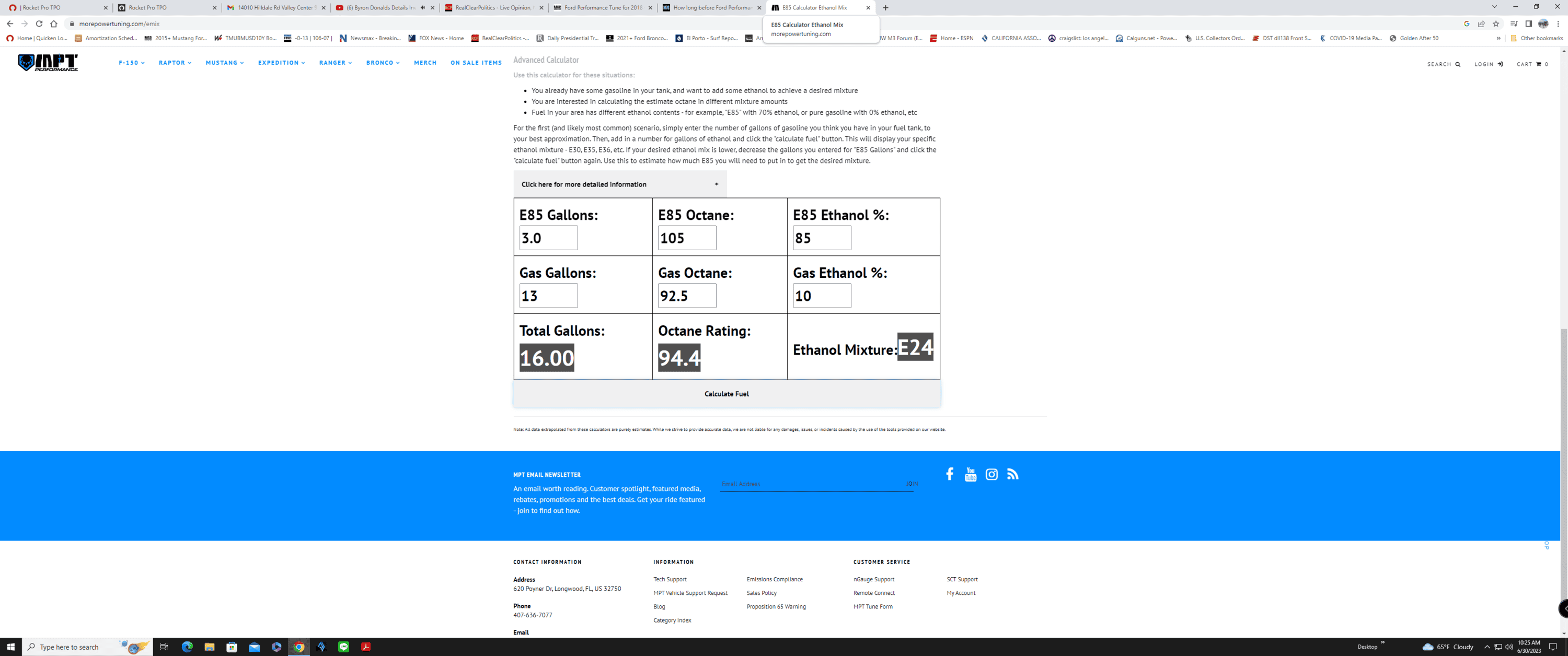

I actually run a E25 fuel with the Ford Performance tune. Yes its not tuned for it, but the car definitely likes the better octane. I run 3.0 gallons of E85 (Cali gets true E85) and I run 2 gallons of VP racing 101. Gets me to about 94.5 octane. The car runs like a raped ape.
Running e25 like that really isn’t ideal run e15 “blend” mixed with 93, the car is actually rated for that. And it’s more related to the fact when you run full e85 you can’t baby the car because of oil contamination, it becomes very acidic very quickly, so basically you gotta beat on it or run it up to temp everytime you start the car. So my guess that’s why it’s never been available for the FRPP tunes, both warranty and emissions related
The S550 Gen 3 cars can run up to E30 with no issues. Like I say my car runs like a beast now. Ford only recommends not to go beyond E15 as the Federal Govt. along with other states are pushing for that to be the norm.
