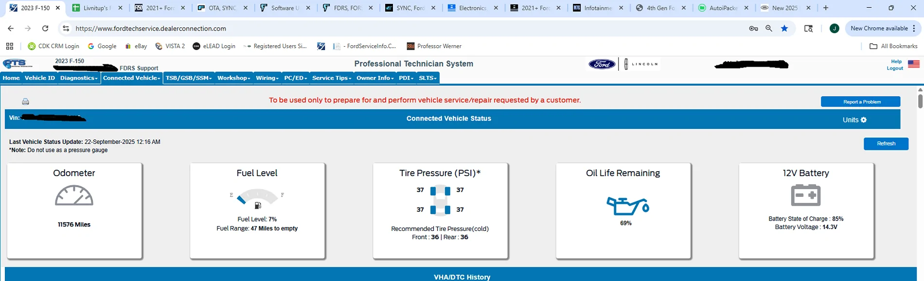

Reporting back, I kept the car on a battery tender all day and this morning the update completed successfully. Thanks @rugedraw for the help!
is there anyway to check what the battery SoC is currently?
rugedraw
Apr 17, 2024
487
618
Miami, FL
75% as of 18 minutes ago.

rugedraw
Apr 17, 2024
487
618
Miami, FL
I did a voltage test on mine, and just looked up a table on Google to get a ballpark on the actual percentage.
Unfortunately there is nothing WE can access on the car that will give you percentage in real time. However, when I called Ford pass they were able to somehow look at the vehicle and tell me it was under 80%. 🤷‍♂️
Yea, that info is based on whatever SoC the vehicle reported to the cloud the last time it was driven or the ignition was cycled on long enough for the vehicle to ping the mothership. They can see that in the PTS website. I have access to most of the stuff they have access to. It won't do it in real time, though.
S650 Mustang Having issues updating software Untitled
3,875
5,463
Interesting. How did get access to that?
