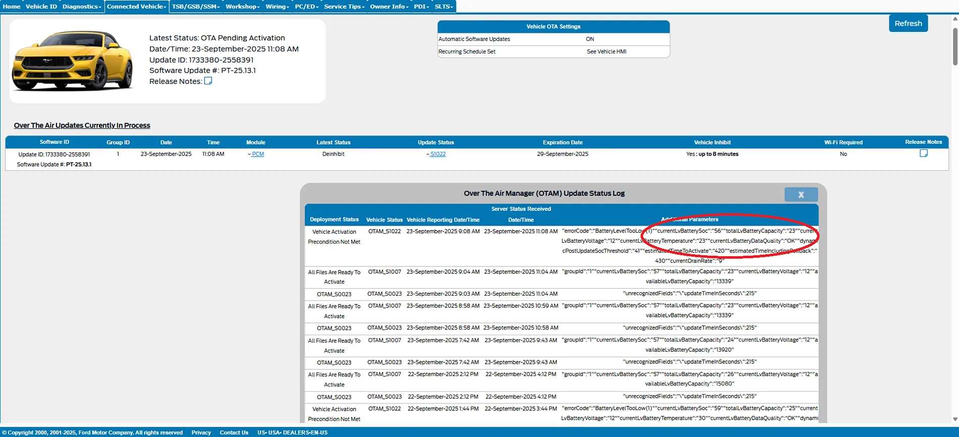

@klopklop I got your message, but responding here for the sake of the info being out there. See below from your OTA dashboard in red. BMS data quality is fine, but the SoC is low at 56% and the capacity is also low at 23 out of 70 (assuming these cars come with an H6 size 12v battery). It is 100% failing due to poor battery specs. If you do not have a battery charger, I would recommend you drive the car for 20-30 minutes with the a/c fan speed set to at least 5 (this will trigger the charging system to charge the 12v battery constantly) and then try to manually install it when you park and the battery is charged up. If you do have a 12v charger, then charge your battery up to 100% and try again.
Edit: If your car is tuned, this update will wipe the tune and return it to stock.
Thank you so much for confirming the issue. I drive it almost daily on a 45 min roundtrip to pickup my child and I have tried the A/C on low temp and full blast method but it didn’t see to work still. I have ordered a trickle charger and will try with that now.

Maybe a bad battery then. Your car has a build date of August 2024, so the battery is barely a year old. If you drive the car that much, I see no reason why the battery would be so low in terms of charge/capacity.

Dealer puts it on a power supply; not a trickle charger. In the case of the PCM, I would not even put it on a power supply because it literally takes 3-5 minutes to flash. When updating an IPMA (for example) that can take 1-3 hours to flash depending on the hardware, connecting the battery to a power supply is mandatory to prevent voltage from dropping and bricking the module. However, this particular update for the PCM is very quick and with FDRS, I would do it with the battery in its current state with zero worries. However, the OTA process will not make a judgement call like a tech would and if the battery is below spec, it will not allow the update to install.
I drive my car 5 days a week and had the same problem. The battery was about 70% and wouldn't complete the update. Once charged it updated fine. I had the battery checked and it was fine too. I think these things have a bad parasitic draw when off.
