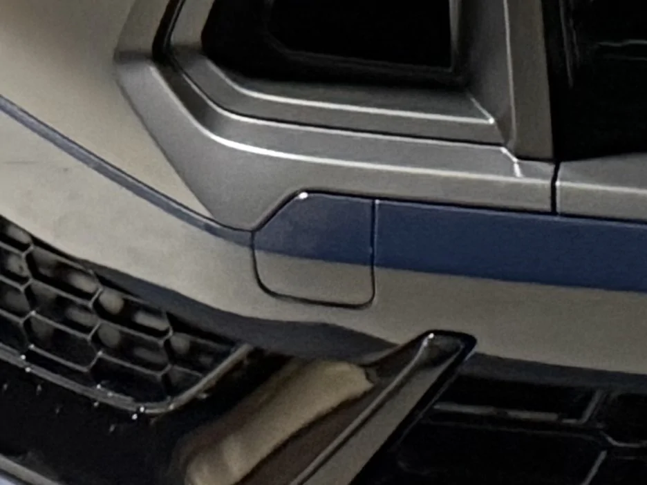

Good Morning Everyone,
Won't be long before the snow is all gone and we can get the wild horses out to stretch their legs.
Need a little help with the removal of the tow hook cover.
Any good tips for removal that won't scratch the paint.
Cheers

I used a plastic trim removal tool.

X2 on the plastic trim removal tool. It doesn't take much to pry it off and the tether will prevent losing it if it there's no tow hook installed.

Going to do this over the weekend. The manual says to pry from the bottom of the cover, so I'll be putting a pry tool at the bottom to pop it off.

I like to disassemble things.
Just push the right side of it with your finger.
