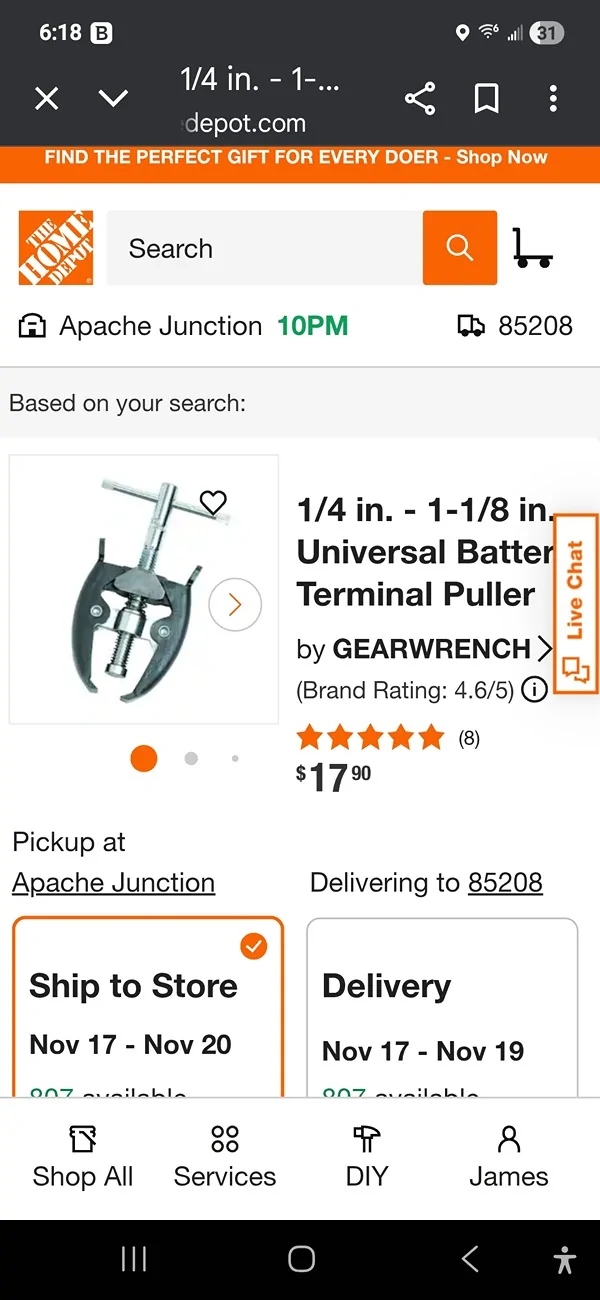

Nice, handy looking puller you have on top of the battery. Where did you get that tool?
Thanks, FD

Maybe this one?
Might be able used to pull wipper arms also.

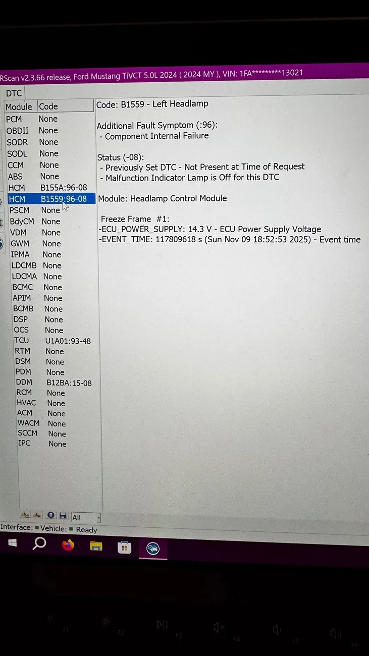

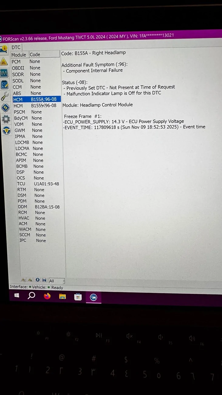

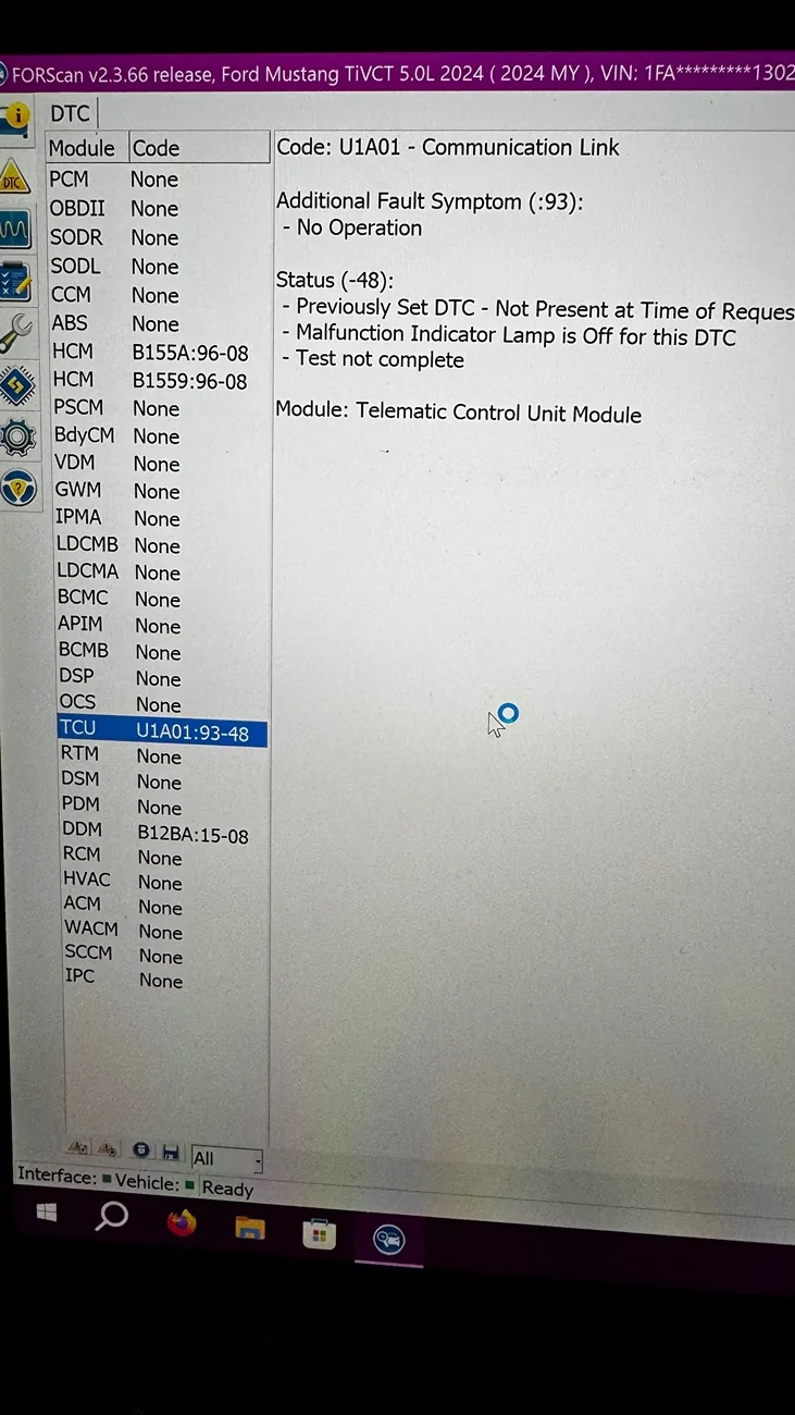

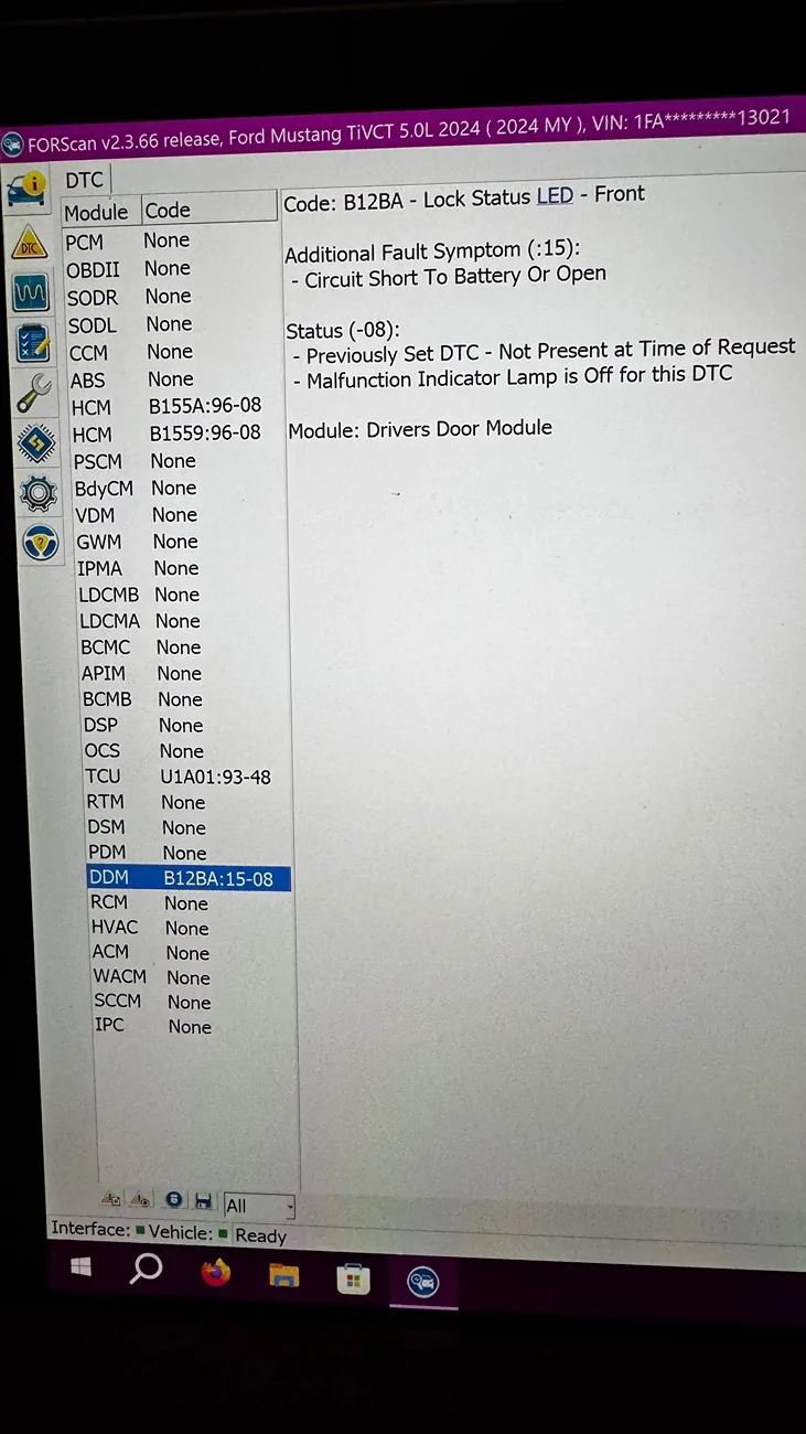

Yea, I meant with FORScan or a code reader. Check for any codes in the TCU or GWM that can be atributed to connectivity issues.
i found all these errors I cleared them went for 2 mins ride and checked again but didn't appear

Well, the TCU code was relevant, but it a stored code and not an active fault at the time you checked. Unless it's intermittent and coming on and off?
yea it happened 3 times by now first time it stopped working after 1 week it worked for a day then 2 or 3 weeks not working then worked for a day then stopped again and the third time started working a week ago for a day as well and stopped

Check the connections at the TCU would be my best guess.
