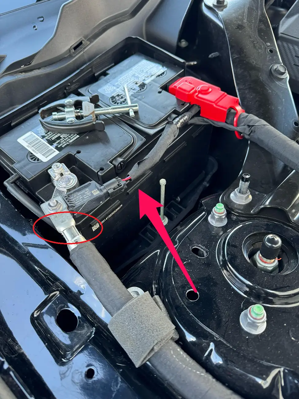

I have ordred a battery charger should I hook it up to the battery directly ? it is my first time using one
Connect the negative cable for the charger here (circled in red) and not directly on the terminal. If you go directly on the battery post, it will bypass the BMS sensor and mess the BMS data.
thank you i will do this
