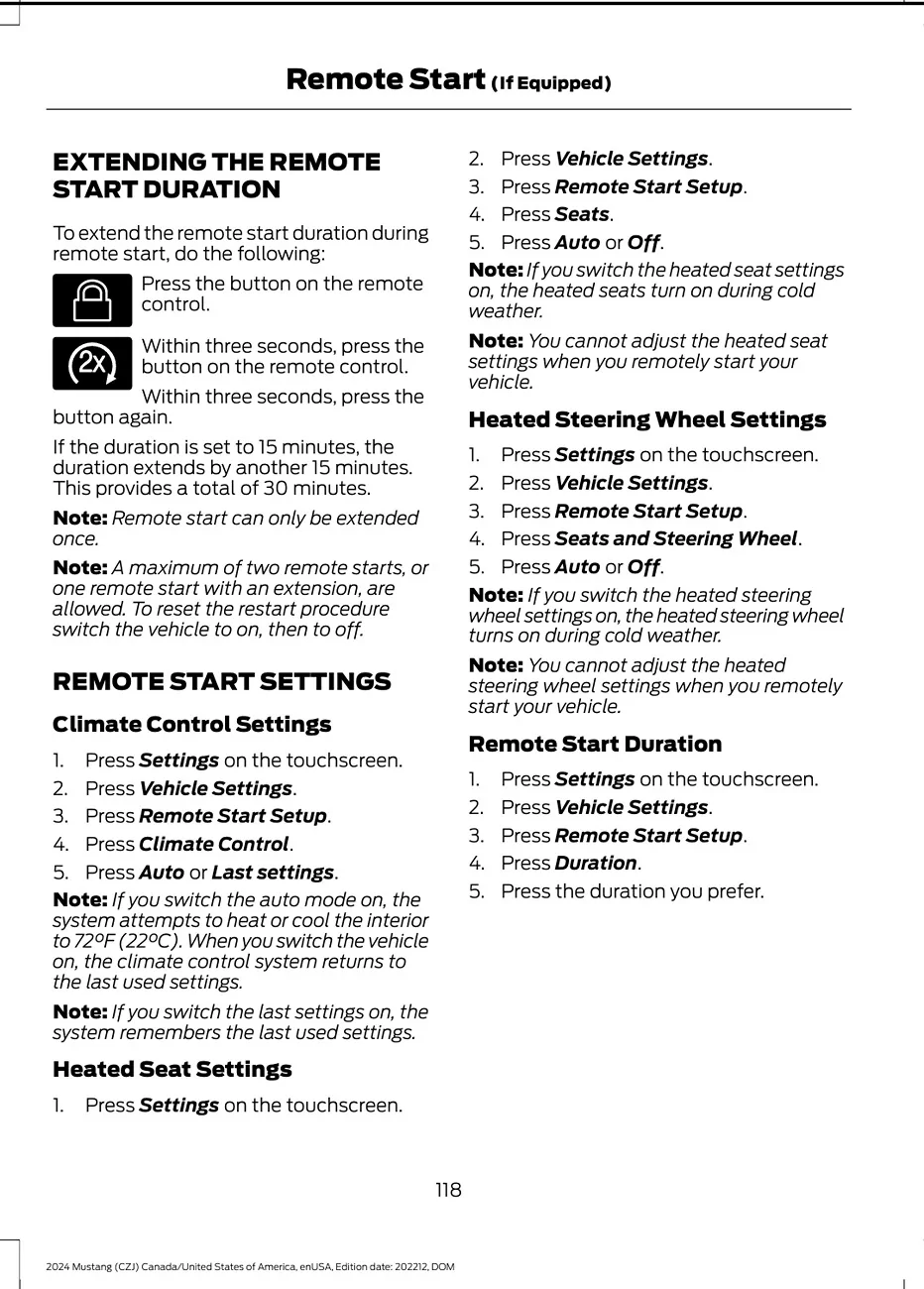

page 118 user manual
REMOTE START SETTINGS
Climate Control Settings
1. Press Settings on the touchscreen.
2. Press Vehicle Settings.
3. Press Remote Start Setup.
4. Press Climate Control.
5. Press Auto or Last settings.
Note: If you switch the auto mode on, the
system attempts to heat or cool the interior to 72°F (22°C). When you switch the vehicle on, the climate control system returns to the last used settings.
Note: If you switch the last settings on, the
system remembers the last used settings.

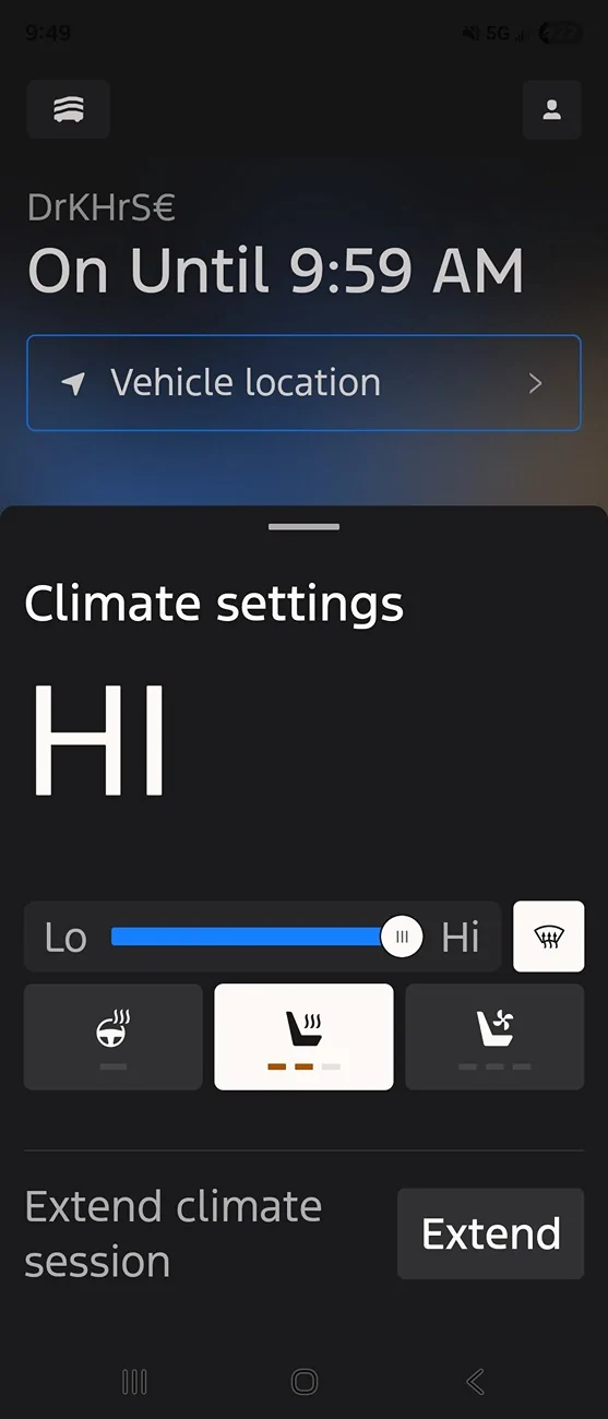

In the ford pass app you can control what settings you want. I thought the OP was talking about ford pass app specifically. On mine it has a slider bar for temp and buttons for seats either heat or cool. Otherwise it will use last settings. I haven't tried using the key fob to remote start yet so im not sure about that.

Interesting. I dont not have those settings in my Ford pass app. Can you post a screenshot?
@steveo1960 beat me to the question. A screenshot is needed and I’m on the ”Beta” user program.
