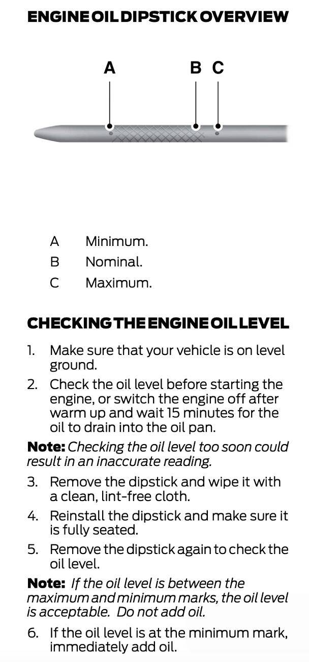

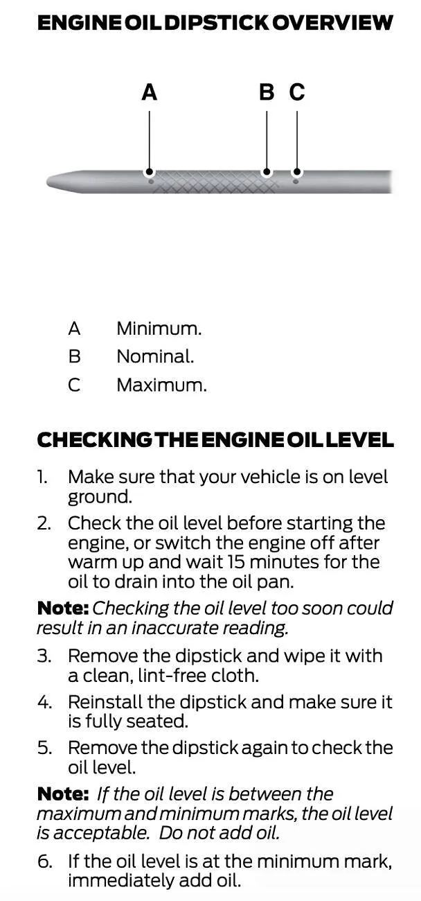

Everyday, once a week? I'm not sure if you caught the beginning of my post but I checked the engine cold after sitting overnight. Should I stay with that way of checking or do it after running and letting it sit 15 minutes?
S650 Mustang Factory Oil Slightly Low? Screenshot 2024-12-18 at 2.44.36 PM

I will be checking after a 15 min wait to see if it differs from the cold reading that I took initially for this post.

My photo is a little blurry but at most the motor is half a quart low. A full quart would definitely put it over the max line. I wish there was data out there to list all of this. Part of me wants to add oil and another part of me wants to leave it alone and monitor.

I will be running the car up to temp parking it on level ground then checking after 15 minutes and reporting back once I get the car friday.

Going off of memory you have about 400 miles and drive 40 or 80 miles a day. Since you didn’t set the baseline when you got the car, it’s safer to assume it was full top from the factory and you lost half a quart in 5 to 10 days. That’s alarming if true. Therefore test it everyday for the next 5 to 10 days and see if it’s stable or decreasing at a rate beyond what Ford would deem is normal. Try it hot at night when you get home and cold the next morning. And document your findings (take pictures every day). If it’s really consuming that much, buy a quart and refill at the lower mark up to halfway and restart the monitor process. Thats what I would do. It’s hard to go off of a static sample with nothing to compare, so create this dynamic analysis.

Yes I drive 30 miles one way for work. And beside other short trips around town that’s all I have done with the cars. I have heard of cars being low from the factory so I wouldn’t be surprised if this was the case. Does checking it after running do anything different?? In terms of the level.
