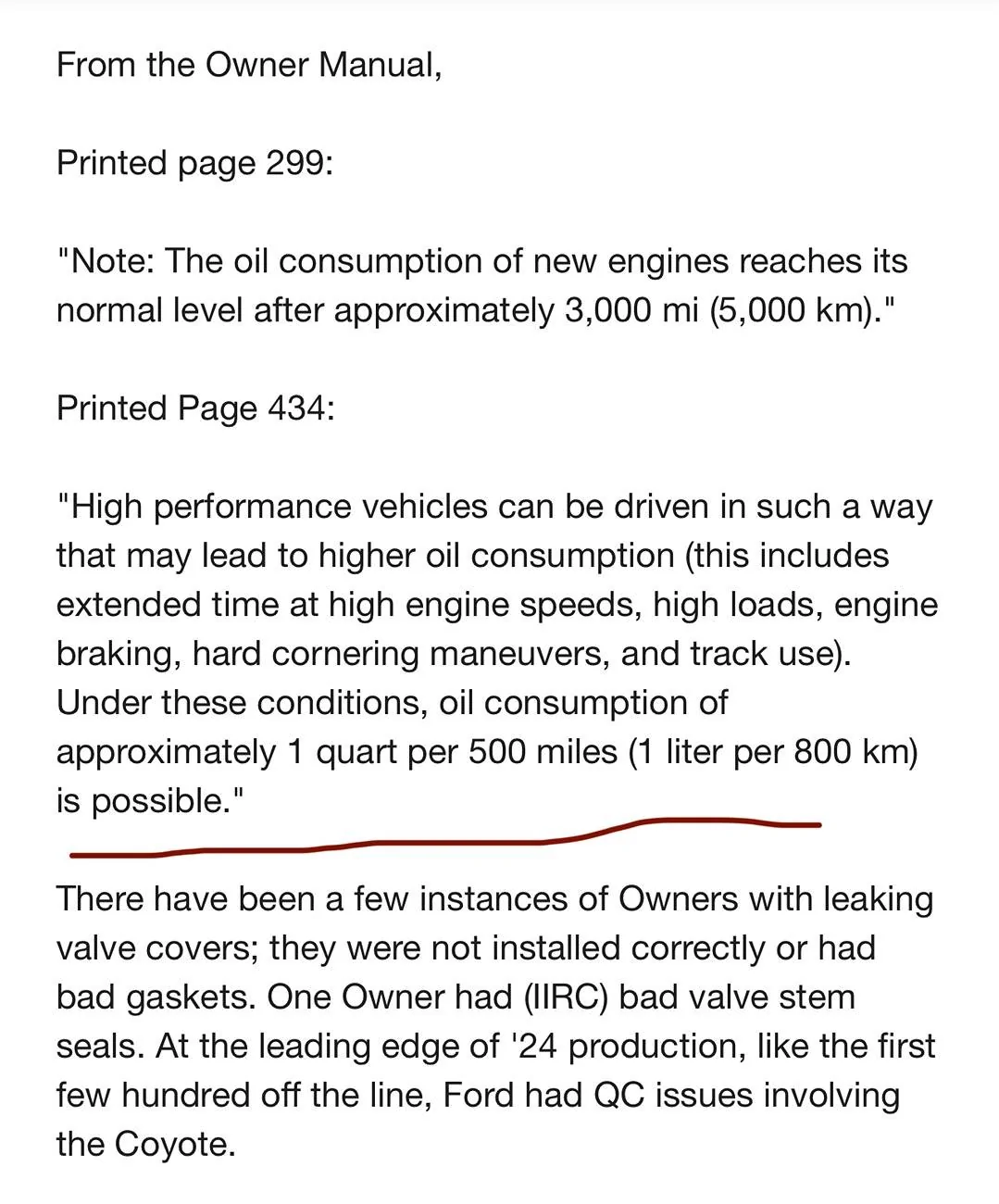

I’m going to have to go and find that in the manual. My speeds to work are around 80-85. I don’t know if that is considered high engine speed. I have been varying how I drive the car going through the gears etc. Not just steady state driving to assist with breaking it in.

Yes I drive 30 miles one way for work. And beside other short trips around town that’s all I have done with the cars. I have heard of cars being low from the factory so I wouldn’t be surprised if this was the case. Does checking it after running do anything different?? In terms of the level.
Not here to guess, it’s better to know since you’re either perfectly within spec (9.5 qt factory fill) or are in a bad spot (10 qt factory fill and burned half a quart in under 500 miles). This is becoming like Schrodingers cat. I’m advocating that you check it hot when you get home at night and cold before you leave the next morning and record the results.
I’ve always checked mine cold. It came full top and seemed to burn about a qt in the first 3k miles linearly (i.e. not mostly in the 500 miles).
Also, it would help to know if you see any smoke out the tail pipe. That could be telling too. You want to know if this is a serious issue before telling Ford it is resulting in them having to bore scope the cylinders, recommend an engine replacement, etc.
Again, you have one data point. Half quart low at 400 miles. That is meaningless information. Make it meaningfull with a time series analysis.

TheGrabberBlue - You've taken the worst case scenario road without any evidence pointing to an issue.
1. You can safely add small amounts of oil at a time until you get the level up to the top dot (not maximum). There is absolutely no harm in doing so. If you choose to do this do so on a warm engine. Add a little wait 15 minutes and recheck and so on until you hit the desired level. A warm engine will help the newly added oil drain down to the oil pan faster.
2. Ford Owners manuals are written for non car enthusiast. Ford says do not add oil if your oil level falls between the lower and upper limit to avoid overfilling by gung-ho types.
3. Addressing the 9.5 vs. 10qt. change in specs. To me this means you'd be safe down to 8.5 qts. with the new 9.5 spec. And down to 9 qts. with the old spec. Your still safe regardless of either.
4. I get the fact your concerned about excessive oil consumption within less than 400 miles. Problem is you have no evidence of any oil consumption.
5. I would bet your car was delivered with this amount of oil. The dealer probably checked the oil prior to delivery to you. Techs do not have time to wait 15 minutes prior to checking oil. Warm engine, shut down, oil check, probably showed slightly below upper limit which means the tech said good-to-go.
6. Geez! :like:Enjoy your new car and monitor from this point on. Panic when called for which is not now!
