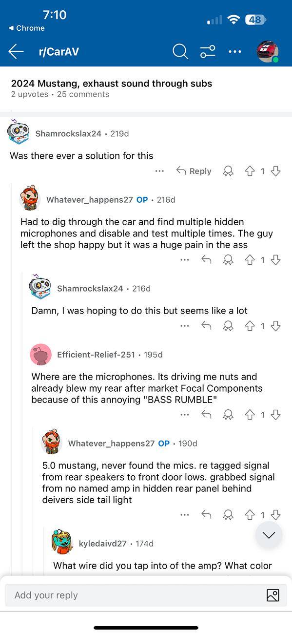

I just had 2 subs installed in the trunk, whenever I have music on or off it doesn’t matter I’ve tested both ways. If I’m at low RPMs like accelerating from a fresh green light my subwoofers seem to start emitting bass, even if I have no music playing and it only happens when I initially accelerate I think it has something do with how our exhaust is fed through the sound system? So my subwoofer picks up the deep grumble frequencies and starts rumbling. I was wondering if I can turn off the exhaust sound being linked to the sound system in the car

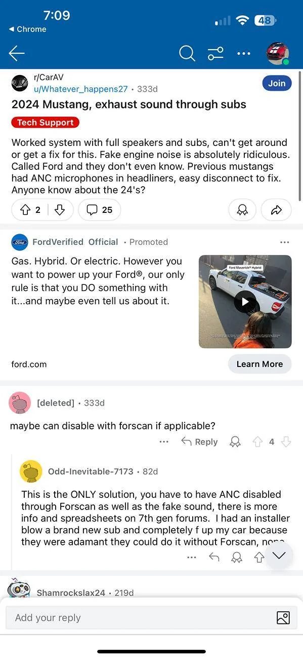

I checked on Reddit and other people have a similar problem to mine
