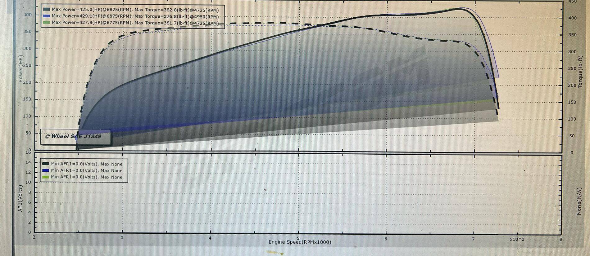

Waited until 11k miles. Car is stock except a Borla S-type cat back system.
Here are the results. I do not have dyne info before the exhaust installation.
91 octane. Temperature outside 20C , humidity bellow 50%. DynoCom 7500

very nice numbers. what brand of dyno?

amazing numbers! Gen 4 is fantastic thus far. Ford underrated these engines from factory for sure!

429hp
480hp stock, add 5hp for the Borla like you would get with the Active Exhuast
That's 11% drivetrain loss, so that's pretty close. Underrated by 3%? Remember a lot of S550/Gen 3 coyotes also dyno in the 410's and 420's
Dynocoms usually read a little high as well.

Correct me if I’m wrong, is there typically 15-20% drivetrain loss?

12-15% on a modern RWD car, not 20%. That would be more like an AWD car or an old RWD with a TH400 and a big converter. Drivetrains are a lot more efficient these days.

dynos are weird things - you can totally manipulate the numbers....
first part of my career I worked in the performance aftermarket- we had multiple types of dynos- forget the names but Mustang Dyno was 1 - the other you could create resistance/ more real world
I remember during open houses- we would show all the ways you could manipulate the results on a dyno pull ....and different brands of dynos definitely create different numbers....
I remember on cars making 300rwhp we could create 25-35hp swings in dyno results by just changing the way we dyno the car- hood up vs hood down- time of day- fan vs no fan - I forgot all of them - we also would see huge swings between the different types of dynos
We did it to show dynos are cool for tuning- but even for direct comparison - you could dyno a car in the morning - install parts- dyno again in afternoon and show no gains just because cars make more power in the morning air ....all sorts of crazy stuff
you cant compare dyno results on two different days- two different cities- exc exc exc
and definitely no 20% loss on a modern Mustang-- Ive seen GT350s dyno in the mid 460s which would mean 575hp lol
