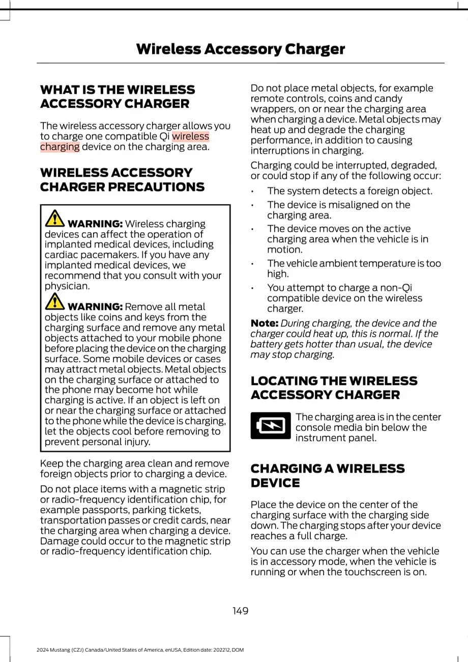

Read the owner's manual on wireless charging and it's easy to see why they dropped it.
