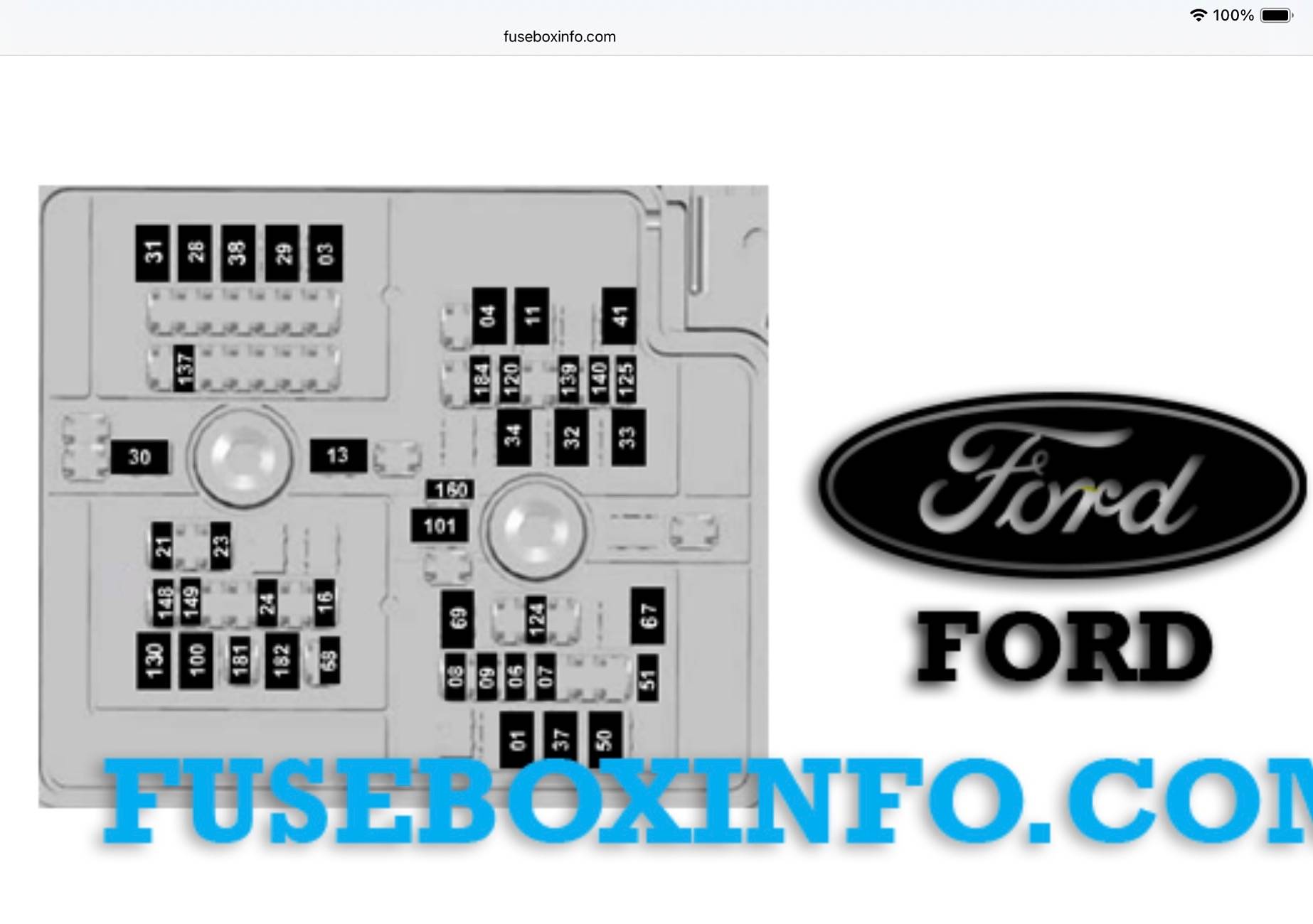

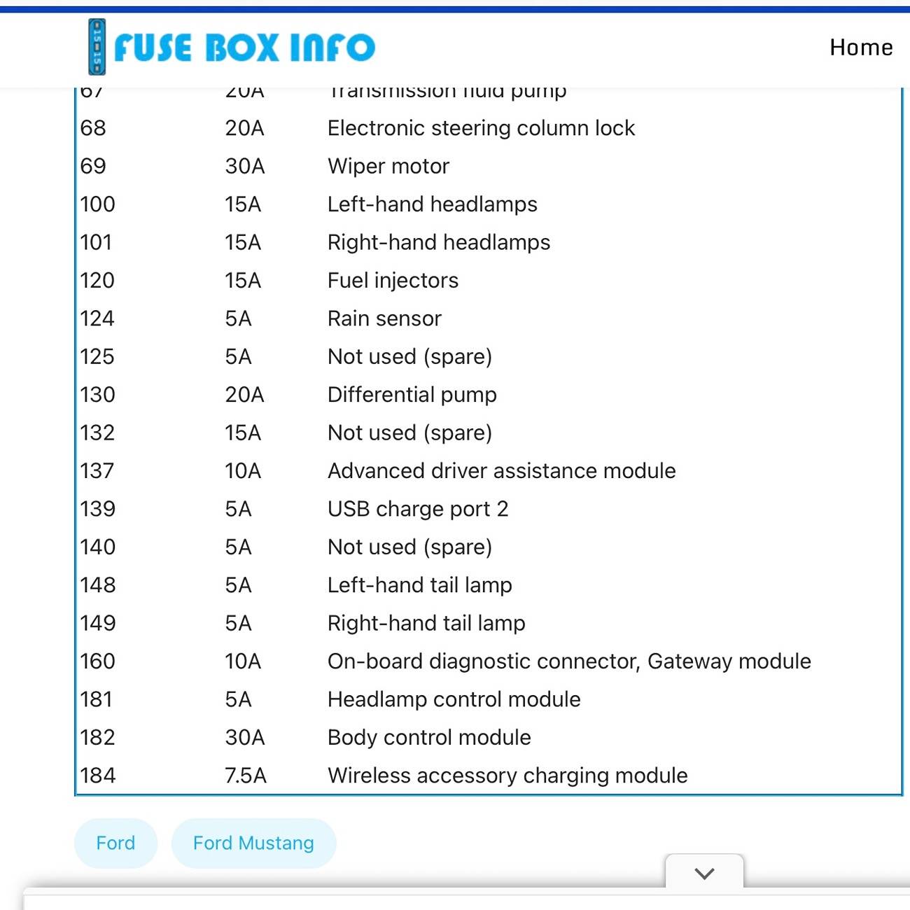

If somebody know how to turn off wireless chrager, let me know. My iphone 16pro max is always to hot when it place on charger pad.
