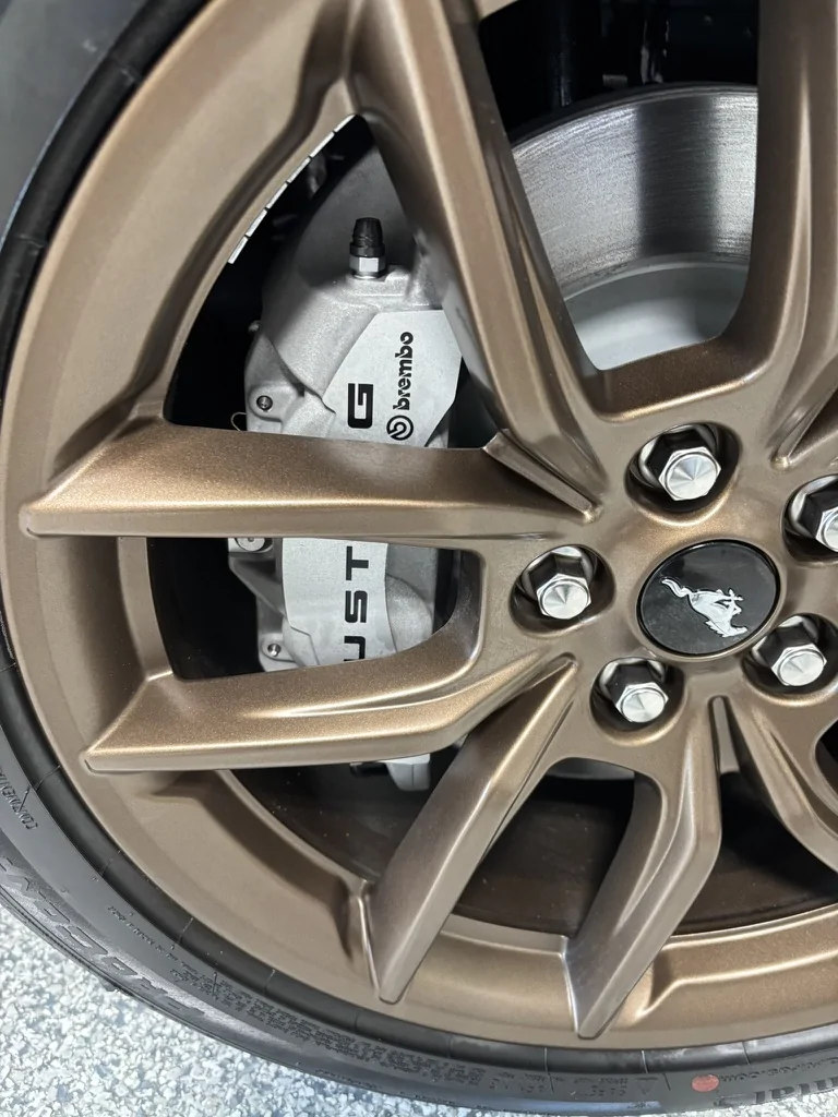

So I'll go on record posing what might turn out to be a really dumb question.
I'd like to add a spare tire kit -- and when choosing one, it matters whether you have the "Brembo Brake Package".
Well, what I do have is:
2026 GT Premium 401A -- USA spec
19" wheels (Bronze Appearance Package)
No performance pack
No "upgraded" brakes (meaning -- standard brakes)
Seems clear, right? But -- my calipers actually say "Brembo" on them.
So, are the upgraded Brembo brakes standard on my GT? Or, are the standard brakes also marked Brembo, and they are just smaller than the "big brake Brembos"??
Thanks guys. And, go easy on me if the answer is "you have the Brembo brakes dummy, they're printed right on them!!" šŸ˜Ž
Cheers!

Looks to be the 4-piston up front and the 2-piston (standard) out back. Compared to my package, 6 pistons up front, 4 pistons rear.

Its a little confusing because all GTs come with Brembo brakes standard. The "upgraded" Brembo package has larger 6 piston brakes and colored calipers. That Brembo package is optional on all GTs, and standard on Performance Pack cars.
So no, you do not have the upgraded Bembo package, and do not need a special spare to fit your brake calipers. šŸ‘šŸ»

Just as a future reference, if you have silver brake calipers, you do not have the upgraded Brembo brake package and don't need to make an order for parts that include the Brembos.
Gentlemen: that is super clear, concise, and helpful. Much appreciated!! šŸ»

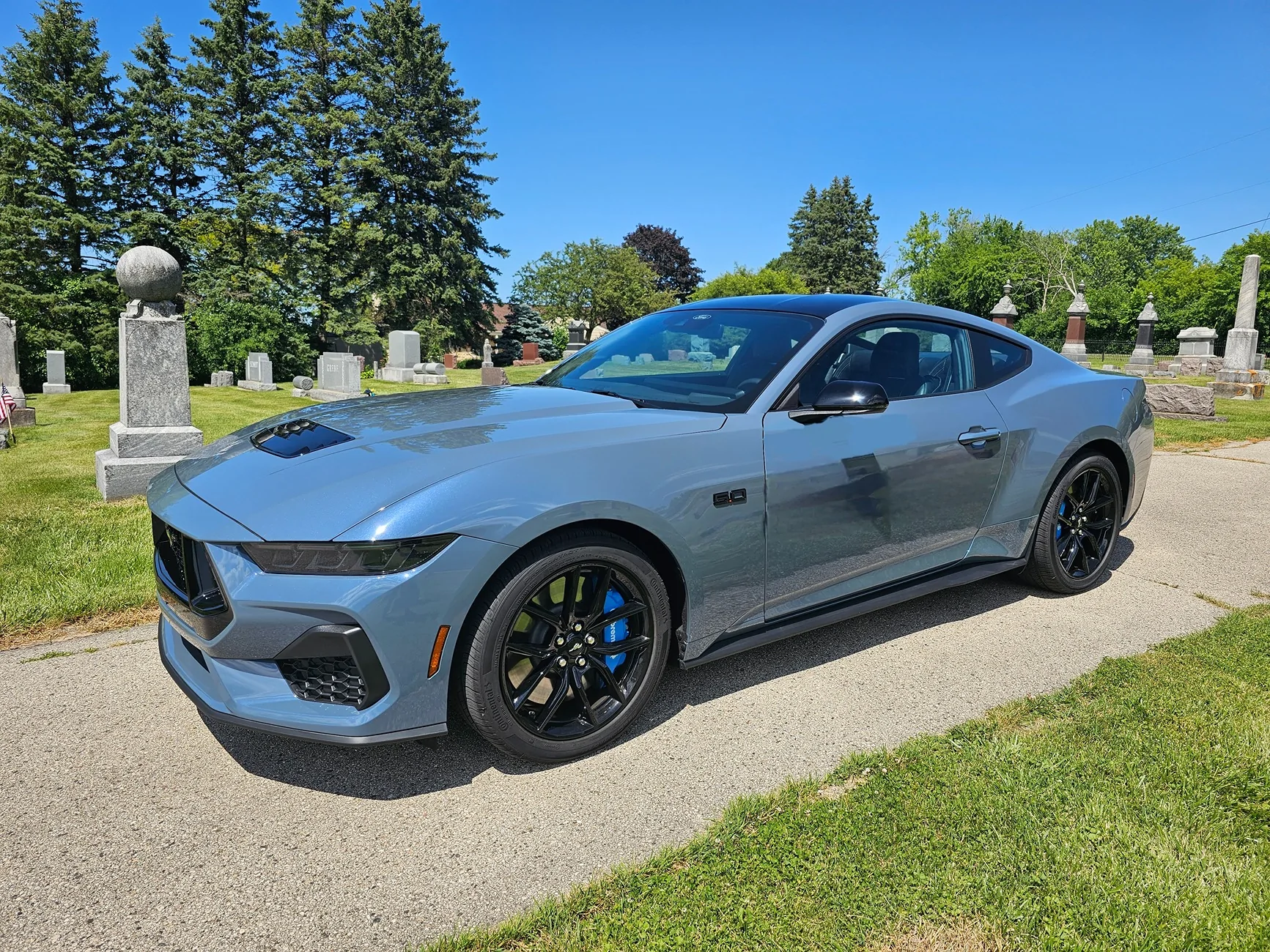

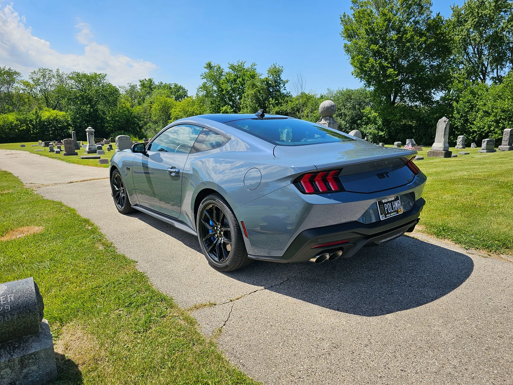

Here's our non-PP car with the upgraded "BREMBO" brakes and spoiler delete.
