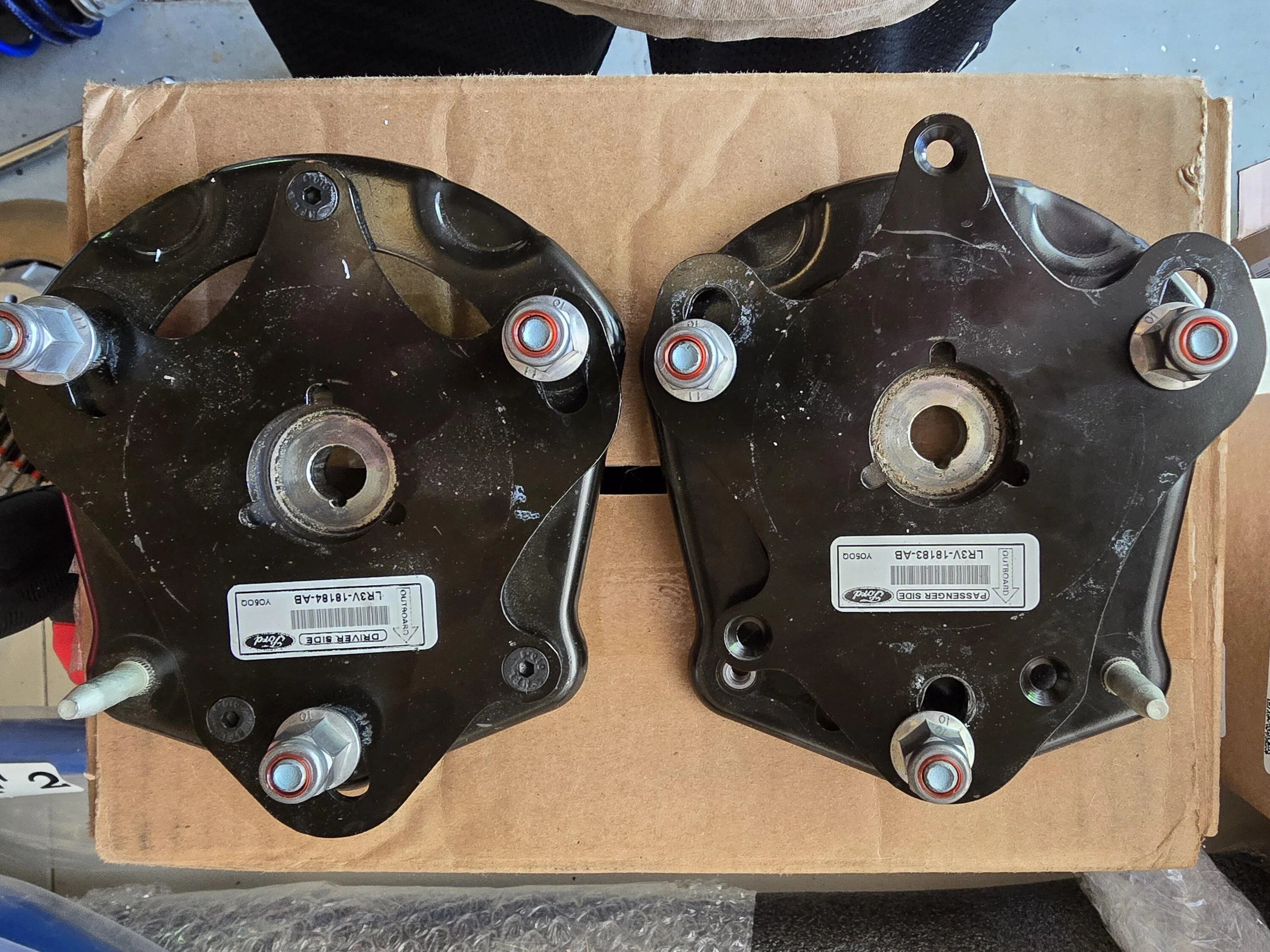

Installing the Steeda Nurburg Package on my Dark Horse so I have my suspension apart right now. If you're curious how the stock handling pack strut mounts are adjustable, here's a picture to demonstrate. The strut assembly has to be removed from the car to remove the 3 allen bolts.

Does the strut assembly have to be removed in order to make camber adjustments?

Only the first time to remove the flush mount allen bolts to give access to the adjustability.
