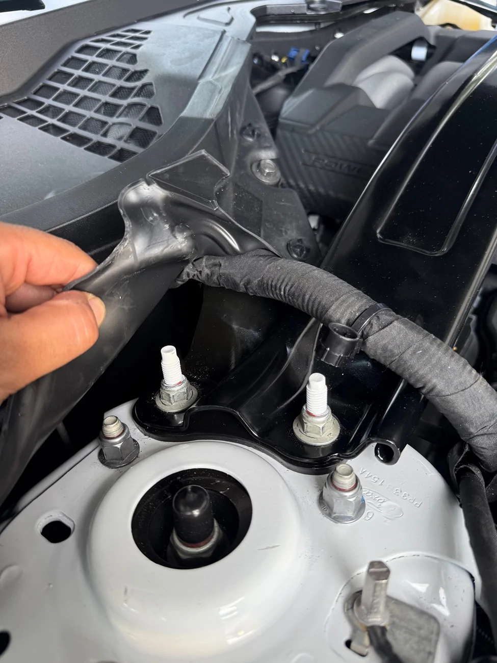

I did it too, while taking one of the nuts off to install an air/oil separator. All were previously torqued to 41 ft lb when the brace was installed. Needless to say, I was not happy with myself after that. I took it to the dealer, who fixed it by drilling out the stud and tapping new threads for a bigger bolt in place of the broken stud. This seems to be a common issue with Mustangs all over the internet, so hopefully Ford can beef these things up in the future.

I took it to my dad and we worked on fixing it together. It turned out to be pretty challenging — we actually broke two drill bits trying to get through that stud. It took us about 2–3 hours, but we finally managed to get the hole drilled.
I ended up buying an M10 stud from Advance Auto, painted it, and made it look just like factory! And yes, I did use the nuts that came with the brace.

Happened to me too! Ended up having new tower welded in.
i mean thats crazy do what he did drill it out and put a bolt and waster through it
or weld in a new stud
not replace the entire tower to much risk.

I guess it’s a good thing they are only studs the tower brace mounts to. You think maybe some studs come weakened from the factory welding process?

My 2025 GT performace already embodied strut tower brace. I am not a specialist mechanic, but i think that the studs are a little weakened cause in case of crash in a side the stud "auto shear" and the forces don´t damage the other side strut. I´m very very happy with my GT with a delivery a month ago.
