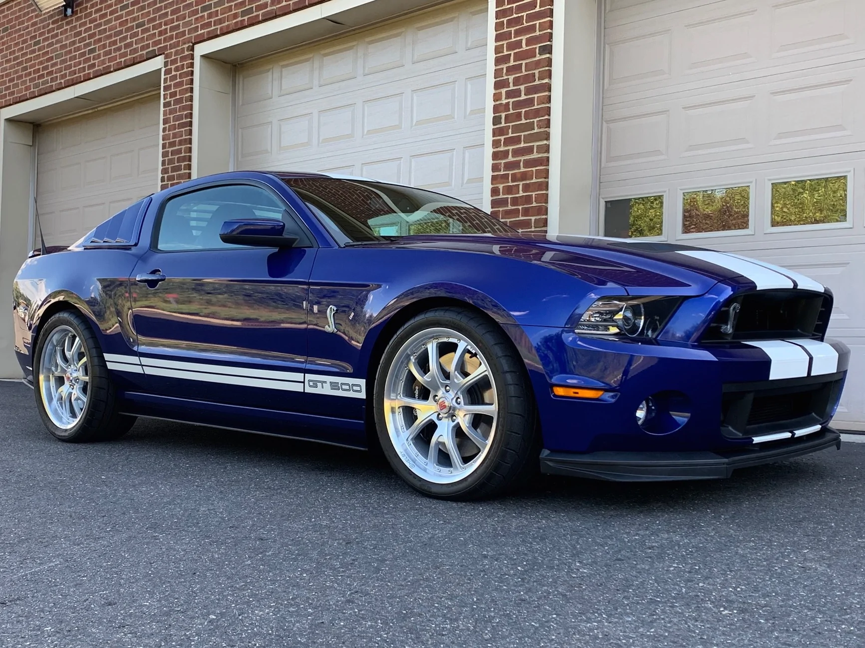

Ugh, I went through all my pictures and they must be somewhere on my old PC? I only have my stock setup photos and the photos of the wheels/tires in the boxes while I was in the middle of parting the car out prior to selling it. I'm actually bummed I can't find any ON THE CAR because the setup looked KILLER.
S650 Mustang Big/tall tires? Sweet
My car had a near EXACT setup to this one. Same 20x9 + 20x10 CS40 wheels (including the finish)...the only difference is, I had a Sterling Gray GT/CS (not a GT500) and my rear tires were 295 (this car has 305 rear). Nearly IDENTICAL stance, though.
More pics here, if you want:
2013 Ford Shelby GT500 Coupe 20th Anniversary Stock # 222969 for sale near Edgewater Park, NJ | NJ Ford Dealer

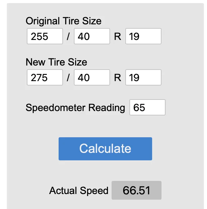

Can't you adjust the tire height in Forscan?
18 vs 20 inch wheel doesn't necessarily mean anything, the overall tire height which is what counts
Plus, even if you go with a taller tire (0.7 inch in this case, 27" vs 27.7"), your speedo isn't off by much
https://tiresize.com/speedometer-calibration/
S650 Mustang Big/tall tires? Screenshot 2026-02-09 at 1.14.56 PM

I ask because for a bit now my Waze App has shown me consistently driving 2-3 mph faster than my speedometer does; researching (e.g., a google search) shows that Waze has a margin of error in the 2-3 mph range, so I wasn't too worried about it.
Waze is more accurate than your vehicle's speedometer, and it is also more precise, which means that the margin of error is less than your car's dashboard display.
Federal regulations (49 CFR 393.82) permit factory speedometers to have a variance of 10% higher or lower than the actual speed, but most factory calibrations err slightly on the high side, as erring on the low side could cause a lot of consumer complaints due to speeding tickets.
