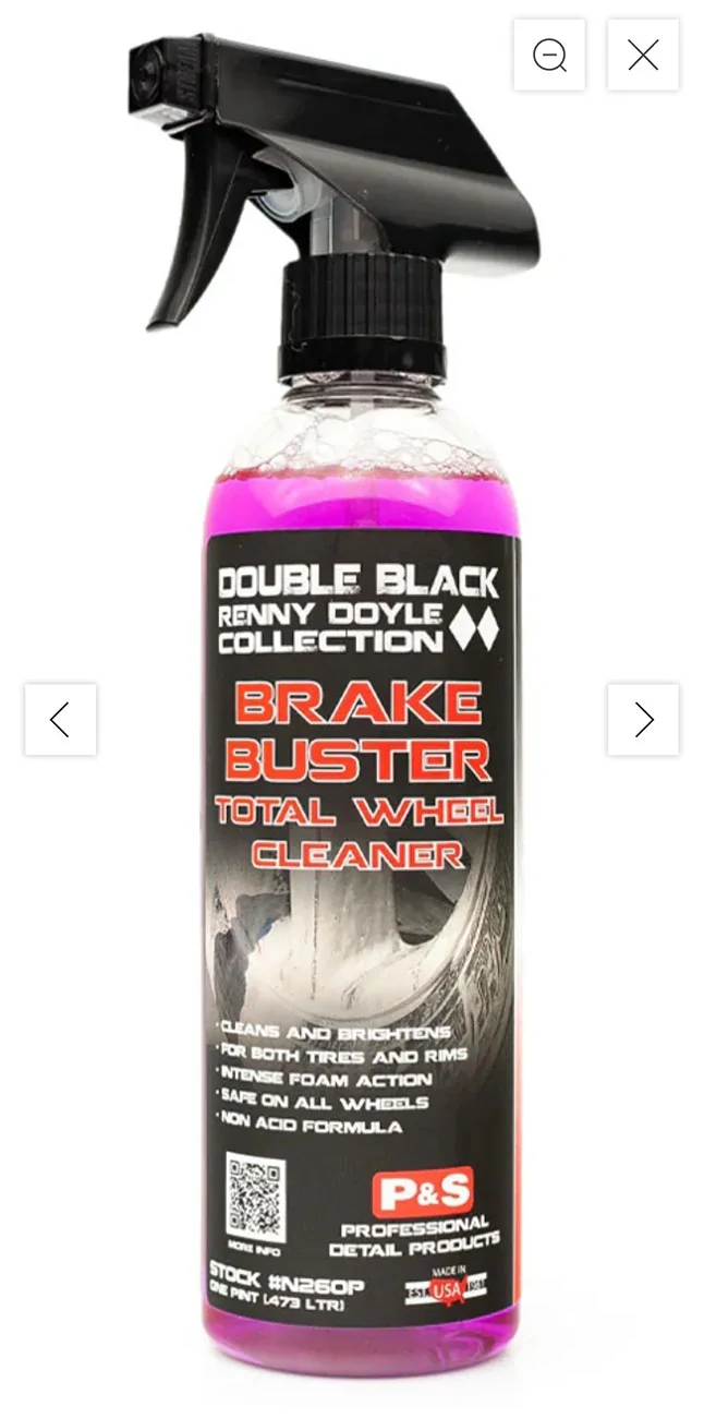

Most pro detailers follow these steps.
1. Use some type of all purpose cleaner/iron remover/wheel cleaner if the wheel has not been coated. I typically use P&S Brake Buster for tough caked on brake dust if the wheel has never been coated. Use some dedicated type of barrel brushes to get inside the wheels, otherwise use a flag tipped brush for cleaning the wheels, they are generally safe on painted wheels. The key is getting the wheels clean, the more complex the wheel design the longer it takes to clean them, but you want them good and clean. Scrub the tires with a good stiff bristled brush, you don't need to remove all the brown as that is actually a protection from ozone for the tires.
2. Once they are all cleaned up you have some options. If you want to do a true ceramic coat like you would do for paint (the stuff that comes in the tiny glass bottles and costs anywhere from $50-$150) then its best to remove the wheels and thoroughly clean them before ceramic coating. The easier method is to use one of the spray coatings that is water activated. They don't last as long as a true ceramic coating, but much easier to apply. Gyeon WetCoat, DIYdetail Quick Beads, Carpro Hydro02, and a bunch of other products from many vendors. Spray it on, make sure to get all the surfaces, wait 10-15 seconds (or whatever the directions say) then hit it with some water pressure, garden hose with a sprayer works, pressure washer is better. You will see the water bead off. Use a good tire protectant/detailer on the tires. Tip: use a flag tipped brush to apply your tire dressing, works great. Spray the dressing on the brush and use it to apply the dressing.
At this point it will be much easier to clean you wheels, most of the brake dust will just rinse off and you can just use car wash soap on them, no need to use any brake dust cleaners.
