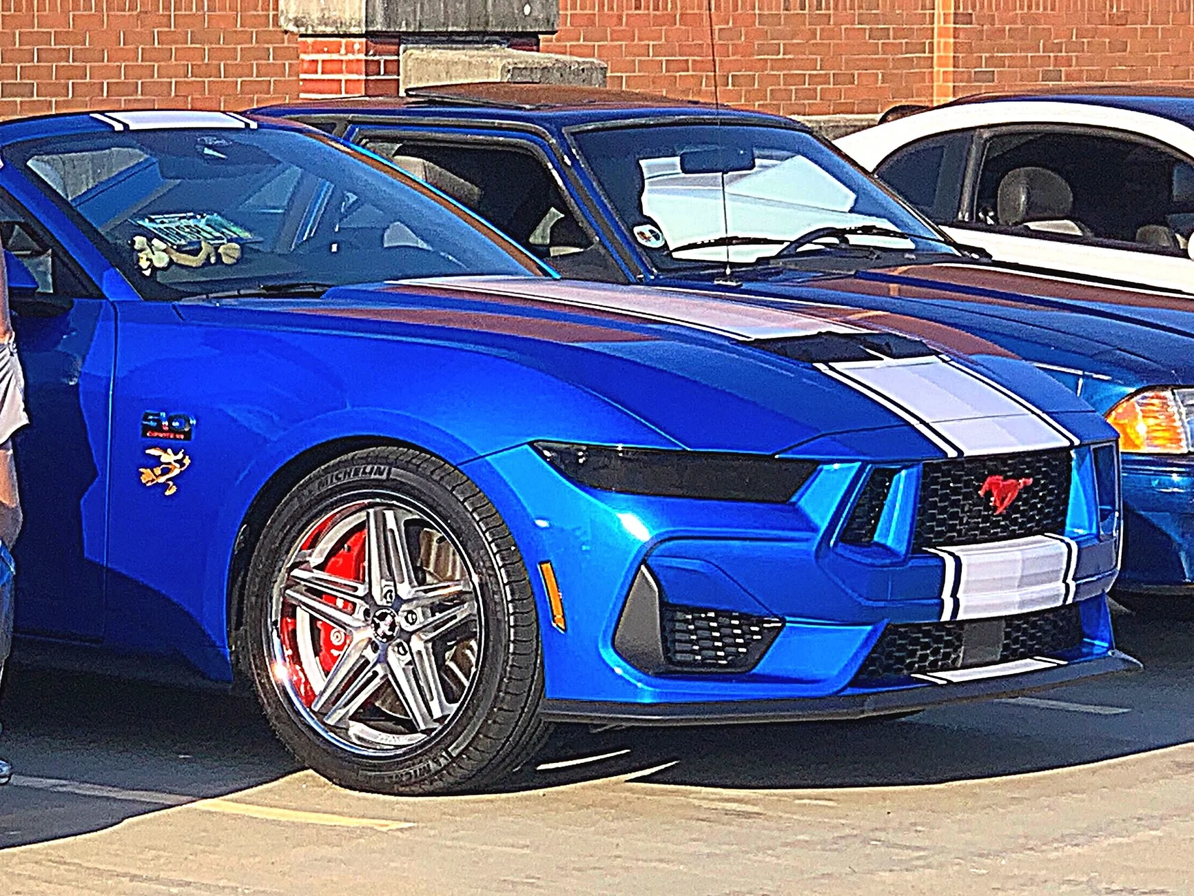

I have the big performance pack Brembos, which seemingly shed brake dust just sitting still at a stop light. My aftermarket wheels consist of part powder-coated paint, part brushed aluminum, and part actual chrome.
The most important thing is to use a ceramic coat (or similar) at least every year or two to make regular cleaning easier. I use Gtechniq C5 Wheel Armor, which sticks with me at least 2 years. Follow the prep instructions carefully. Doing it right makes regular maintenance a breeze.
Once done, cleaning is easy, and sometimes almost touchless. I also use the Adams like you, but I spray it on a cool DRY wheel. (Does it really tell you to put it on a wet wheel? You don’t want to let the product dry, though, so do one wheel at a time). I let it sit a few minutes, sometimes brushing a little bit if I know my wheels are especially dirty. Sometimes the chemicals alone are enough. Then I hose it off and USUALLY towel dry them (I have deep dish chrome that I don’t want it to puddle in).
The Adams is nice because I can do the wheels and tires at the same time, it’s safe on all my different wheel materials AND my brakes, and it’s thin enough to make a semi-misty spray for good coverage.
So…
A) Protect your wheels ahead of time with a ceramic, to make regular cleaning easier,
and
B) Use something for regular maintenance like Adams that is both safe and effective.
Wheel cleaning is pretty quick and easy for me now, even with such demanding brakes and wheels.
