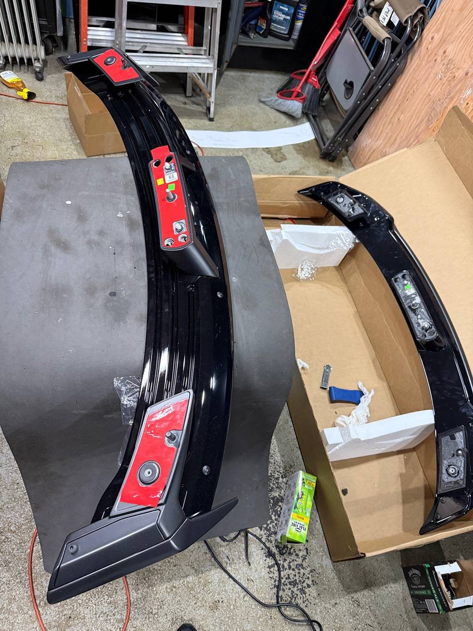

I got my spoiler today any tips on removing the tape?
98jfuentes
98jfuentes
Feb 16, 2020
138
150
Newark, New Jersey
Mustang Dark Horse

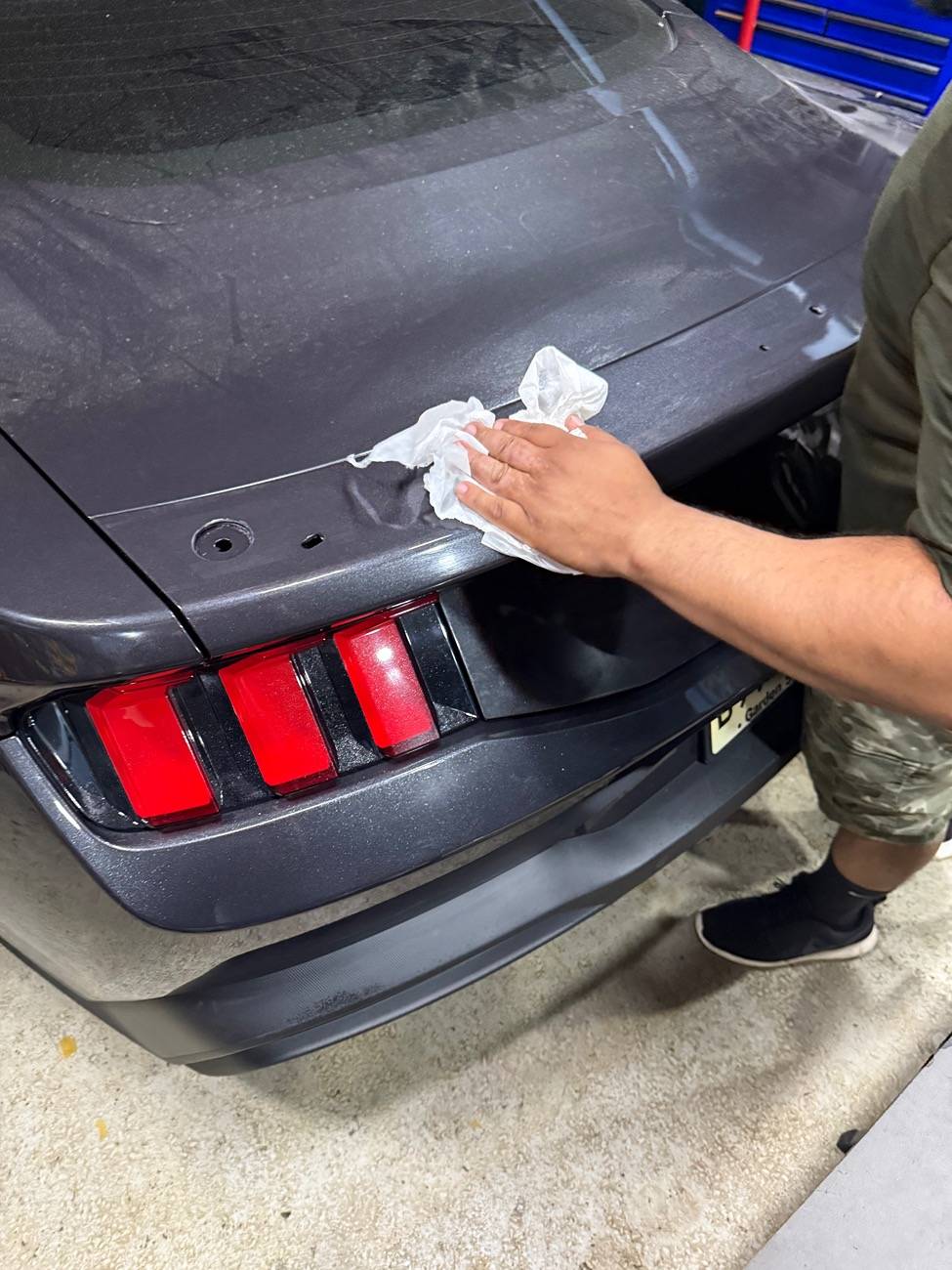

heat and friction. probably don’t need to remove the lower spoiler though. i thought there might be access bolts behind there.
I also use the trim tool to wedge between spoiler and lower spoiler
bee bop
Nov 1, 2013
305
187
Temple, GA
@mandersgt be careful about the paint on the Spoiler tray several people have had issues with it peeling off in small spots when removing the spoiler. I had two tiny spots peal at the edges under the old spoiler. You have to know where to look to see them. Also removing the spoiler out in direct sunlight helps heat up the tape and makes the removal easier.
mandersgt
Mar 13, 2025
Tacoma
2025 Mustang DH
Yikes okay thank you very much! I’m having a buddy who owns a body shop do it so I’ll give him the heads-up!
