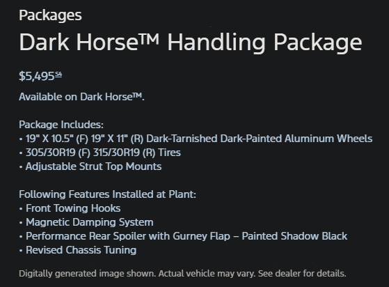

The differences are as follows:
So basically, you get different wheels, tires, additional strut mounts, front tow hooks, Magneride, a bigger spoiler with more downforce, and tighter chassis tuning.
magneride is already standard on the dark horse. I believe the Magnetic damping system for the handling package is just magneride but tuned for handling

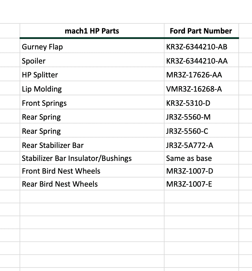

Thanks, i know the differences, but i need de Ford OEM part numbers for buy it.
Like this in the Mach1, but in the Dark Horse.
