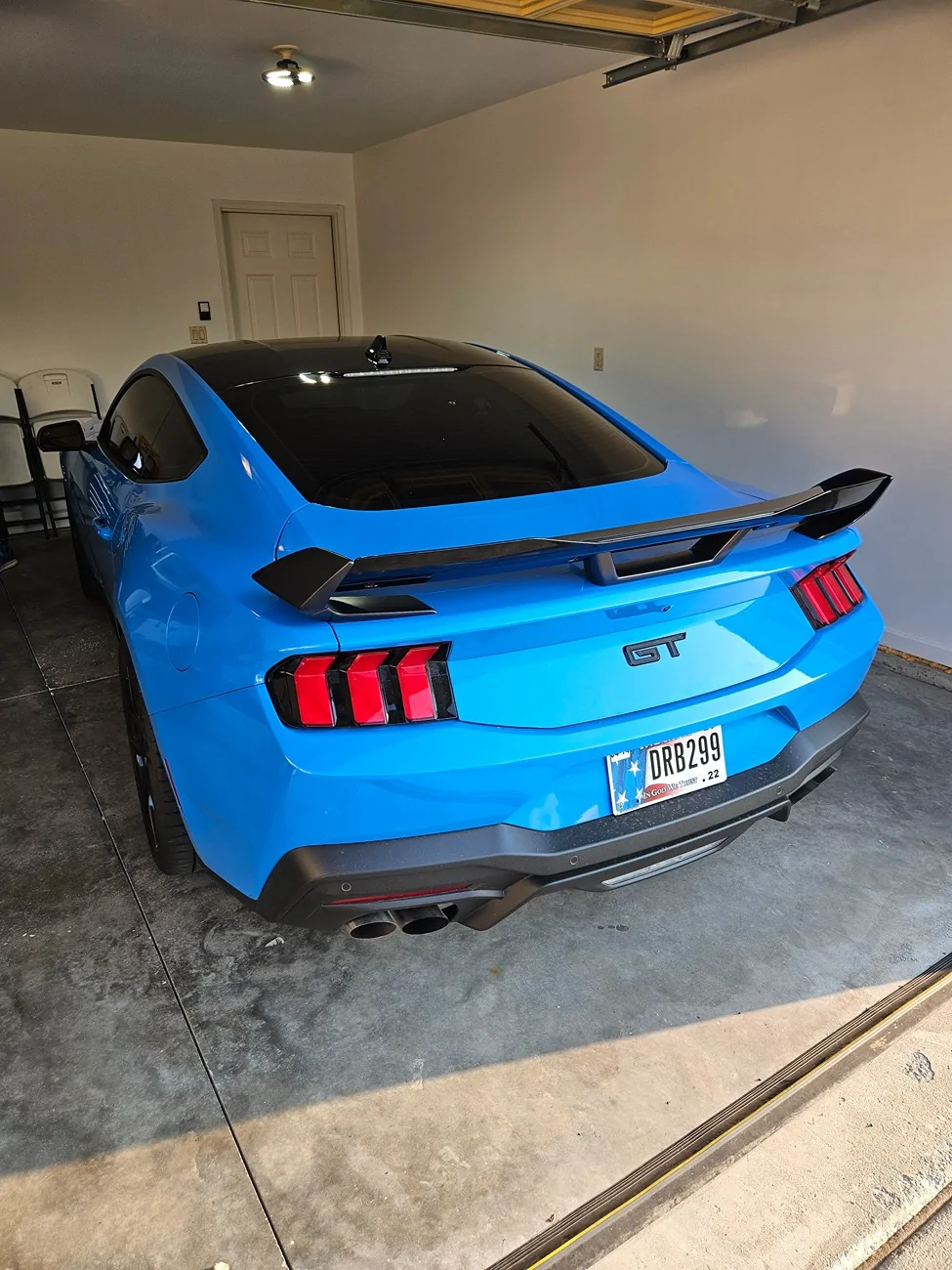

All I can suggest is when removing the stock spoiler, take your time with that 3M tape!! I rushed it with trimmer line and damaged the paint a bit from the abrasion, even though I protected the paint with masking tape.
Also-if prying up the old spoiler, be gentle…I pulled up too hard and broke the 3M tape bond between the trunk and rear trunk module the wing sits on. I didn’t know what that ā€œpopā€ sound was until I realized that trunk module was now sitting up a bit off the trunk.
In the end the old tape came off with rubbing. Goo-gone just made a mess.

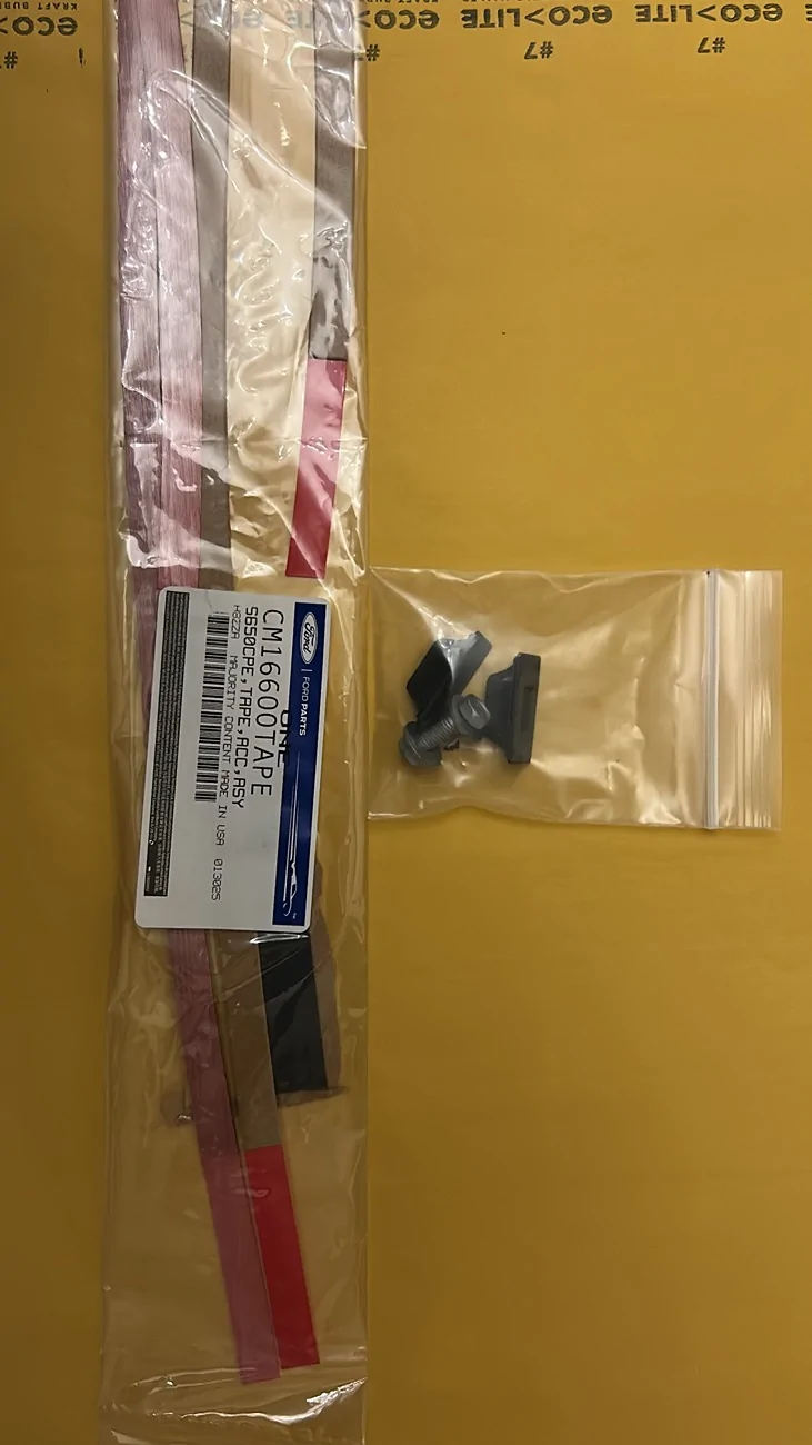

I have already received similar spoiler, just to make sure, how many bolts are included in the kit? I only received these. Also, I don’t know what these black things are used for /:
Yeah you don't need any of that for install. Just take out the 10mm bolt on each side and the rest is held on with double sided tape. I used fishing line to cut through mine. Getting the old tape off is a pain in ass.
