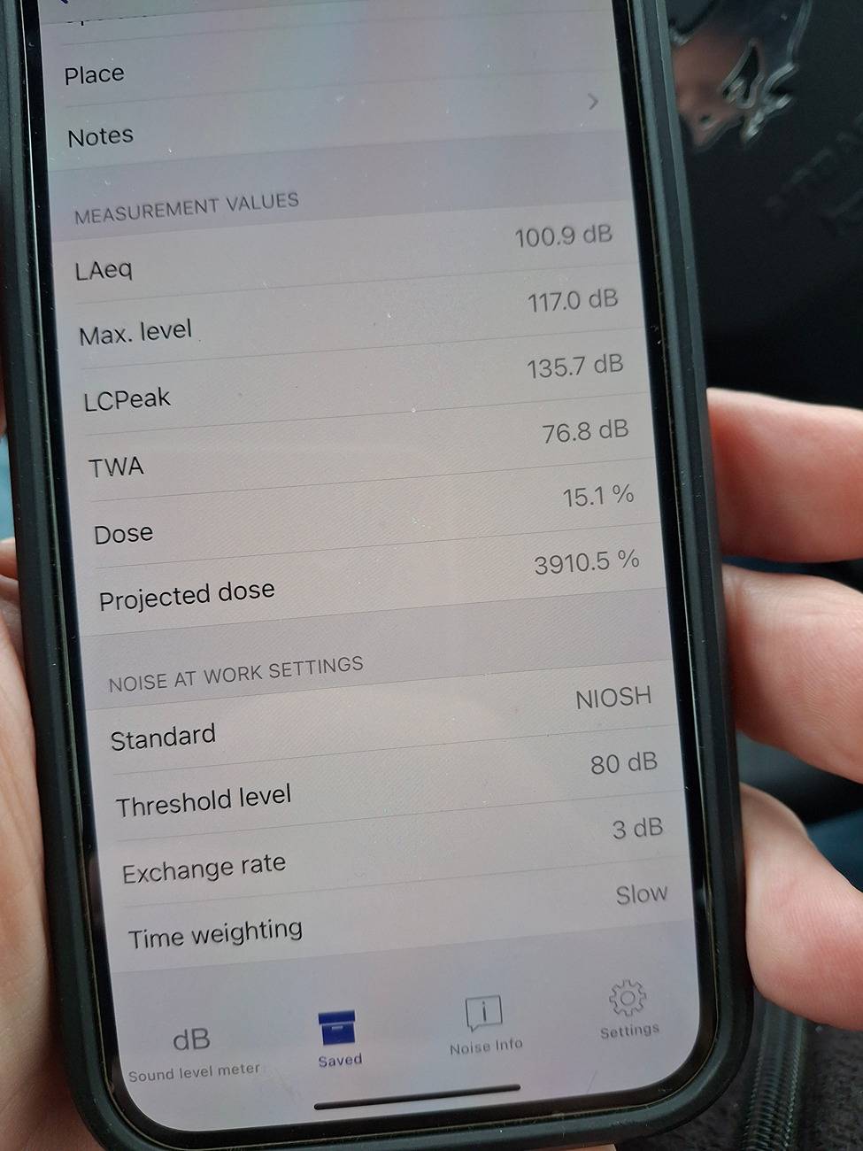

I hate to break it to you, but if you thought your Mustang would still start "quietly" after installing catless headers and an H-pipe, then I don't think the shop was the issue here.
I did the Lethal/Kooks Catless LT's and those first 30seconds of a cold start are BRUTAL.
I've measured +115db 10ft behind my car.
I'm going to add a couple resonators to quieten it down and deepen the tone.
