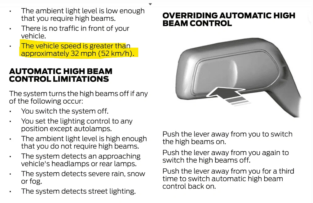

Not sure if it is technically auto high or auto low beam......Anyways......the 2 times at night I have driven it. Works great to start, then I slow down coming into town or tonight I slowed down coming off the exit. Auto is gone. I can obviously turn it to high beam or to low beam manually. The circled white A which means auto mode is gone too (which indicates auto high beam is active). Both my F150's have it, so I'm used to it. I get home turn it off and start it back up and it doesn't come out of it. If I turn it off, open the door and let the lights go off (like I'm walking away), I can start it up and it's reset. Not sure what the issue is, But It seems to be when I slow down it doesn't offer it anymore. I don't honestly care a bunch, BUT, I did pay for it, therefore it should work. Take it to the dealer or has anyone had this happen?
