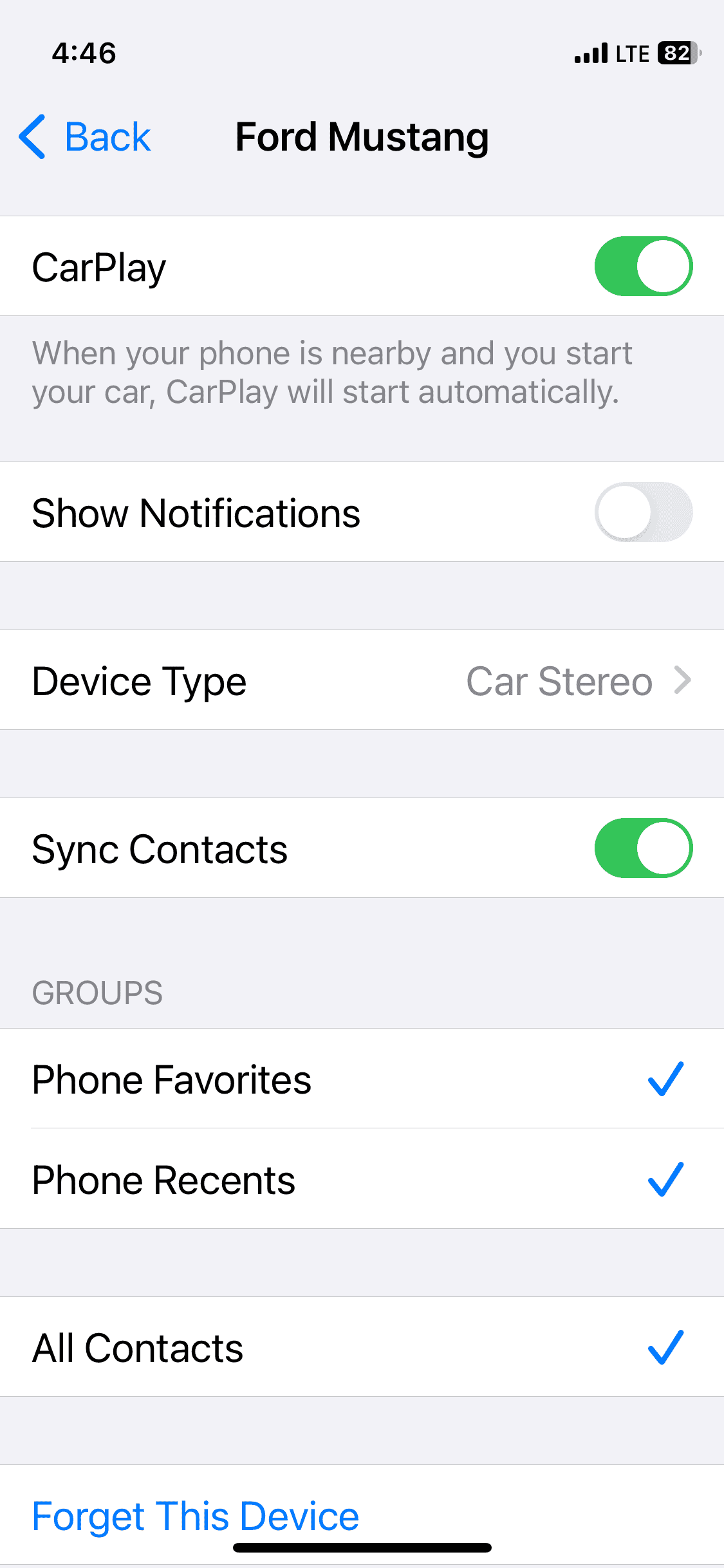

There was some kind of an update on the iPhone. I started having issues with no sound every other time I started my car. I changed the settings and now it’s much better. Basically the CarPlay is now wireless always.
in Bluetooth devices, select your mustang and make sure it’s “car stereo” as device type.
S650 Mustang Apple Carplay is horrendous IMG_6450
