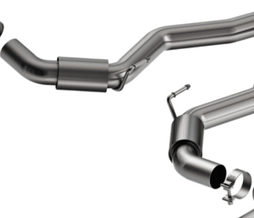

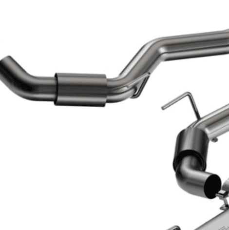

The DH valance is different because of the coolers and aero design, as well as the tip size. I'm not sure what the part number for it is, but I do recall there being a thread and a google sheet with the part numbers for the s650. The exhaust system itself is also different due to the orientation of the hangers I believe. If you look up the Borla system for the dark horse vs the GT, you can see the hangers right before the muffler are oriented differently. This could just be cosmetic, but I can't 100% confirm. I do know that a lot of GT catback exhausts do not fit on the Dark Horse. I've verified this directly by emailing many different exhaust companies and all of them saying that exact thing. Of course, if you can find an exhaust shop that will cut up some stuff and weld new hangers, it very well may work. But from what the companies have told me, the catbacks for the s650 GT do not fit on the s650 Dark horse. I am not sure about the opposite (Dark Horse catback on a GT), i assume it would work with the DH valance. First pic dark horse, second pic GT. Ford Performance Exhaust systems do come with the DH Valance, so might be worth checking those out

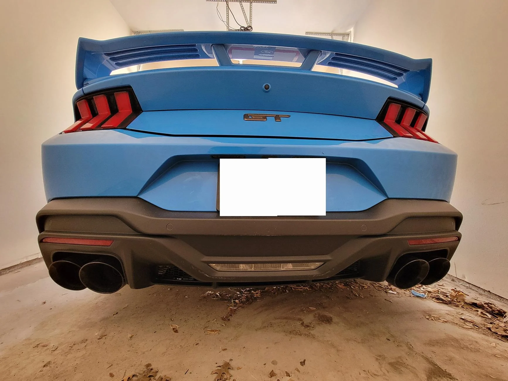

Non ave gt-quad= exhaust instalation and cutting the stock rear valence
Ave GT - DH= replace valence and exhaust.
All depends on what you want really.
For reference, Ford Performance kits offer the DH rear valence with the quad 5" tip kit
