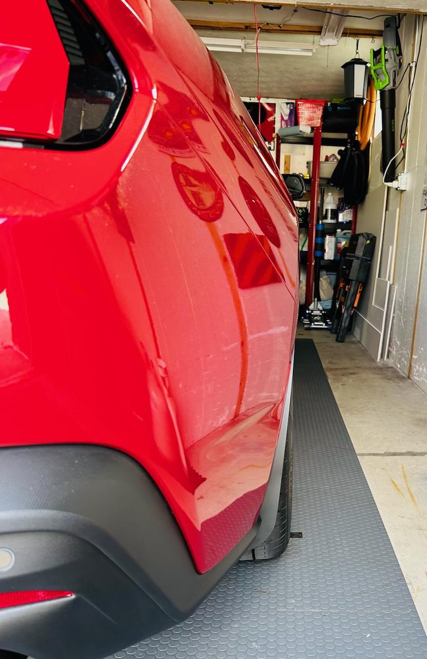

I have the Zl1 Rock guard on order as well no shipping date yet. I installed these to help protect the bumper sides until My rock guards come in.

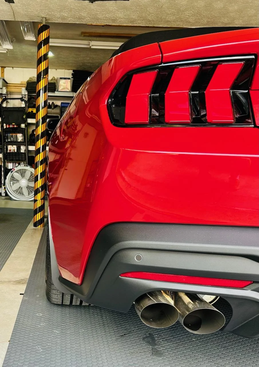

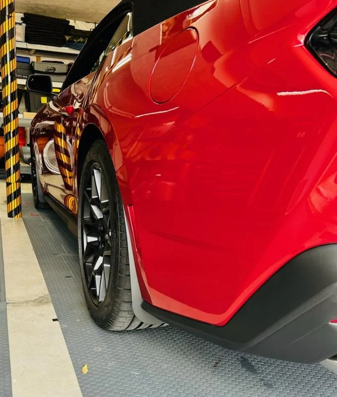

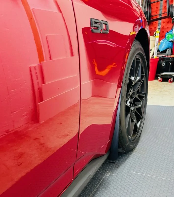

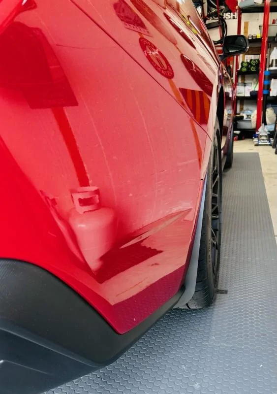

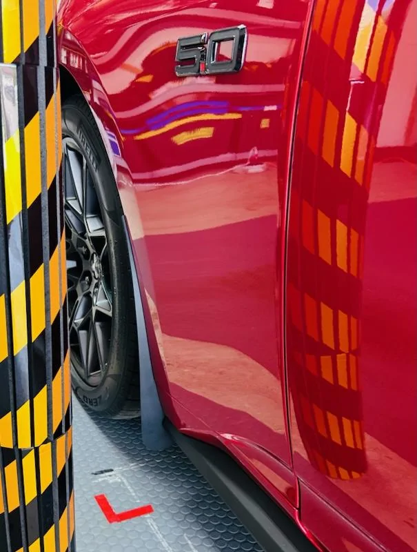

As requested. Outside of having to take wheels off, the rears were quite simple. Took my time, double checked the video on the first run, second was much quicker.

Thanks for the pics. Honestly they look pretty decent installed IMHO. Do you know if you go the regular one's or the deluxe one's which are more expensive on their website? Also do you feel they are pretty high quality and will actually provide a decent amount of protection?

I went with the Standard set, good quality, has good durability to them, I have no fears they'll work as expected. I see no value in going with Deluxe version.

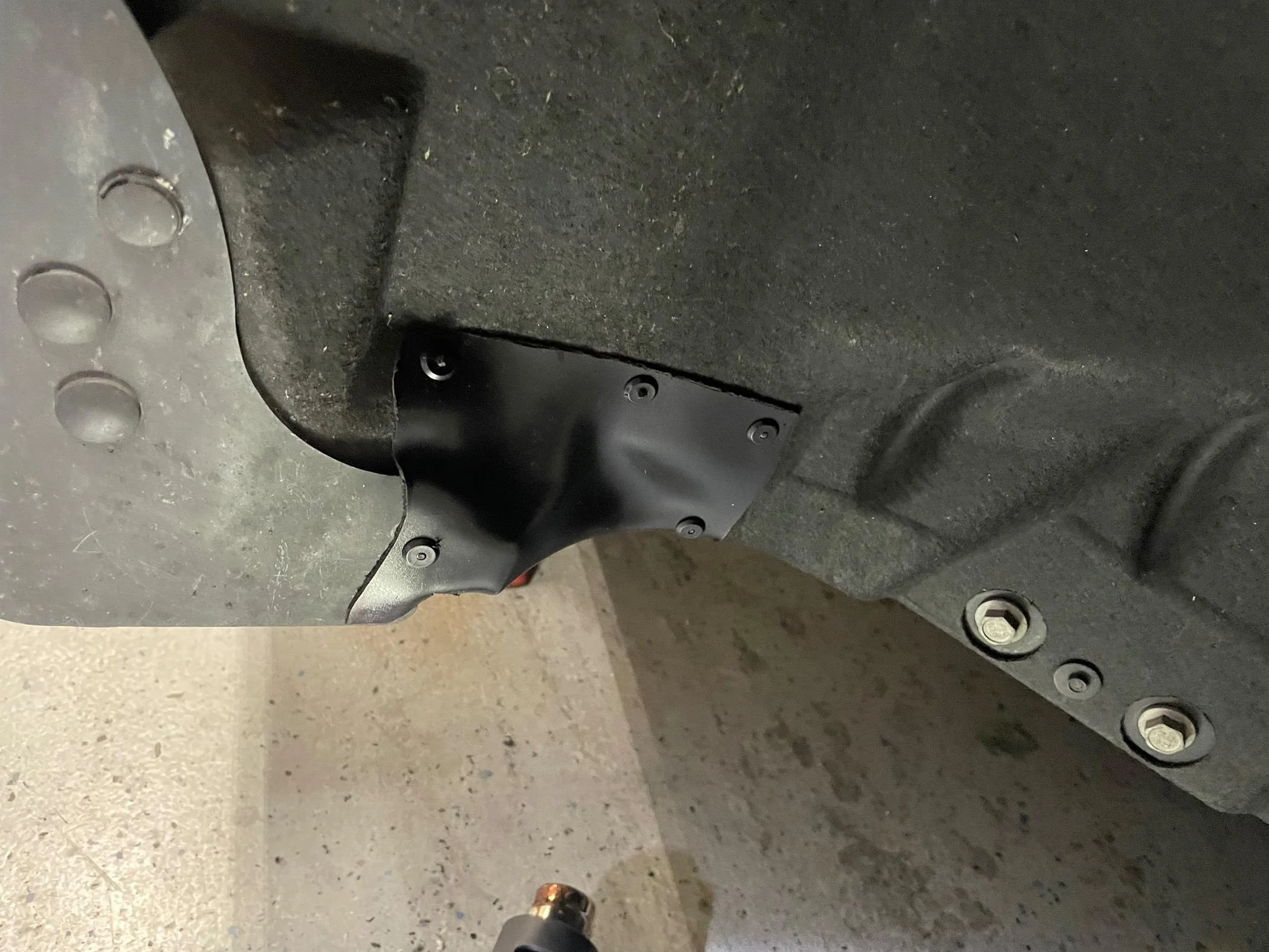

Will the Front Rock Guards cover up those gapping holes in the fender liner behind the front tires? Heard that a lot of sand, gravel, rocks, etc., get kicked up into there.

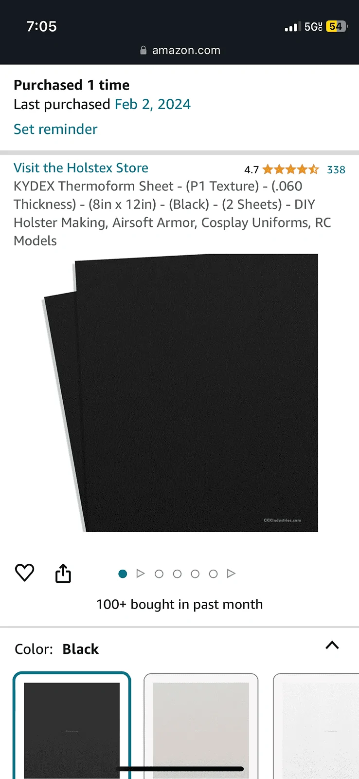

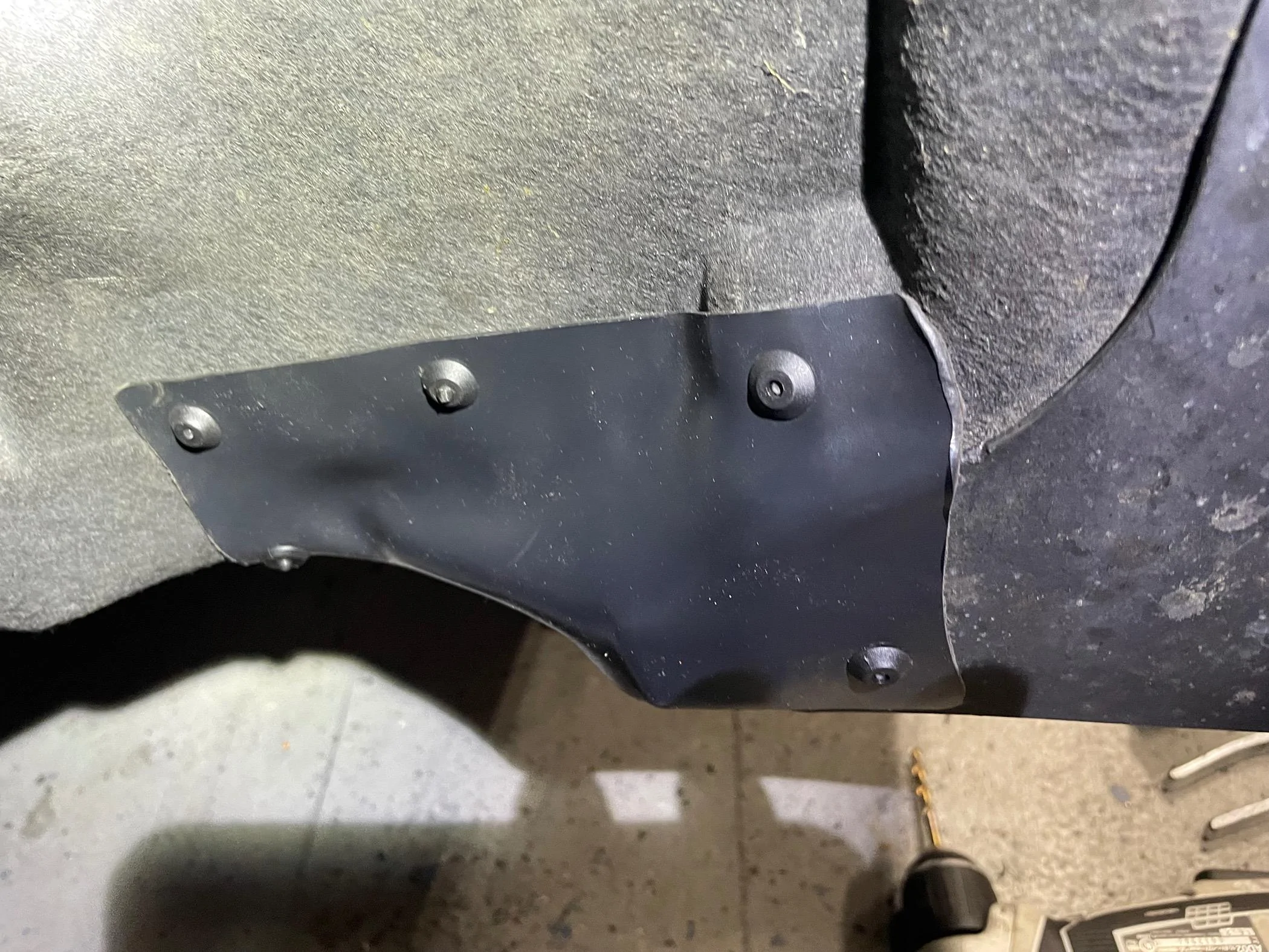

they don’t and it would look really weird if they did seeing as how that gap sits like 2” further back and 1” lower than the guard. But i paid less than $13 for the kydex and got the plastic rivet gun/rivets for like $10 at harbor freight. If you don’t have a heat gun you can get one for less than $20 there too. But took my time and bam.
