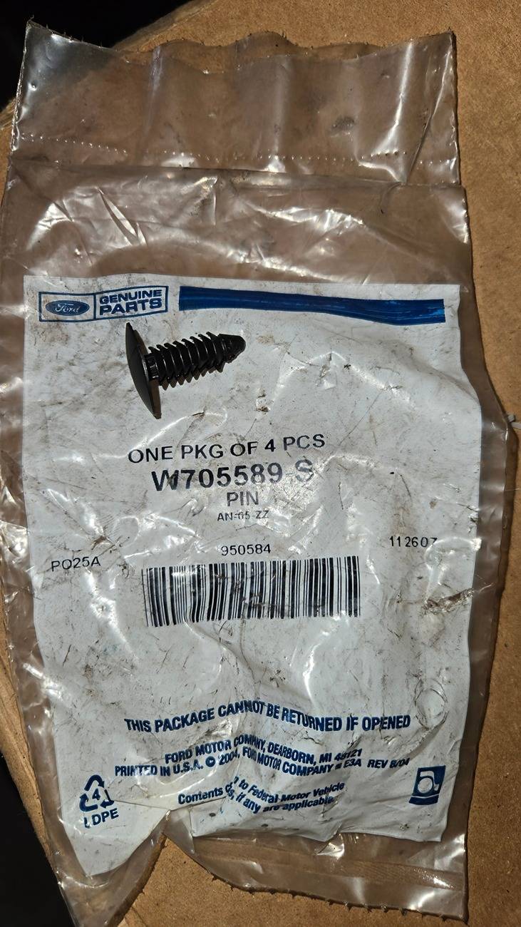

@LevittownFordParts So those are the parts that I got! Sadly, they don't clip in as smooth as I thought they would.
I hate to use that dreaded line, the one men fear, but "Is it in yet?". It didn't seem to SNAP into place and fit as snugly as I thought it would. We will see if they hold.
Each pack comes with 4 so I have 2 spare if they fall out.
I basically just pushed them in as hard as I dared.

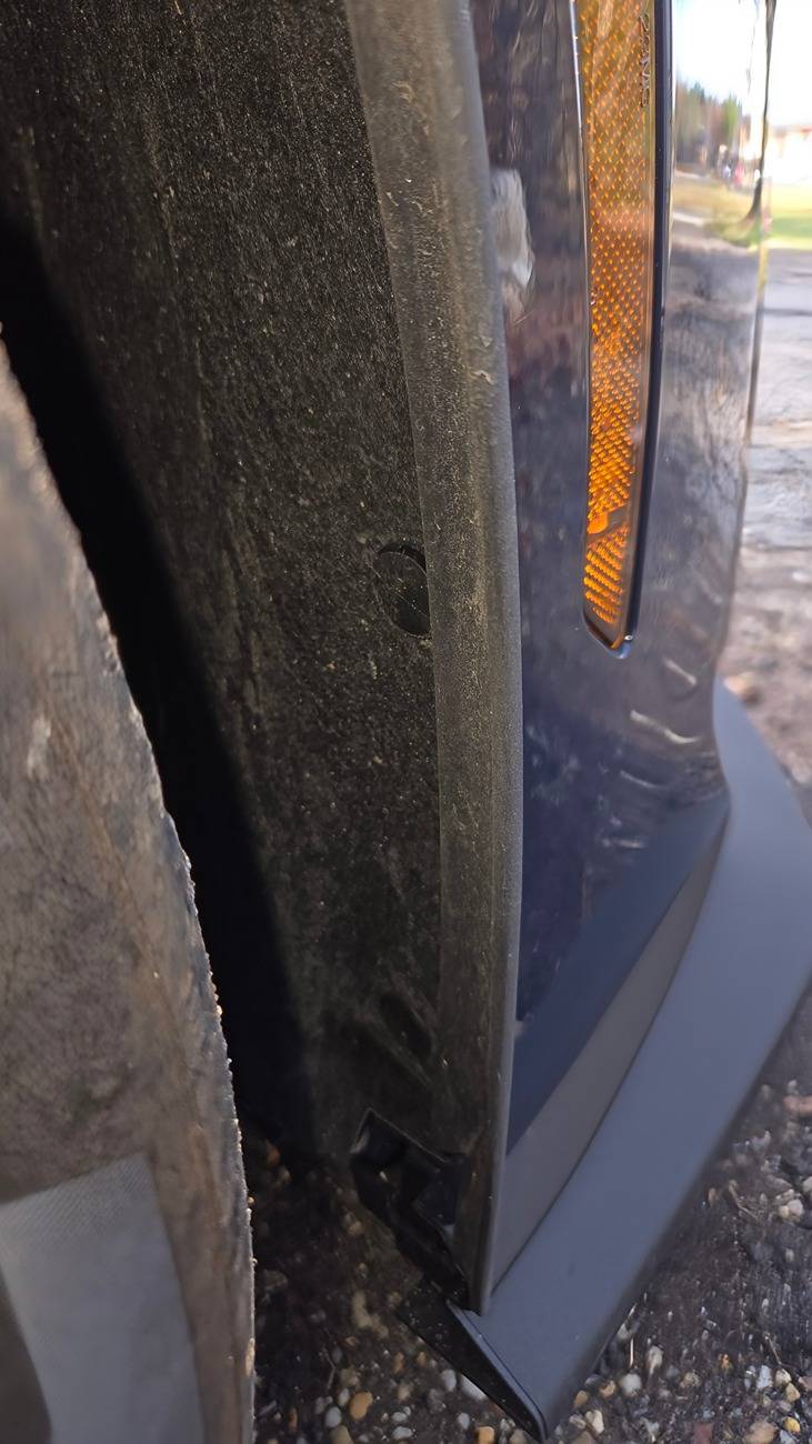

These are left over from my Ford mechanic days of working on the 6.0L. Also added a photo of how they should be installed. Specifically on the front side of the flare as the wind pressure will push the clips harder than they were intended to retain. Tucking them behind the inner fender they actually fit back there nicely and the clips hold them in place properly.

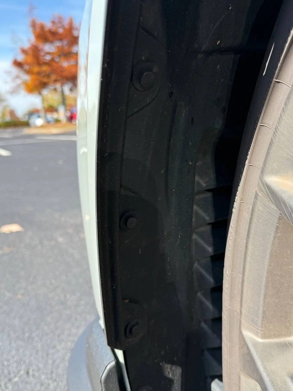

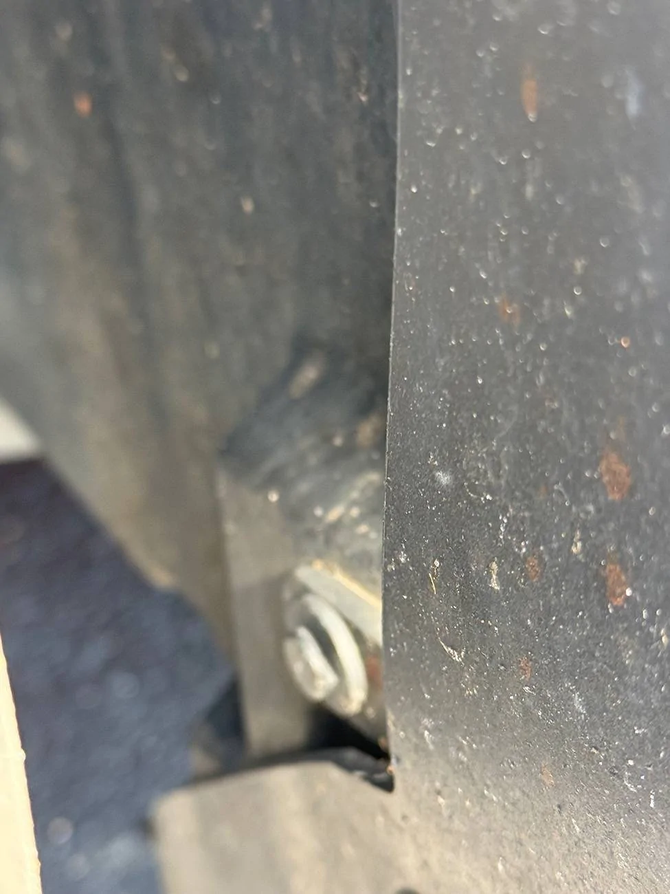

Here are the 2 back ones (this is a Mach 1)

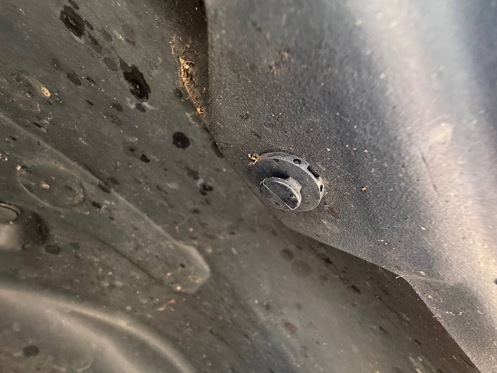

This is the 3 front ones, all 5 are on top of the fender liner on mine.

Yeah, if you pull those three on the front out and tuck them behind the inner fender, the clips will hold a lot better. I didn't mess with trying to get the ones in the back tucked under there because of the double sided tape the had on the back, but my right front flare kept popping clips out driving down the highway, presumably from the wind pushing on them. Once tucked back they have been holding as designed. There seems to be just the right cut on the inner fender to tuck them in there and everything lines up as it should when doing that. I haven't worked for FoMoCo for about 15 years now, but I can see how that was intended for them to be installed. Keep in mind it is usually a 17-20 year old doing the PDI on these things that is aspiring to be a tech.
