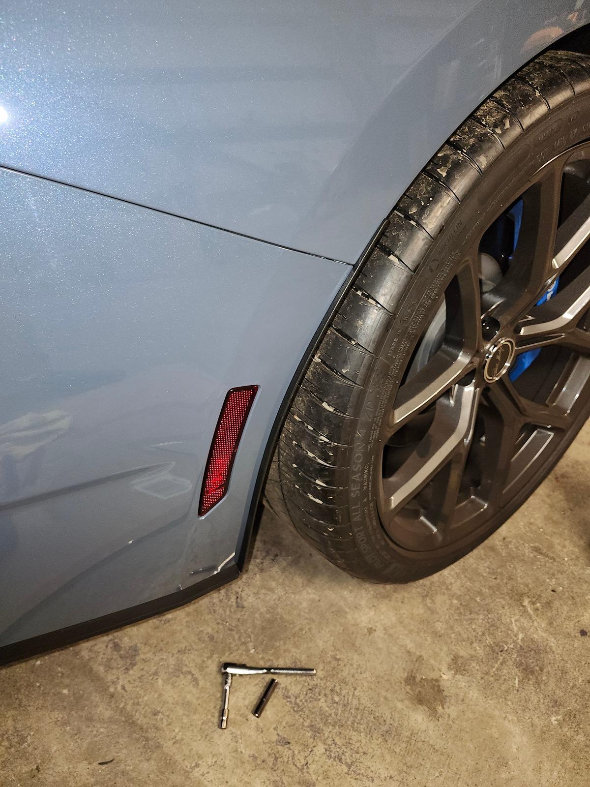

Just an FYI for others... they also fit the GT and Ecoboost. Did them on my Ecoboost a while back.

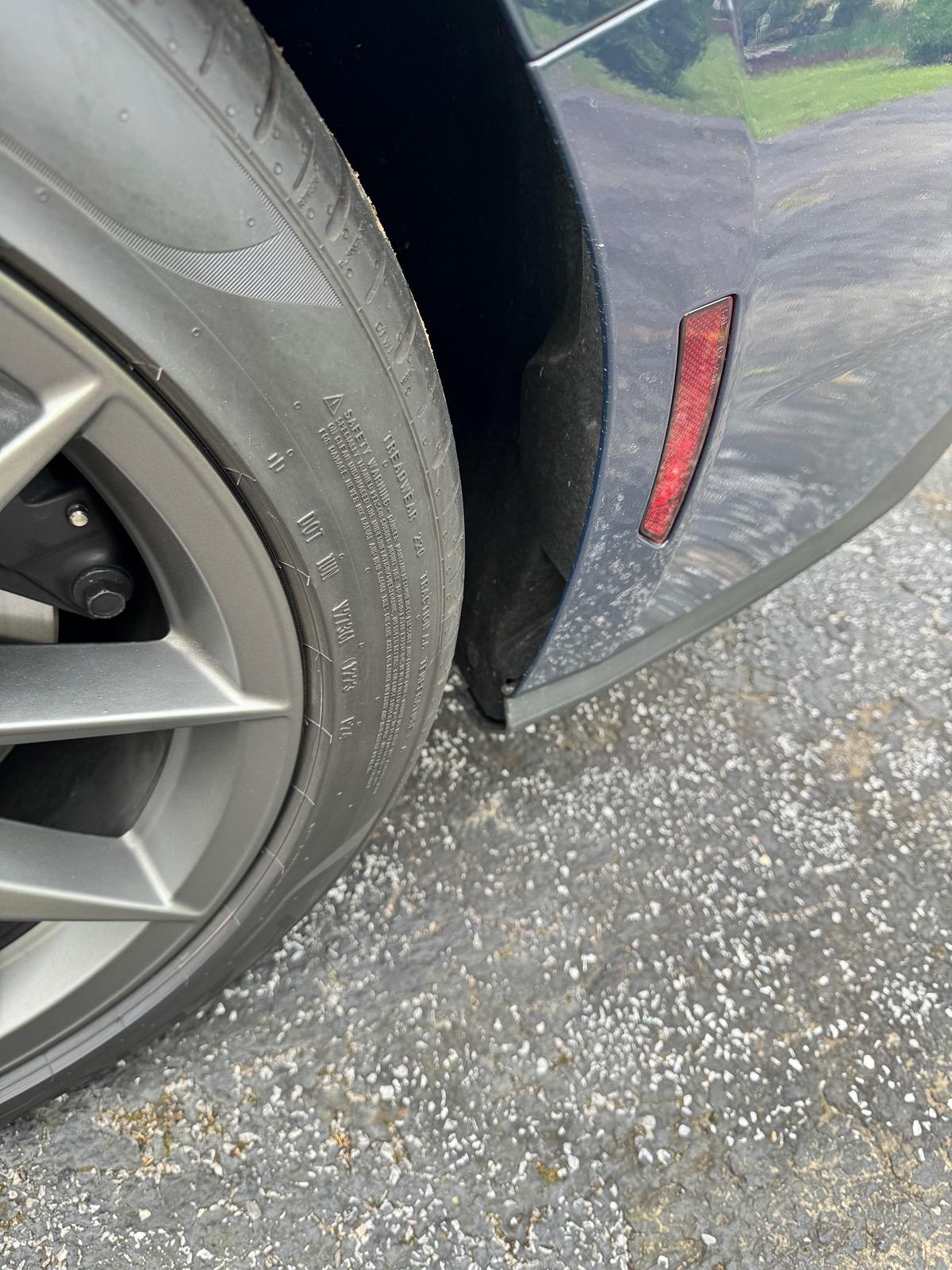

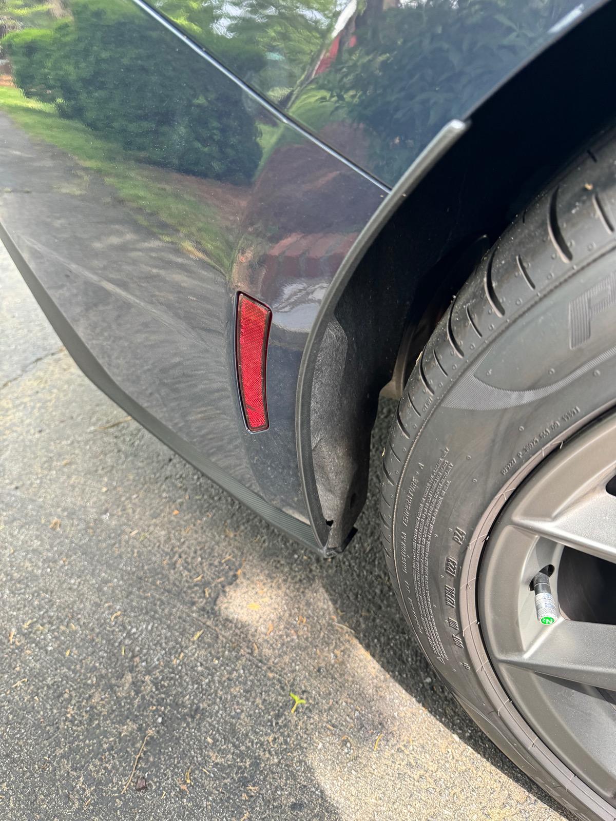

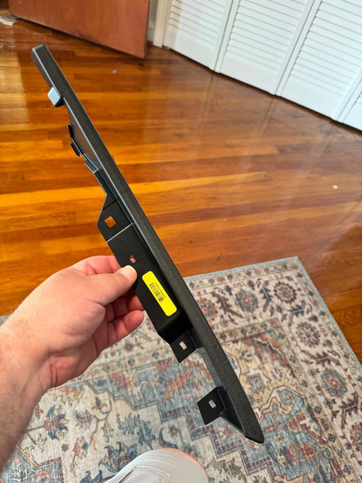

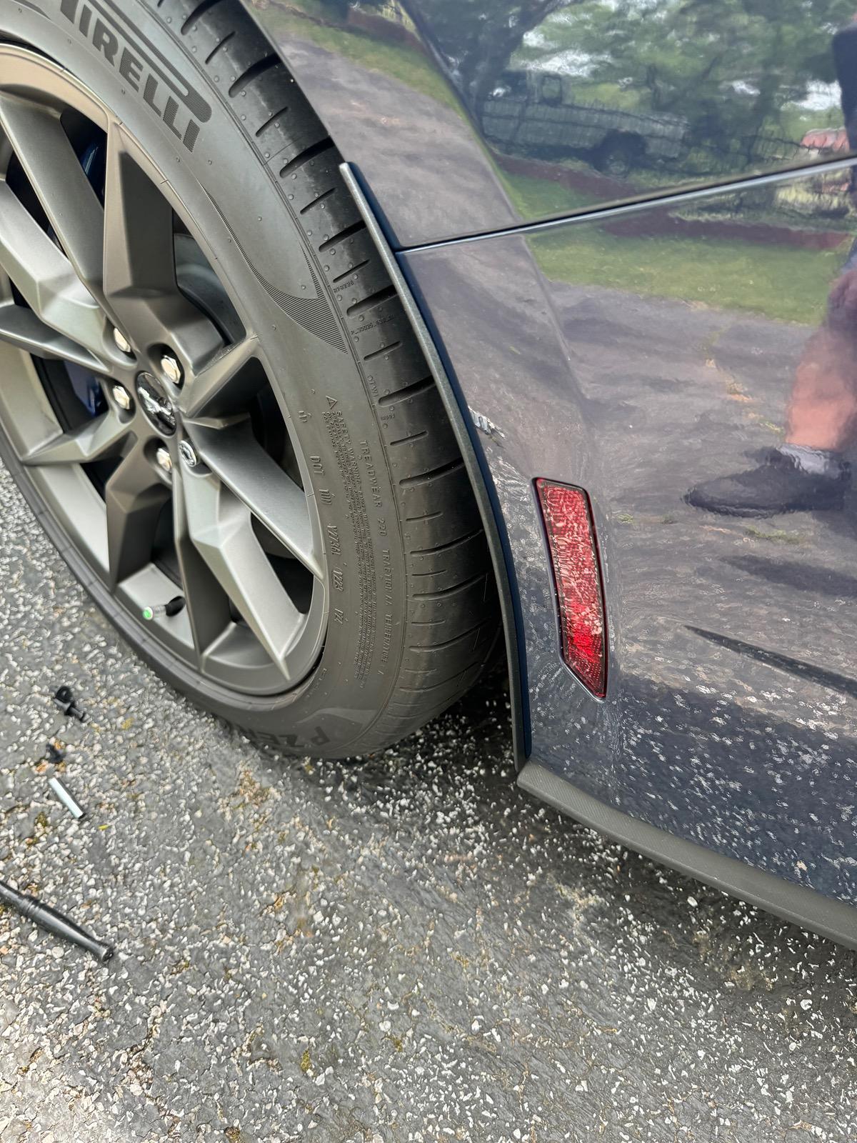

Here are some pics.
This is the driver side part.
Here is the drivers side without the splash guard.
here is the guard installed on both sides.
The only extra parts you need is a push pin for the upper holes on each guard. You reuse the screws that hold the splash shield and bumper.
