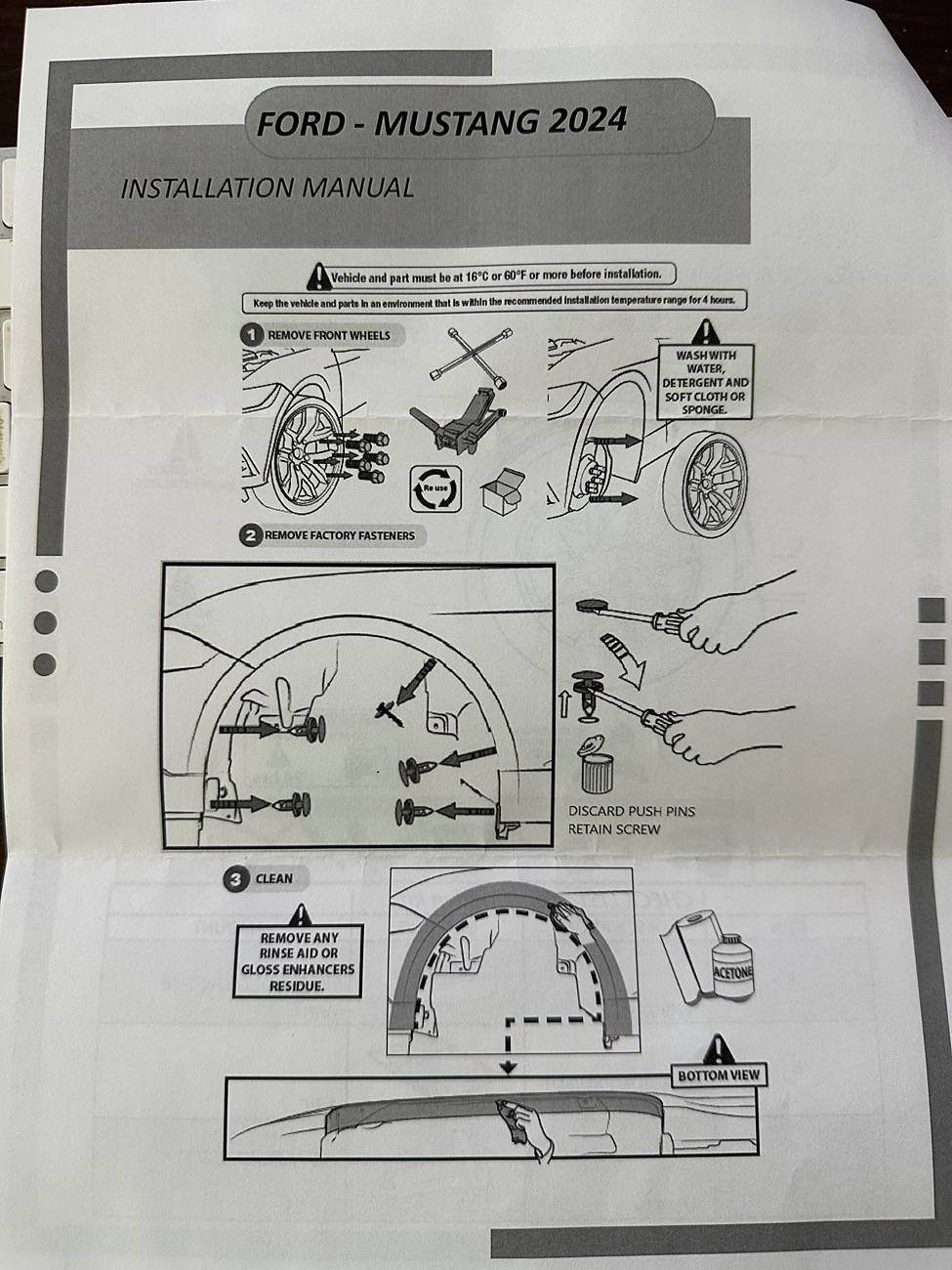

Did anyone get the box and keep their instructions for mounting the fender flares/wheel lips?
As some of you guys know; after the whipple install whatever double sided tape was basically wrecked when the front bumper came off and went back on. I went and bought replacement stuff.
3M Tape - 1/4" width
3M 4298UV Adhensive Promoter
12x Ford PINs (W713610-S300)
I'm either going to tackle it myself (if I can get instructions) or have a local Ford dealership take a crack at it. If that doesn't work they are coming off permanently. Tired of popping pins.

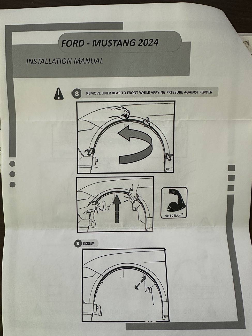

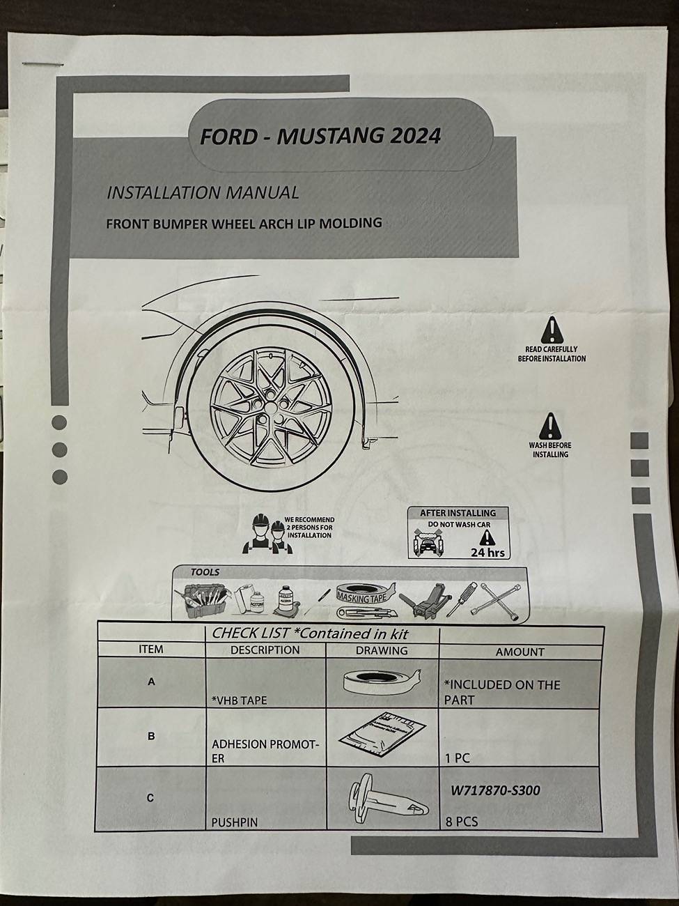

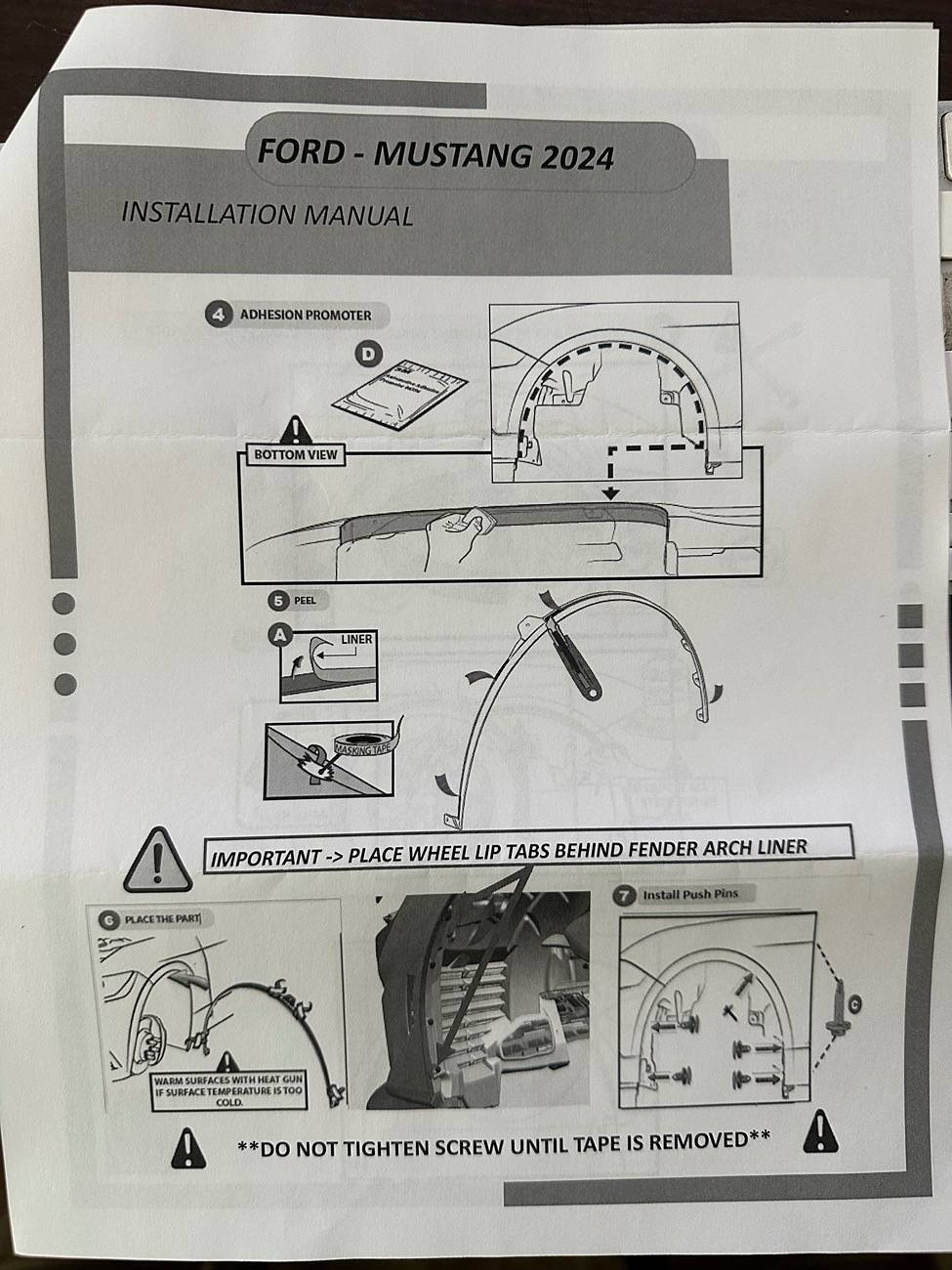

Thank you! A gentleman and a scholar. And maybe a hoarder too but you got them!!! Nice.
I see they show to put the tabs behind the carpet liner like another member here said! Guess they didn’t read instructions during PDI!!!

Do all the tabs go behind the fender liner? Or just the front one.

Can someone take pictures of a proper install. I got a feeling the dealership did mine wrong

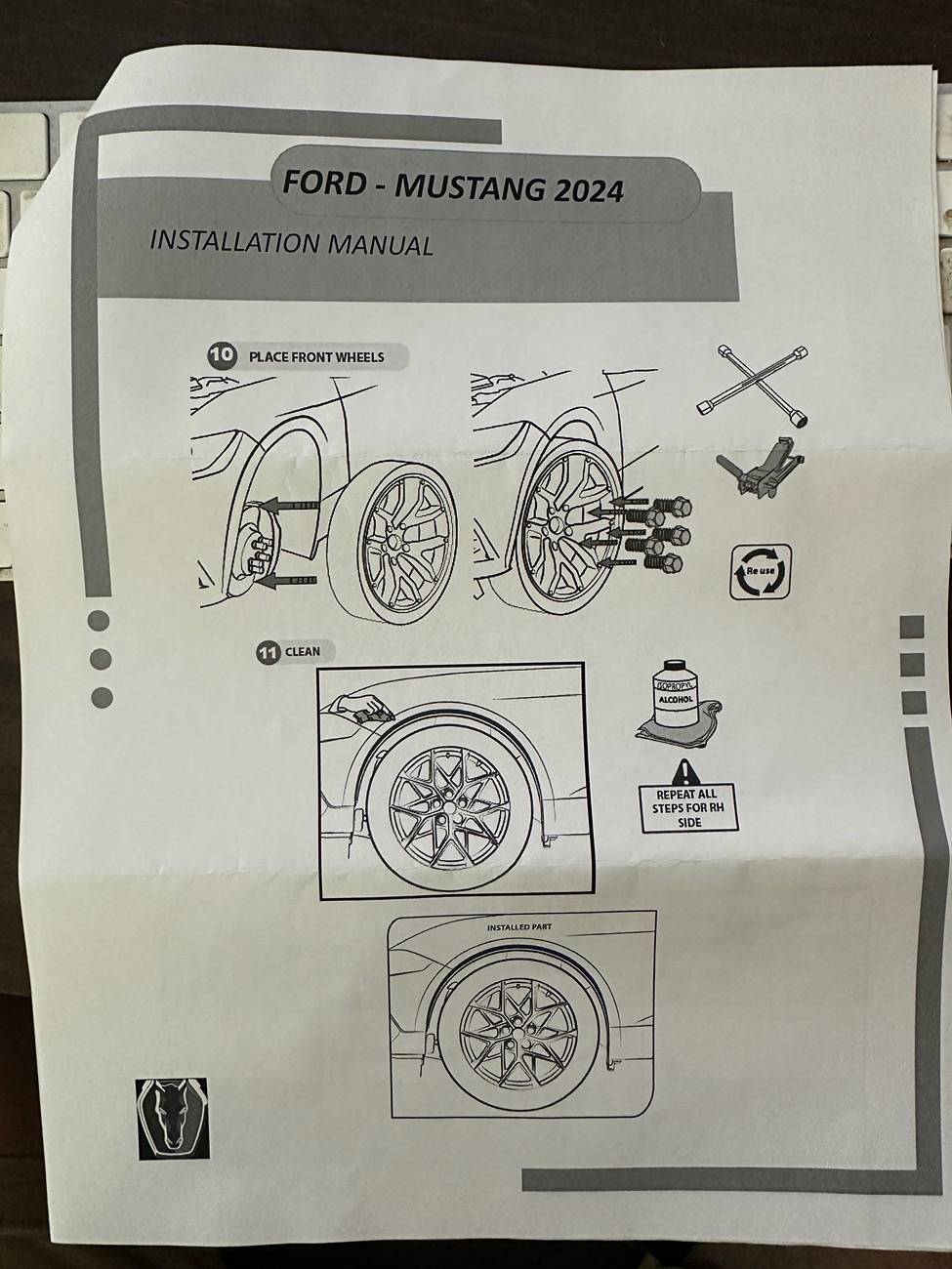

The tabs (pin mount holes) closest to the front of the lip molding should be installed BEHIND the carpet. The rest are installed on top of the carpet.
Sent you the PDF instruction set that I put together based on Smurfslayer's images.
