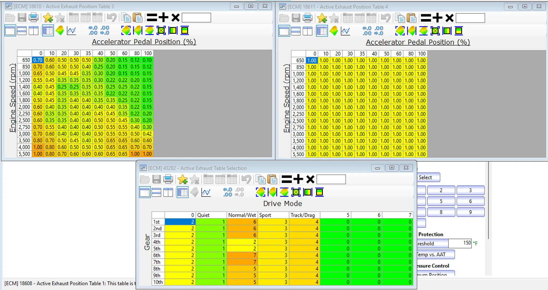

Fuck guys, let me just settle this right now. Yes track/drag mode exhaust is open 100% of the time. Pedal demand or RPM, it doesnt matter. Sport mode is not open all the time like track/drag. Time for the proof so we can put this shit to bed.
Here are the two tables and the table references so you can see. 1.00 means 100% open. Less than 1.00 means partially closed percentages.
S650 Mustang Active Exhaust/Track Mode Driving 1757466798963-8
Yes! Proper data. first two tables are intuitive and simple. But what the hell is that third table showing?
What the hell do you mean? Thats the reference for the modes for those two tables. Table 3 is the sport table on the left and table 4 is the track table on the right.
