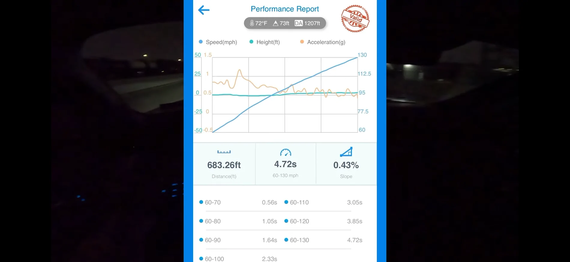

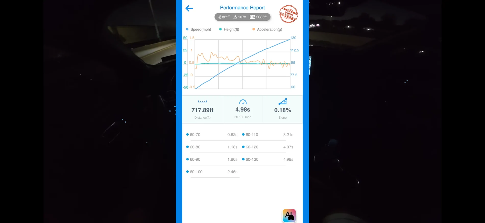

I’m saying that e50-60 is about all the octane you need to reach MBT for your engine in its current state. You can use the same spark at e50 that you’d use at e85 and the car isn’t going to pick up. Now there will be a slight cooling advantage with more E but we are taking about margin of error in terms of measured gains.
You won’t actually see knock retard on E85. The car will just make less power with the more spark you add past what the car already wanted. It’s not like pump gas where you add spark until you pick up knock and then dial it back 1 to 2°. Some people get in the trap, thinking that since they’re not seeing knocked that the car is making more power with the more timing they add, and that’s not true with the E85.
I retuned a car a few weeks ago that had 36° of timing being added on E85. The guy was mad. It wasn’t doing the 60 to 130 that he wanted or expected. I pulled it down to 30° and the car went almost a second faster.
