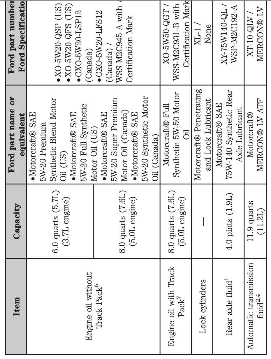

Remember the track pack etc cars said to use 5W50 in the owners manual. Even though the engine was 100% the same as the non track pack cars
Engines aren't designed for certain oils. An oil is specified for the engine. Which (in the USA owners manual) is 5W20, 5W30, or 5W50 depending on the year of the car and depending on if it will be used for 'track use'

I have the GT Performance Pack, and my car is now a dedicated track car. I run 5w-30 because I cannot find any definitive guidance that it is better to run 5w-50. I'm in the South and have tracked my car in near 100 degree heat. There are lots of guesses and assumptions, but nothing I can find from the manufacturer or those who have done any type of verifiable study. That's not to say 5w-50 is worse or better; I just simply haven't seen anything other than guesses.
Based on the fact that the owners manual specifies changing the differential oil every 500 miles for track use, but is silent as to using a different engine oil weight when tracking, I've decided to stick with the 5w-30, although I always run Motorcraft full synthetic. I change the oil after around 500 miles of track use.
