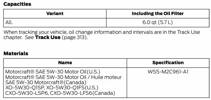

US and Canadian Mustangs are adviced to use WSS-M2C961-A specification, Motorcraft SAE 5W30.

Ford recommends Motorcraft, which works for me.
I guess you missed the point of this thread, unless you are from Europe.
You will loose your warranty in Europe if you don't use the motoroil they recommend. In this case it's the Castrol 0W30.
