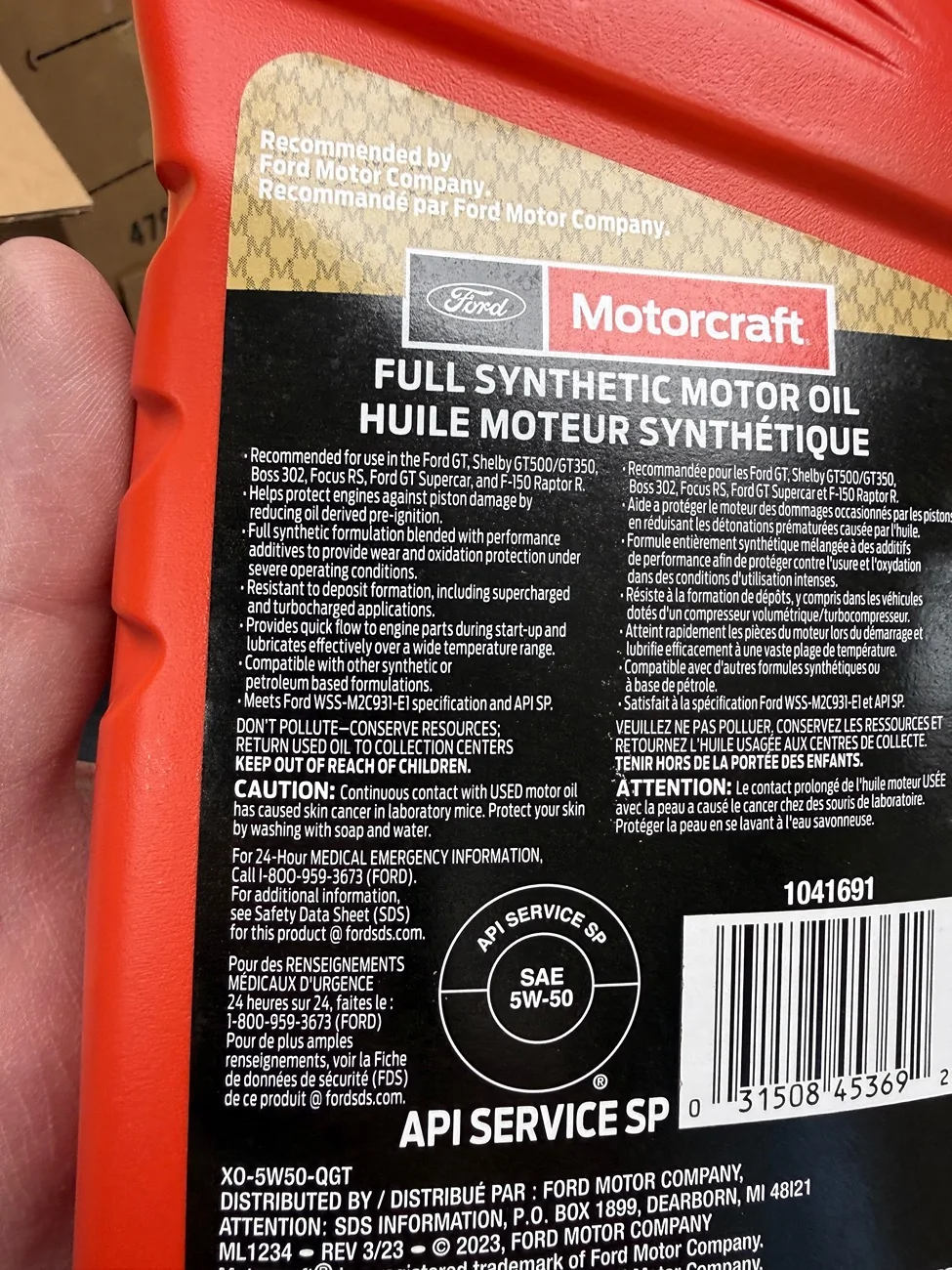

So I finally broke down and after much researching, ordered the Motorcraft 5w-50 Full Synthetic. I didn't find any definitive answer on the S650 and using 5w-50 on track, but for sustained high RPM driving at high temperatures, I just don't see where running 5w-50 would be worse than 5w-30. (My opinion) I did research multiple brands and wanted to be sure whatever oil would be at least the WSS-M2C931-C specification used for prior years and found that WSS-M2C931-E1 is the updated spec which supersedes the prior one.
The only oils I found with the new spec were 1. Castrol Edge 5w-50 S, which I can only find a PDF spec sheet on and cannot locate this oil on their website, and I cannot seem to locate anywhere to purchase it except a single website, or 2. Motorcraft 5w-50 (XO-5W50-QGT). Most everywhere you look to purchase the Motorcraft lists it as a WSS-M2C931-C API SN spec, but the Motorcraft Chemicals and Lubricants data sheet shows it as WSS-M2C931-E1 API SP. I ordered two cases from Rockauto.com, so hopefully the bottle lists the updated specs because the image on their website shows the old spec. I'm not too worried, because the same thing occurred when buying the Motorcraft 5w-30 oil, where the website showed an image of a bottle with the old spec, but what was actually delivered was the new spec. The old and new spec 5w-50 oil do appear to be slightly different as the data sheets list viscosity differences between the two.
Keep in mind, my car is a track only vehicle. If I were daily driving, I would probably stick with the 5W-30 even with an occasional track day. The 2023 and older vehicles which specified 5W-50 for track use said to replace with 5W-30 after track driving.
