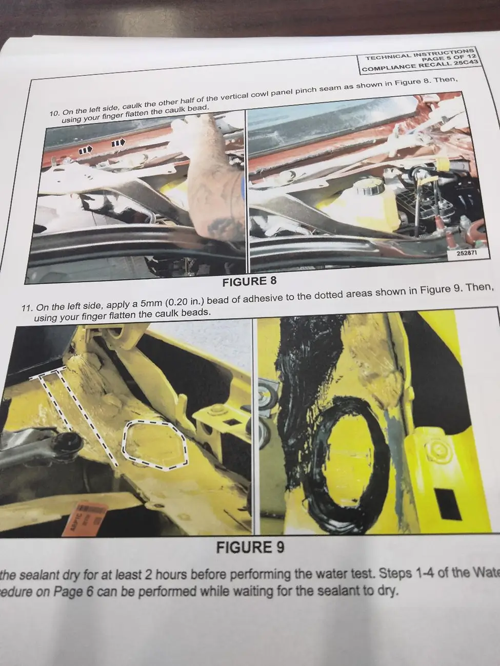

Thie recall dropped today, for most, it will involve an inspection and sealant application. For the picky and OCD among us (myself included) this is what its supposed to look like. Plus, we are to lift the right lower corner of the windshield to shoot sealer under it, opening up the possibility for the glass to break and have to be replaced. I'm going to pass on doing all this to my car for these reasons, and address the problem if it comes up. Recalls do not expire, if you had this issue years from now, it can still be repaired. The only way the dealer would keep the car is if the BCM corroded and it was not driveable (in which case it would be sitting here anyway), as the recall further states that it may be a few more months til the BCM's are available.

That sealant application in figure 9 looks like crap! I would not be happy with that!!

this makes perfect sense. My 2025 GT Premium has 3100 miles on it and is garage kept. I will not rush to have this performed. It is great for those waiting for stop sale vehicles.

Well now the shop foreman tells me that the specific sealer that is required has very limited availability. He scored 30 tubes and was told that it will be a while til there is more. We will be required to apply the sealer as seen above, and may even have to send pics back to verify we've done it. I've got hives just looking at that abortion.

That sealer looks like shit. No way am I'm bringing in my car so they can do that.
We just had a good rain storm and both my foot wells were completely dry.
